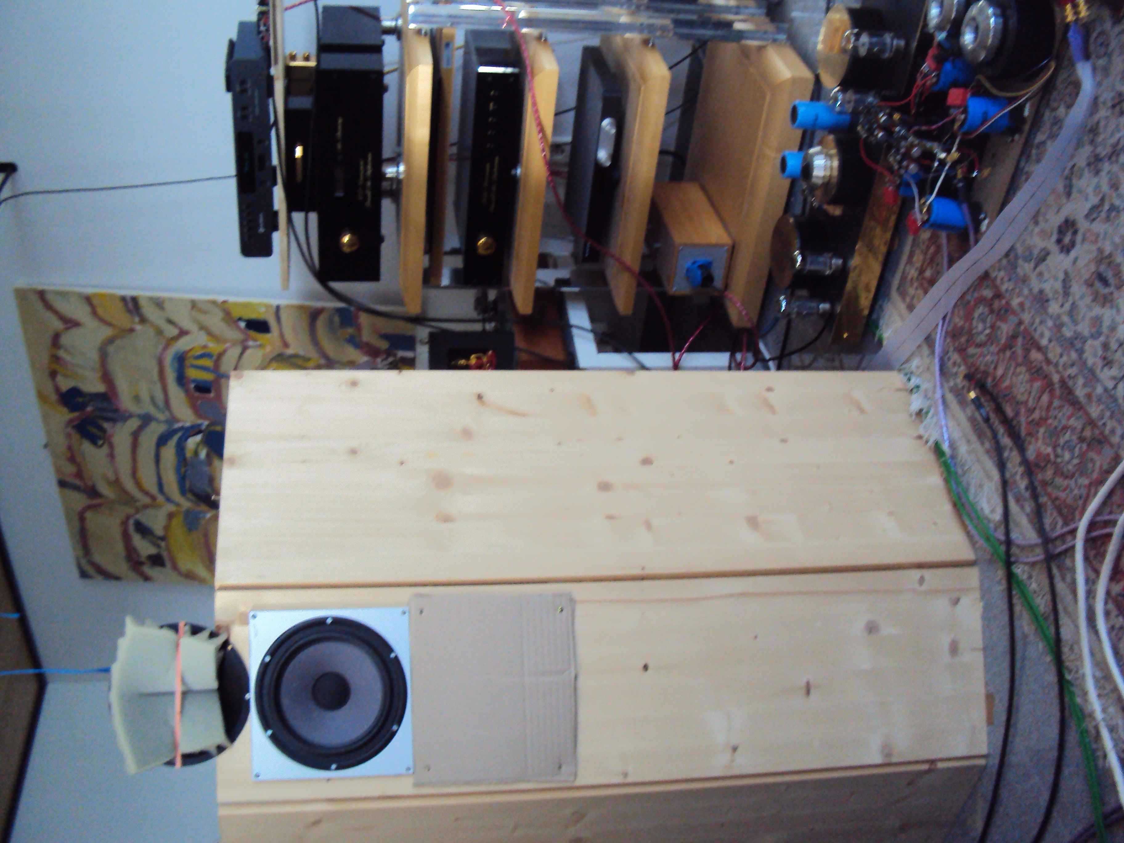

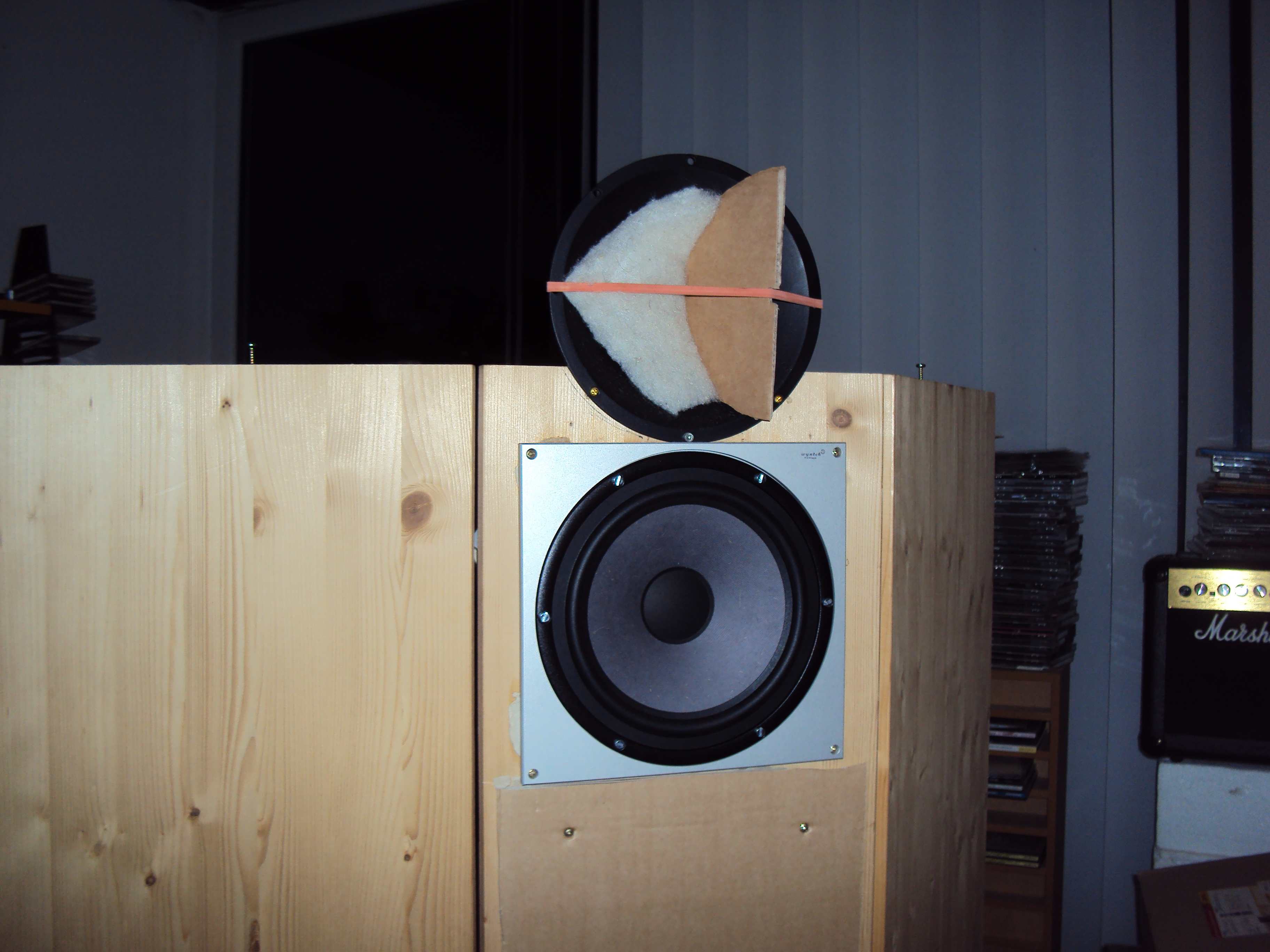

I have experimented with waveguides too and got very good results. The stronger amount of direct sound they produce makes the diffuse field tuning less critical. i build an open baffle with a 20cm wide range and a 25cm waveguide on top. I can not remember the crossover frequency but it was quite low, around 1.8kHz. Putting the diffuse field tweeter in the back made much less of an effect then in a wide range dipole.
That is this system.

In this system i use the Dayton 8" waveguide with Selenium 220TI compression driver.
All symmetric, round waveguides have HOM and with the damping the sound is super smooth. No honk at all. The mid-woofer is specially made for me by SEAS. It is based on the Prestige wide band with Reed cone but does not have a wizzer and other changes.
This is the lowest cost speaker that i would call High End. It served me so well that i had it in the system for over 6 month. Now i am back to the MPL slim with Enviee and Mundorf AMT.
It is just a refinement of post230. The SEAS mid bass now has a smaller magnet for a little bit higher Qts and i stuffed the waveguide with natural wool. I also added a separator in form of a half moon. That steers some more treble to the inside where i listen like a mirror reflexes light. The treble is now better resolved and not so dull any more. I think i overdid the damping of the tweeter a little with the foam-
