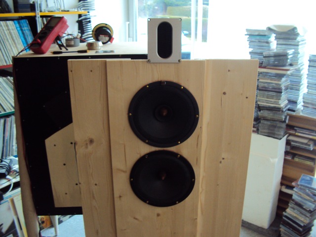

I have the cardiode woofers working with the 38cm Eminence woofers. After a lot of adjustments to my little Reckhorn crossover it sounds very good now. Maybe not as fast as my M-dipoles but with a very interesting rendering of the deep bass. The M - dipoles are very clean and tight and very even in tonality. The cardiode on the other hand definedly has a change in tonal colour when the tones get into the deepest octave. I do not know how to say it better but it sounds ripe and fruty there.

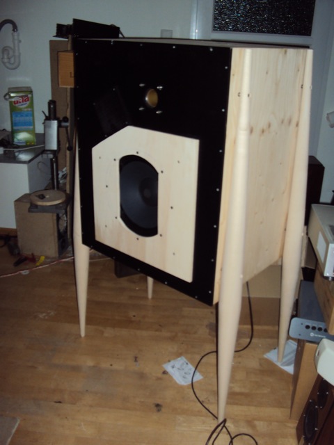

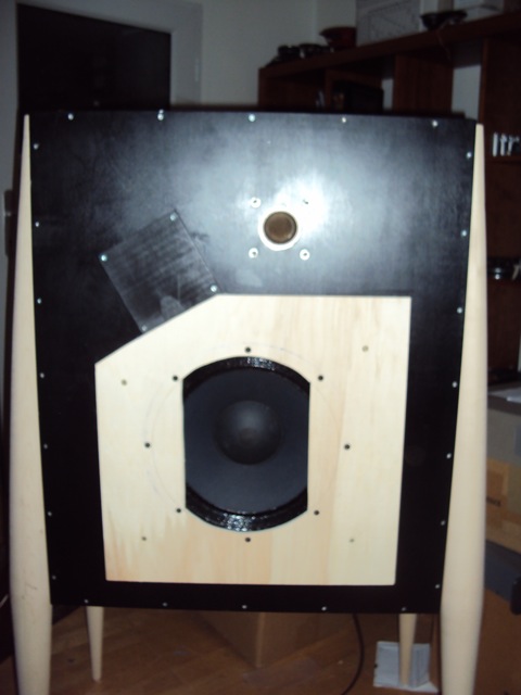

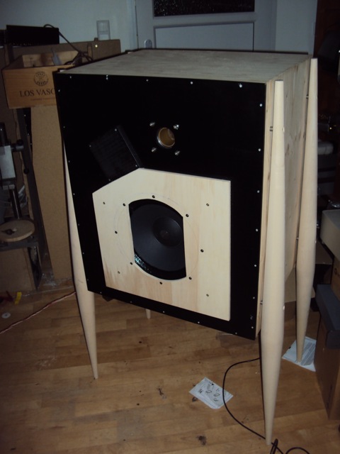

I am working with Wolf von Langa and Philipp Kemna on a field coil speakers. It has a double shell cabinet so the internal noise is isolated by 10mm of Air.

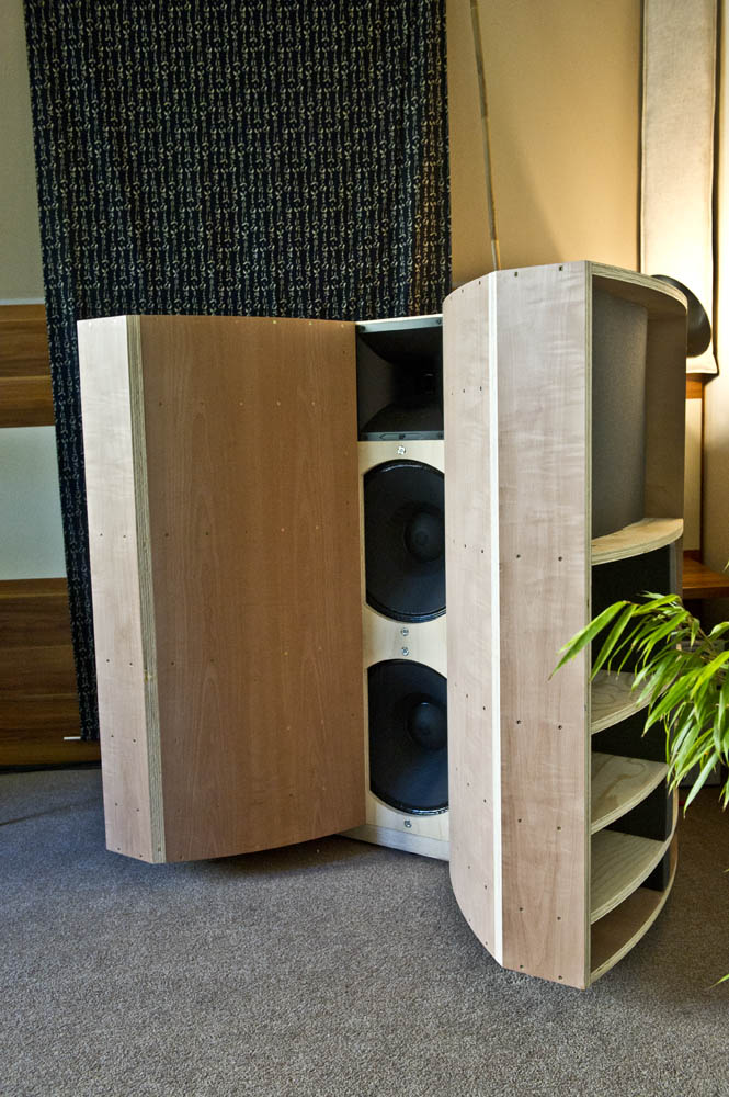

Wolfs Dipole Horn uses 2 x 38cm Fieldcoil woofers. One only works in the bass so compensates for the loss in bass from the open dipole. The treble is a 75mm beryllium dome in a compression driver with horn. Sorry, i can not disclose any more details about the crossover. I can only tell you that this was hard work to get playing. The sound now is the least coloured of any horn i heard and in a big enough room ( at least 40qm ) it sets up a decent soundstage, free from the speakers. The most attractive for me is the midrange. It has tremendous substance and resolution. The voices are just standing there in front of you.

Wolf von Langas patented Dipole Horn at AAA show in Krefeld. I designed the crossover.
Magnificient!
