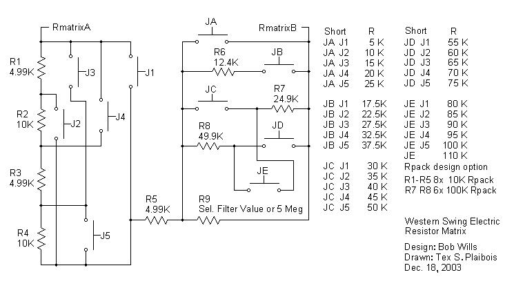

I looked a parallel resistor scheme. The problem it is not logical to program! There is a tremendous ease in use when you move a jump one to the right to increase frequency and one to the left to decease frequency.
However............ I did come up with a matrix that has more steps, less resistors, and a constant increment of 5K ohms per setting (jumper JB allows 2.5K increments that over lap a large part of the JA and JC range). For the 5K increments, only one jumper at a time is moved except when crossing the 25K/35K, 50K/55K, or 75K/80K step, which requires two jumpers to change. There is also no way to wire a short with the wrong jumper setting. There is only one jumper per 5 row section, R9 is to provide a DC path in case all JA to JE jumpers are pulled or to mount pot or audiophile resistor (if a final resistor value is chosen). The 5 row jumper sections also make it easy to see the position of the jumper. Having jumpered computer boards with 8 and more rows of jumpers I have bad memories of sticking the jumper on the wrong pin, after running out of fingers on my free hand to count with. Whatever jumper scheme you use lay all of them out with the same orientation and preferable left to right with increasing frequency increments! I have posted it before but here it is again:
Adjustment of freq

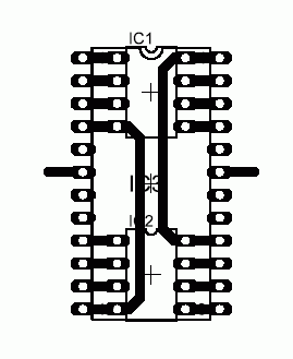

All the information on filter Qs and equal value Sallen Key topology has been discussed in a few threads on the forum. When every one gets done running in circles I would suggest someone design a modular system built around a second order HP and LP filter section with a follower input to isolate the filter response from a level control. Design it for an 8 pin dip and make a discrete op amp module with an 8 pin DIP mounting legs (and a ground terminal to carry ground to the discrete op amp board). I would do SMT op amps with a DIP adapter and I seem to remember some that were quite reasonable in price (Brown Dog?). A buffered op amp could be built on a similar modular PCB. Leave about 4 square inches around the DIP connector on the main board for clearance.

You can always solder the machine pins from the adaptor to the board

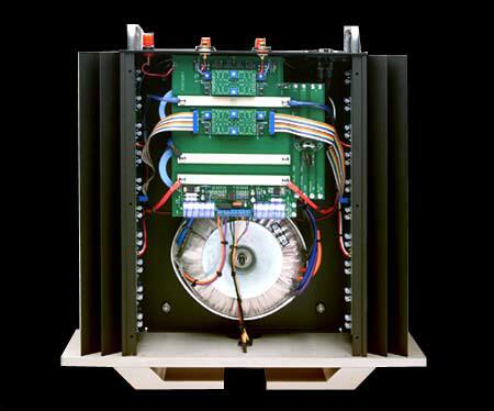

Gold pin headers and machine sockets sound pretty decent ........ be sides how am I going to sell everyone a new amp module every 6 months. I think some of front ends of Mr. Pass X amps are modular.
