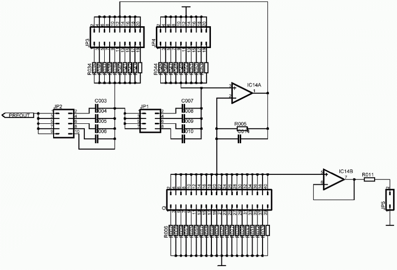

Just a note about the filter and changing Q
You problably all know this, but be sure to have a gain adjustment on the output of the filter section.
When you change the Q of a sallen and key filter by means of the qain, you also change the pass band gain.
So of gain is = 2 you must have a gain of 0.5 on the output to ensure that the following stages are not clipping.
\Jens
\Jens

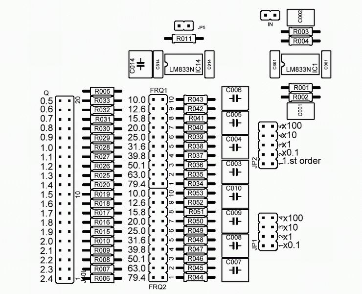

I'll do it. I'm starting on the schmatics for one block today. when done ill post the result.
Please comment if the schematics posted already are like you want them, or if they schould be changed in any way.
Also, ill do the layout using dual opamps, so if you want a descrete opamp make a dual one that can fit in a 8 pin DIL socket.
\Jens
\Jens

I feel that a Q of 1 is a bit too littel, so how about making the option og Q go from 0.5 to 2.0 in steps of 0.1?
The reason is that this gives the option of using the HP section as a low frew EQ for a sub or small speaker system.
I do not think that descrete opamps bettet are than some of the IC's you can get, if they were, opamp designers would have made them into a commeciel product many years ago.
\Jens
\Jens

In my opinion the use of discrete or integrated opamps has to be left to the final user, so the PCBs should be made in order to accept both.
Moamps' approach required a DIL-to-SIL adapter for the integrated opamps, if we want to avoid it a DIP socket could be placed on the "main" PCB leaving the space to mount a discrete OPAMP with a matching pinout in piggy-back.
I slightly favour the SIL approach, since it seems to simplify the overall layout.
Cheers
Andrea
Cheers
Andrea

The Global EQ sections are there in case you do not have enough in one of the 4 channels.
I'm working on an adjustble EQ section.
\Jens
\Jens
Resistors and caps
I don't think there is room for more resistors.
why do you want to parallel them?
I hope the room for both HP and LP one one board
\Jens
\Jens
