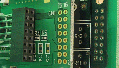

I think that the existing design is great as it is. If it is to be controlled via relays, an expansion board could be created that simple plugs into the header pins where the jumpers go. This way, you could just stack the boards up, putting the microcontroller/relay board on top of the existing board, and if you want to do it manually, just don't use the relay board. I was thinking about doing this, as it would be quite flexable. But my idea was to use cmos switches instead of relays, since they are smaller, and analog devices makes some ones made for audio. This would also keep the same footprint.
just an idea... realistically, I wouldn't change my settings much, but during the prototyping process, you could set various settings on the jumpers with the microcontroller, and save them, allowing you to jump back and forth between different slope filters to see what sounds best.
This would be a fun product for prototyping, then once you settle on the settings that you like, you could unplug it and use normal jumpers to simplify the signal path.
Brian
Here are the connectors that I am referring to. They can be made taller, so that you have the clearance for the components on the lower board.
Brian

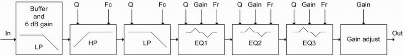

An idea
Hi great work with the filter,
My idea is to make one PCB with a BP filter and some EQ sections. The band pass filter has selecteble fc and Q.
The EQ sections can be boost or cut, and can have different Q fres and gain.
For a two way filter use two modules, and so on.
Tell me what you think
Like this:
