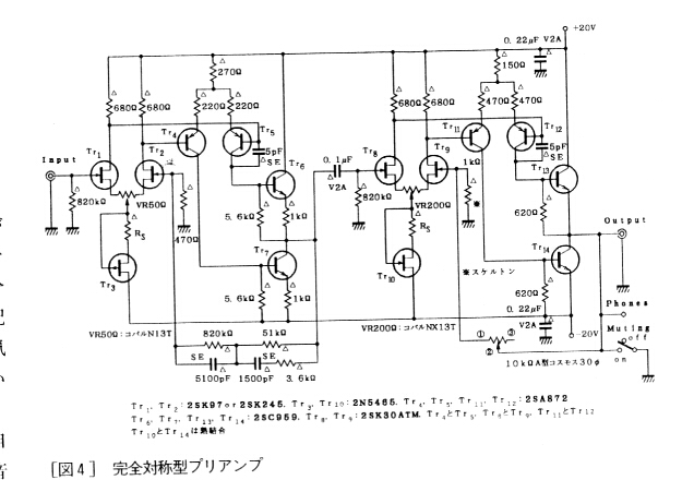

Stefanoo,
my pleasure.
IRF610 and IRF9610 are badly matched, IRF9610 has different, poorer characteristics, even IRF610 is significantly nonlinear.
Biasing this way, the unstable Vgs is excluded and lower Vref used.
Good luck in your efforts.
my pleasure.

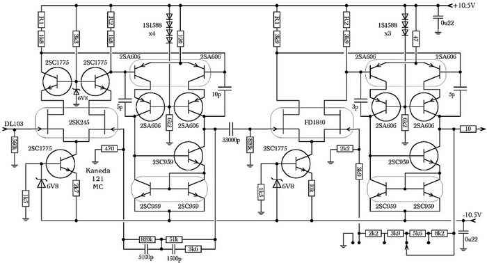

Analog,
thank you.
This is helpful.
My configuration is different although i use a balance VAS like this.
Plus, my MC stage is made with cascode common source Jfets.
I can see on this circuit that there is a split RIAA as well.
The circuit is made of two identical blocks.
Lets just analyze the first one:
First stage is a differential amplifier cascoded with a passive load (i am wondering if an active load would work on that position but as paul hypotized active mirror load works for SE config).
Second stage the Balance VAS stage, cascoded(bootstrapped?!..man i still don't catch the bootstrap config), no current mirror.
Anyways on the VAS stage: is the output (2SC959) a simple common emitter follower config (?!) with low output impedance, is it right?
I mean on my configuration i had the cascoded mirror with current source active load and a resistor to bias the push-pull class A output stage.
interesting thing is that compensation capacitors are asymmetrical and are way ower than the usual standard 100pF used on the SE Vas version, which it is great, which means faster response and less load on the front end for the charging and unchargin compensation cap's job.
I have noticed the power supply is to low voltage value, why?
I mean...i have noticed that my circuit started to oscillate if the voltage was increased....but i didn't have compensation caps.
The VDs of the devices is properly set at around 7V.
No output coupling CAP need nor compensation DC cap on the negative feedback to latch unity DC gain, since the monolithics and the bla config contribuites to a very low DC drifting.
It's a good circuit.
I just don't like the output stage though.

Hi Stefano, I built a 250W mosfet amplifier with a differential VAS like this over 20 years ago, so I don't need to build another to prove it works! When I say the circuit is not special, I mean that the basic architecture is well established. John Linsley Hood covers VAS balanced architectures in his Valve and Transistor amplifiers book, and shows how to progressively inprove their performance.Stefanoo said:
Hi paul,
When you meant to say that the circuit is nothing special, you meant to say that there are better topologies that can be used? if so, would you like to give any suggestion?
any advice is of course very welcome.

Not sure what the exact background is but looking at the 560k input resistor i would assume this circuit works with a step-up transformer. Never claimed it was excellent for noise or in any other respect.

Stefanoo said:
NP schematics are very nice.
The only phono stage he has it's the ONO.
It's not a low feedback design.
A lot of Pearl builders will argue with this.
No.
Your analysis is not correct.
A similar circuit without cascoding
what does TR7 on the first half of the circuit (same thing on the second half)?
It seems it bias the output emmiter follower, but it doesn't look like a current source as the current varies proportionally with the input signal.
