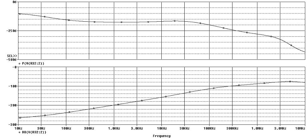

I have broken the loop as you suggested (i took the MC part off as i am evaluating only the stability for the 3 stage design and took the capacitors responsable for the RIAA C66/C18 off of the scene for now).
I have put an AC source at the gate of J1A and at the gate of J1B as well.
Put a dB probe and a phase probe on the broken loop on R32 and this is the result.
The graph on top is the phase the other is the module.
Is this what you meant so say on your previous post?

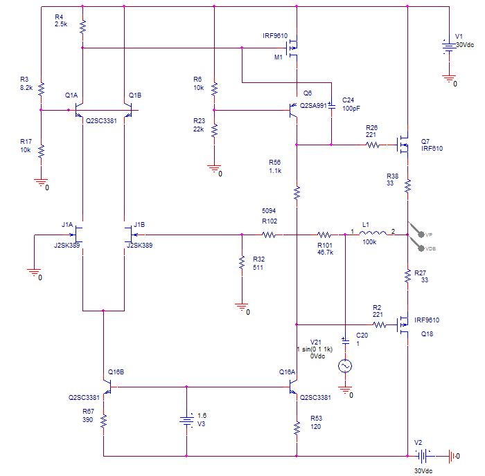

I am making more measurement on the circuit (i will attach the schematic).
For this test i took off the capacitors that are responsable for the RIAA equalization
Probing across R4 shows that when Q3 turns on the input stage starts to be loaded and there is distortion.
Might this be due to the input capacitance of Q3 (IRF9610) that loads the cascoded negative output of the 2SK389?
Is there any suggestion to solve this problem?

Stefanoo, good progress being made. You only need to connect the Pspice generator to J1B gate. J1A input should be grounded by connecting the input to 0V. The dB plot should start off high and decrease with frequency, and should eventually cross 0dB.
You currently have no real control of open loop gain in your circuit, and so you do have a high overall feedback design like Mr. Self's! The addition of one resistor could solve this (clue - one end connects to Q6 collector).
R4 will not directly trim DC offset, but I want you to figure out why.
R56 needs to be bypassed with a capacitor - why is this?

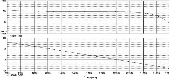

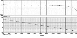

Thus, I followed the indications written there to evaluate loop gain and phase and the schematic is the following:
thank you very much for your appreciation.
I will reply to you once upon a time.
First let me start with the loop gain and phase.
Reading through some posts.....bannngg.... i found this one that helped i think (link is this one below)
http://www.diyaudio.com/forums/showthread.php?postid=1710530#post1710530
...and the simulation result.
Speaking now of:
1) R4: it zeroes out the DC.
On the prototype i have built if i adjust the value, DC at the output changes.
The current mirror Q16A fixes Bias current for the VAS stage and along with R56 the the bias for the output stage as well.
Lets pretend everything is perfect and there are 0V at the output.
Now, if i adjust R4, the current flowing on M1 has to be the same.
So the differential will start unbalance the current on the two halves till this condition is restored.
More or less current will flow at the output devices Q7 and output will float.
This mechanism apparently works but if you say so there must be something i don't catch: any help 🙂 ?
2) bypassing R56 should make bias more stable and DC drifting would reduce i guess, is it correct?
3)Speaking of o/l gain.
In order to lower the o/l gain i can lower the gm of the differential stage by lowering the current on the tail, right?
But is well known that jfets sound much nicer at higher Id.
I would like to find a method to measure the open loop gain and thus evaluate how much feedback is injected on the circuit.
Self briefly shows a method on page 70 but it don't completely understand it.
It takes the negative and positive input of the differential input pair, buffers them and measures the output divided the differential input at different frequencies.
But it does this with the Feedback network connected!
Thus...is this is a closed loop gain or the open?...i don't understand.

Would this a better solution anyways?
Edit:
You said it is possible take control over the open loop gain by adding a resistor at Q6's collector, but i don't understand this thing.
May you explain this a little more?
Speaking now of:
4) Still on the Self's book, he shows that instead of having the resistor loading the diff pair, a current mirror version has supposedly a way lower HF distortion BUT increases the O/L gain...which i guess it is bad.
Edit:

..... The addition of one resistor could solve this (clue - one end connects to Q6 collector).
you meant to add an high value resistor, something like 220K on the local feedback network of the VAS stage, right?
This could lower the global feedback of 20dB.
While the method is correct, something is still not right in the results you got.
- V21 should be VAC rather than VSIN (as it is currently, in your schematic). Set the VAC amplitude to 1V
- Set C24 to a very small value and redo the plot as an AC simulation from 1Hz to 10MHz.
This would be a good starting point. Then increase C24 starting with 10pF in 10pF increments until you get a phase margin of 80-100 degrees.
Repost if still in doubt.

Stefanoo, the bode plot tells us some useful information:Stefanoo said:...and the simulation result.
Edit:
1) The compensation of C24 (or C3 in your original schematic) is VERY agressive, since the amplifier open loop resonse is rolling off below 1Hz! If you start your plot at 0.1Hz (or even lower) you should see the gain starting to flatten out.
2) The dB value of the loop gain is how much feedback you have at each frequency.
3) Where the loop gain falls to 0dB, you have -90 degrees of phase shift - so phase margin is 90 degrees. You need to try this at the other end of the RIAA gain extreme, by reducing the feedback resistors to 1/100th of their current values.
The dc voltage across R4 is fixed by dc feedback for a given output voltage. Changing R4 will force an imbalance in current in the differential pair, but using this to tweak offset is crude.
Better to put a pot in between the input pair source connections with the wiper to the current source. This allows the input offset voltage to be directly controlled, and the resistance will also reduce DC drift, and reduce the Gm and improve the linearity of the input stage. Self shows this in his book, although he is using bipolars.
R56 should be bypassed so that the output gates see the same impedance at high frequencies, as this resistor is only there for DC bias.
Adding a resistor to ground at Q6 collector will allow you to define the open loop voltage gain. Currently, this impedance is only defined by the transistors themselves. If you connected a resistor from Q6 collector to J1B gate via cap, you could then have an internal feedback loop to define the open loop gain.
You can also add a resistor in series with Q3 source to reduce the Gm of the VAS, which will also reduce the DC drift.
Doug Self's technique of meausuring the voltage across the diff pair inputs can be done (in a closed loop, this is the error voltage, so dividing the output voltage by this gives you the open loop gain. It's a very tiny voltage though, so would have to be amplified. Example - if your open loop gain is 100dB, an output voltage of 10V would mean this differential voltage is only 0.1mV!
the signal at R4 is the amplified error signal, so it's a little easier to see.
Doug Self's idea of loading differential pair output with a current mirror allows you to obtain the full gain of the diff pair (i.e Gm x R4 instead of Gm/2 x R4). Personally, I like a Differential VAS as it is more linear than the single ended version, and in your case has less DC drift.
