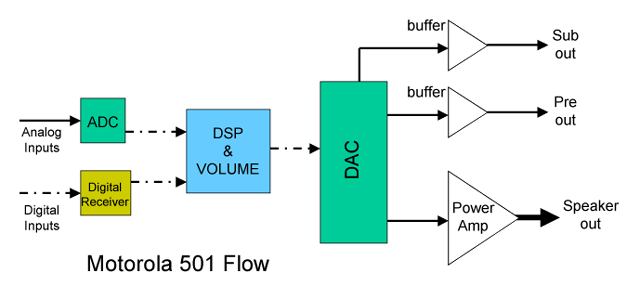

theAnonymous1 said:I haven't taken the front of the unit apart to trace out the volume control, but the DSP board uses CS4391 DAC's which do digital volume control.
http://www.cirruslogic.com/en/pubs/proBulletin/cs4391pi.pdf
That's frustrating, that means all analog signals go through an A/DC first.
Yes, I believe they do.

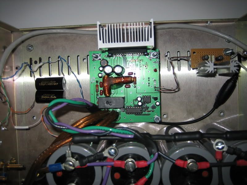

theAnonymous1 said:Well, after almost 8 hours of straight labor I have done a complete makeover to one of my moto's.
I started out by changing the over-current trip limit to allow for >4 ohm loads, then I replaced the 2.2uf electrolytic input caps with 3.3uf Jantzen MKP's.
Next I added another 10,000uf per rail to the supply. I took 2 caps from another moto supply board so they all match. I also changed out the 5v and 10v supply caps with Panasonic FC's and added some bypass caps to empty spots on the board.
The last and most difficult mod I did was replace the spring output terminals with binding posts. This took nearly 3 hours and 2 trips to the hardware store, not to mention extremely sore fingers. It wasn't fun at all.
Oh, I forgot I replaced the power cable with an IEC jack. Makes the unit look pro.😀
Here's a pic of the amp board with new input caps.....
http://i2.tinypic.com/2643q7s.jpg
Power supply board.....
http://i4.tinypic.com/2643r00.jpg
And lastly the back of the unit with binding posts and IEC jack.....
http://i2.tinypic.com/2643spi.jpg
I don't plan on doing this again any time soon; royal PITA.
