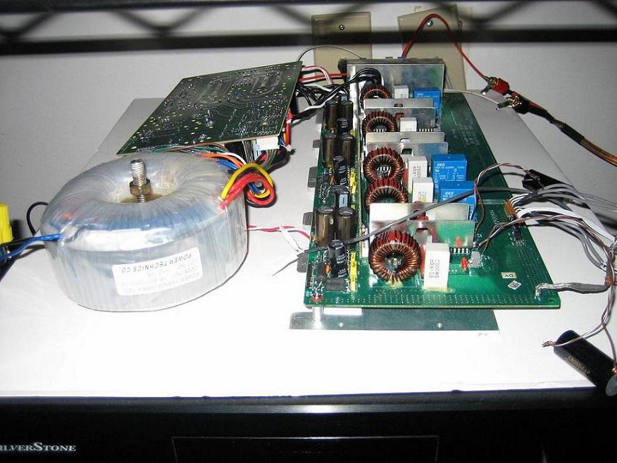

Well, I finally fiished my basement and got around to modding the DCP-501. Took it apart and got the power supply, toroid and amp board out. I did the input cap mod ( a Bennic 2.2uF polypropolene from Madisound replaced the teeny 2.2uF electrolitics), and soldered in the SMD resistors to get around that irratating overload issue. Thanls to AnonymousOne for sending me those resistors...
I didn't really want to do anything else to the amp board and power supply, so the next decision was to either put it all back in the existing case or rehouse. It was late last night and I decided to put all back in the original chassis, since I have another DCP-501 I wanted to rip and rehouse. I elected to keep the crappy spring clips, so I may return to at least upgrade them someday...
The new unit sounds very good. No more overload, and it sounds great. Definitely better than stock. I will keep it just as it is. Not as clear as my Panny XR45/50/55 or my UCD180, but it does have...well, for lack of a better term, body. It's thick, powerful and warm sounding with my modded KEFs and my Maggie MMGs.
Anyway, I will leave the unit as is and rehouse the other one and feed it directly from a DAC. Maybe bridge four to two channels and keep it a high power 2 channel amp. Without all the upstream junk (which really doesn't sound That bad), i anticipate the standalone Ampboard fed by the DAC to sound even better.
For $70, it was a steal. Up there with the $19 T-amp I bought...
More later on the other Amp..

john65b said:Well, I finally fiished my basement and got around to modding the DCP-501. Took it apart and got the power supply, toroid and amp board out. I did the input cap mod ( a Bennic 2.2uF polypropolene from Madisound replaced the teeny 2.2uF electrolitics), and soldered in the SMD resistors to get around that irratating overload issue. Thanls to AnonymousOne for sending me those resistors...
It will definitely sound better with a good DAC.
The DAC board of the 501 that I posted above is full of cheapy electrolytics that ALL of the signals in the unit pass through.
I still havn't done much to my stripped units yet do to lack of time and money. The amp board I'm using now is just sitting on top of my HTPC all naked.
I'm trying to save up for some 1.5KVA transformers to unleash this boards full potential. I would REALLY like two SPS80 switching supplies but they are way out of my price range at nearly $300 each.

Are only the 2 boards shown and the torroid necessary to be used as the amplifier? I had one that died 2 days after use and I'm trying to strip it down to the bare minimums to see if I can get it working.
Yes, just the stuff in the pic is needed.
The board needs to be wired up a specific way to power on and work correctly. When you get to that point; if you need help I'll draw up a pic of how I have mine and post it for you.
