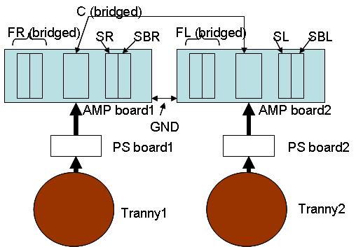

Hey all, one more thing - is there a soft start on the power supply board somewhere? I would think at 600+ VA there would be one???
Finally I opened the unit up! On one side is a complex SMPS (used to power everything EXCEPT the AMP section). The AMP's supply seems to be in the bottom below 2 layers of PCBs (DSP/Decoder board and pre-amp board) 🙁 . theAnonymous1, how did you take apart the PS and AMP board?
The SMPS (which is used to power the other circuits) generates +-30V, +-5V and few other voltages. If the amp board is taken apart and rehoused, can this same SMPS be tweaked to power the amp section?😕
