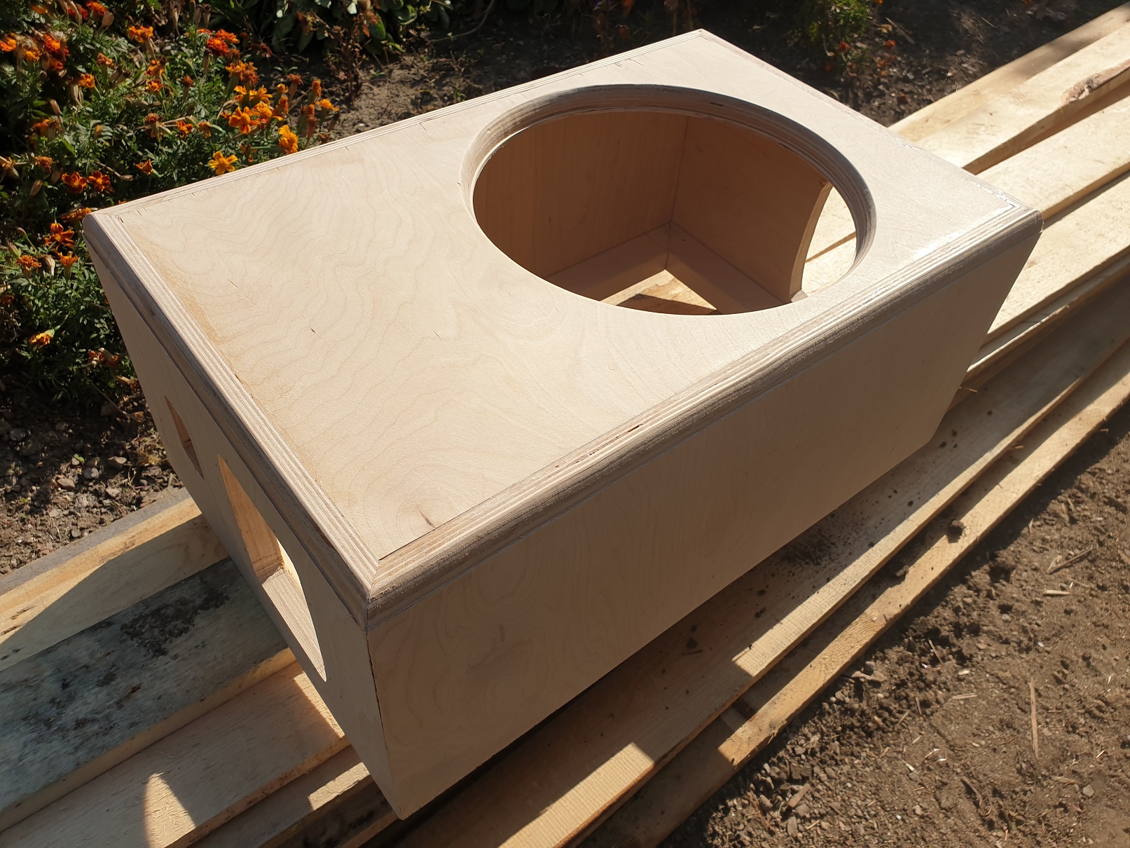

...must weight a ton but it'll last a lifetime.
Which driver do you plan to use? Given this kind of guitar speaker aren't overpriced it may be interesting to try different ones.
It is indeed about the same weight as the Marshall cab which is made out of particle board. I think plywood is much lighter hence the unexpected weight bonus 🙂
I did not brace it, its rigid enough as it is and want to keep a bit more sustain 🙂 Initially I will get a G12-T75 inside (have one made in the UK) but may try an EV12L as well. The V30 and the G12T75 work in about the same enclosure, although the V30 has highish Qts. Eminence have one I have heard and liked a lot, the Red Coat, so also an option to try out.

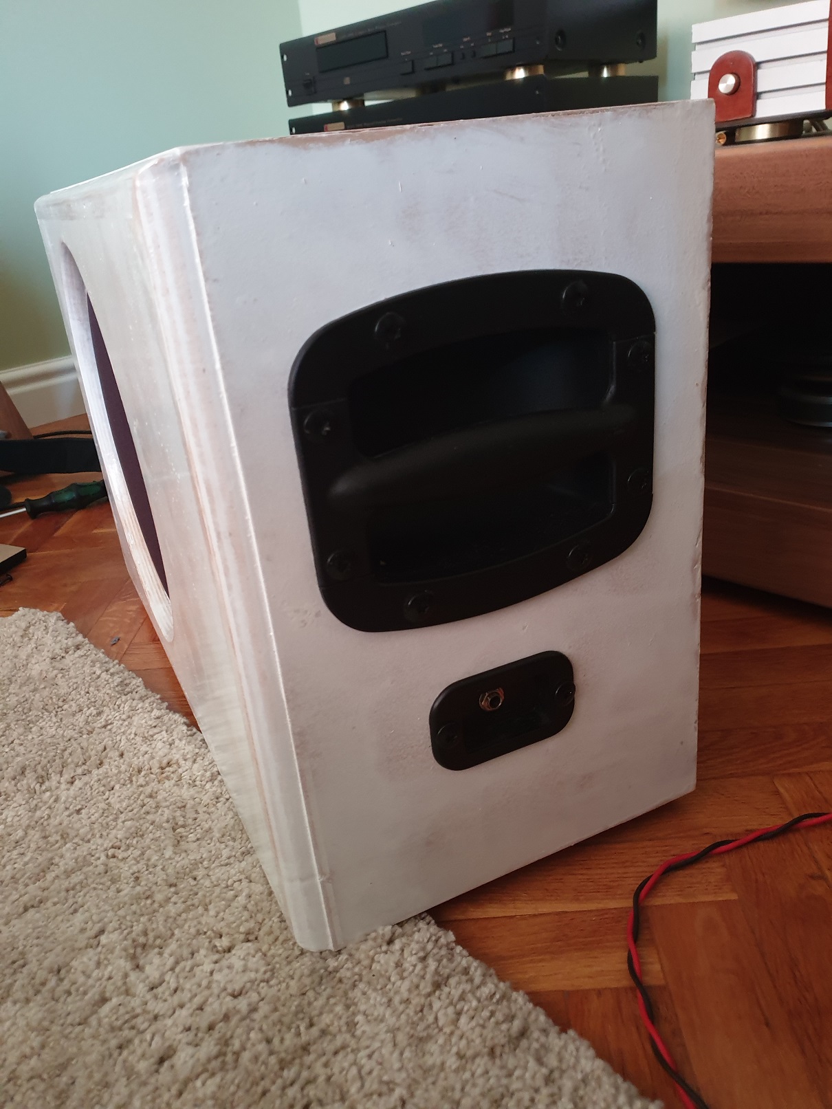

Made some progress today (I would be done if I missed 4 screws of the right size...). The vintage looks did turn as I wanted it, I think it is ugly. Bauhaus plywood was water resistant and they didn`t state it when I bought, paint didn`t adhere well enough and when I started sanding it was just coming off on spots so had to respray lightly but it just didn`t look good. It just didn`t want to absorb paint so I can get it look like the other speakers. So, tolex will eventually cover it in the future.
That aside, all went well and tomorrow I have to mount the speaker TRS panel connector, screw the speaker and add some sound absorption. I think less than 30 min work so will post some photos of the ugly creature. Was lucky (the creature) to get some polyurethane coating as this finish didn`t deserve it but had some left over from a previous project...
I can highly recommend "Warnex" paint sold by Thomann. I painted successfully styro foam with that stuff.😉
Let's bring the ugly creature to life! Who really care about their look if you are happy with the sound?

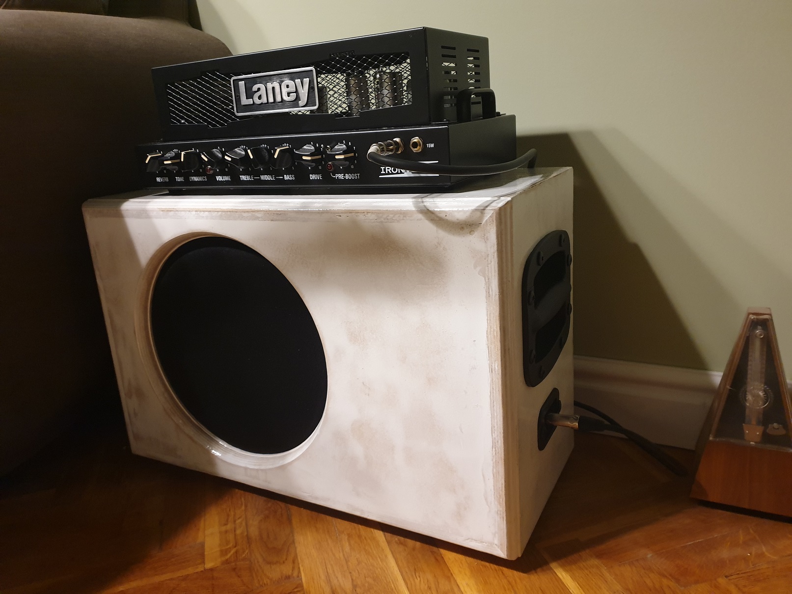

Creature was reanimated today 🙂 And the sound is...I played for over 2 hours until I noticed how much time has passed. I hate to describe sound especially when I have built it but so far I love it. The bass tightness and the overall sound is exactly what I wanted. Next step would be to dismantle again and paint in plain white.

A Laney Ironheart IRT15h - amazing sounding amplifier but has no clean channel which is a bit of disappointing. For rock/metal this thing is absolutely savage.
In the face of some adversity from punters like me, you've persevered and produced a well engineered speaker cabinet - congratulations!...so far I love it. The bass tightness and the overall sound is exactly what I wanted.
In synergy with the Ironheart it could be ideal for playing death metal with its chugging low riffs! 😎
Thanks! There are lots of favourable reviews online for that amp.A Laney Ironheart IRT15h
So it's an all-valve guitar amp with a push-pull pair of EL84 output valves.
A fairly similar amp (except with 6V6 output valves) with no negative feedback was measured (by diyAudio member Printer2) to have an output impedance of roughly 50 ohms.
Those valve guitar amps that do use negative feedback in the power amp section, typically have no more than 6 dB - 10 dB of negative feedback. This would cut the output impedance to roughly half or one-third respectively, say between 25 ohms and 15 ohms.
Another diyAudio member, JohnDH, reported output impedance measurements in the range of 5 ohms to 25 ohms for various (valve) guitar amps. The lower output impedances generally correspond to higher-power amps, using either bigger output valves, or more than one pair of output valves in parallel (4x EL84, etc).
Lacking actual measurements, what follows is merely informed speculation. But we can speculate that the output impedance of the Laney is very likely somewhere between 10 ohms and 50 ohms.
Even the smallest of those values does very dramatic things to speaker Qts (and therefore Qtc.) Ten ohms in series will more than halve the electrical damping in an 8 ohm speaker. In most guitar speakers (with a stiff treated paper surround) Qms is much greater than Qes, and in this case, adding 10 ohms in series will likely roughly double Qts.
This is likely to produce a strong bass hump in the frequency response. I would have expected this to produce strong, but not tight, bass.
Marshall 4x12 sealed cabs are quite popular with some guitarists, and they seen to have the same general behaviour, with a sizeable bass peak in the region of 100 Hz. Again, strong, but not tight, bass.
A boomy bass peak like this is a very bad thing for Hi-Fi. But as many of us have been saying throughout this thread, e-guitar is a very different thing. Clearly, many electric guitar players like having this sort of poorly damped bass peak in the loudspeaker response.
I was unable to find any Thiele-Small parameters for the G12-T75, otherwise I would have at least run a simulated frequency response (with and without an additional 10 ohms - 50 ohms in series).
