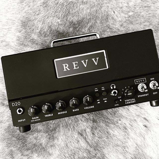

The attachment shows the Revv D20, an all-valve head which has an optional reactive load for organic feel & tone when playing without a cab & hosts virtual cabinets onboard for direct recording, silent playing, & live performance without a microphone.
D20 – Revv Amplification

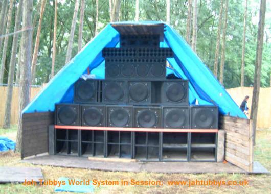

That is also not always true. A classic dub soundsystem is not only the reproducer of the sound, but also shapes it in a high power settings. Those custom build stacks are not at all ment to sound clean and with a flat frequencyplot, they are ment to give the effect of heavy subbas dominated reggae, often with a certain lofi feel to it (the UK ruffneck Steppers style). Key examples of that ruffneck style is Jah Tubby's who build most of his equipment (preamp including the crossover, amps & speakers) himself to his wishes...
I've been to Jamaica, and there's BIG speakers everywhere. People have PA speakers stacked up outside their houses in Kingston. People have beautiful vintage audio equipment in their houses. They play the music loud.
Music is a priority there. Artists in general are held in high esteem; not considered bums like here in the US (I know it's sad).
But a dub soundsystem is for disc jockeys - these are neither guitar speakers nor Hi-Fi speakers.That is also not always true. A classic dub soundsystem is not only the reproducer of the sound, but also shapes it in a high power settings.

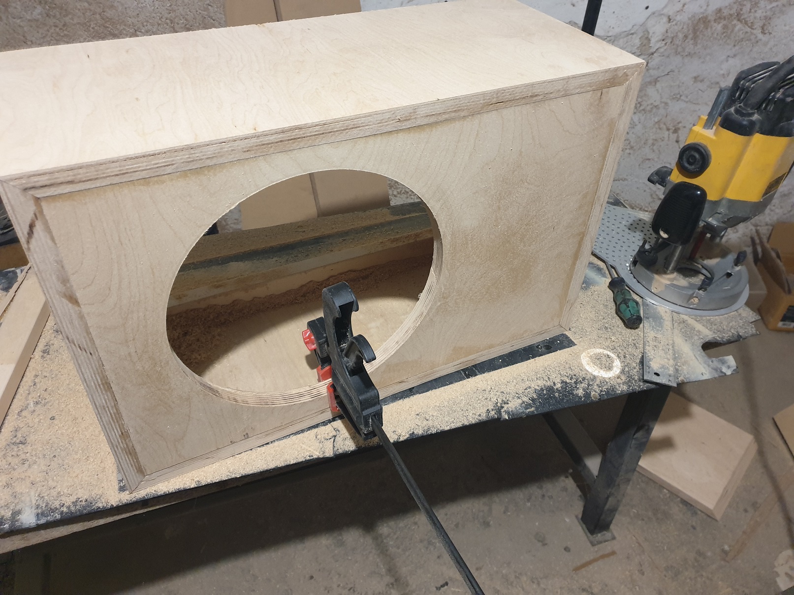

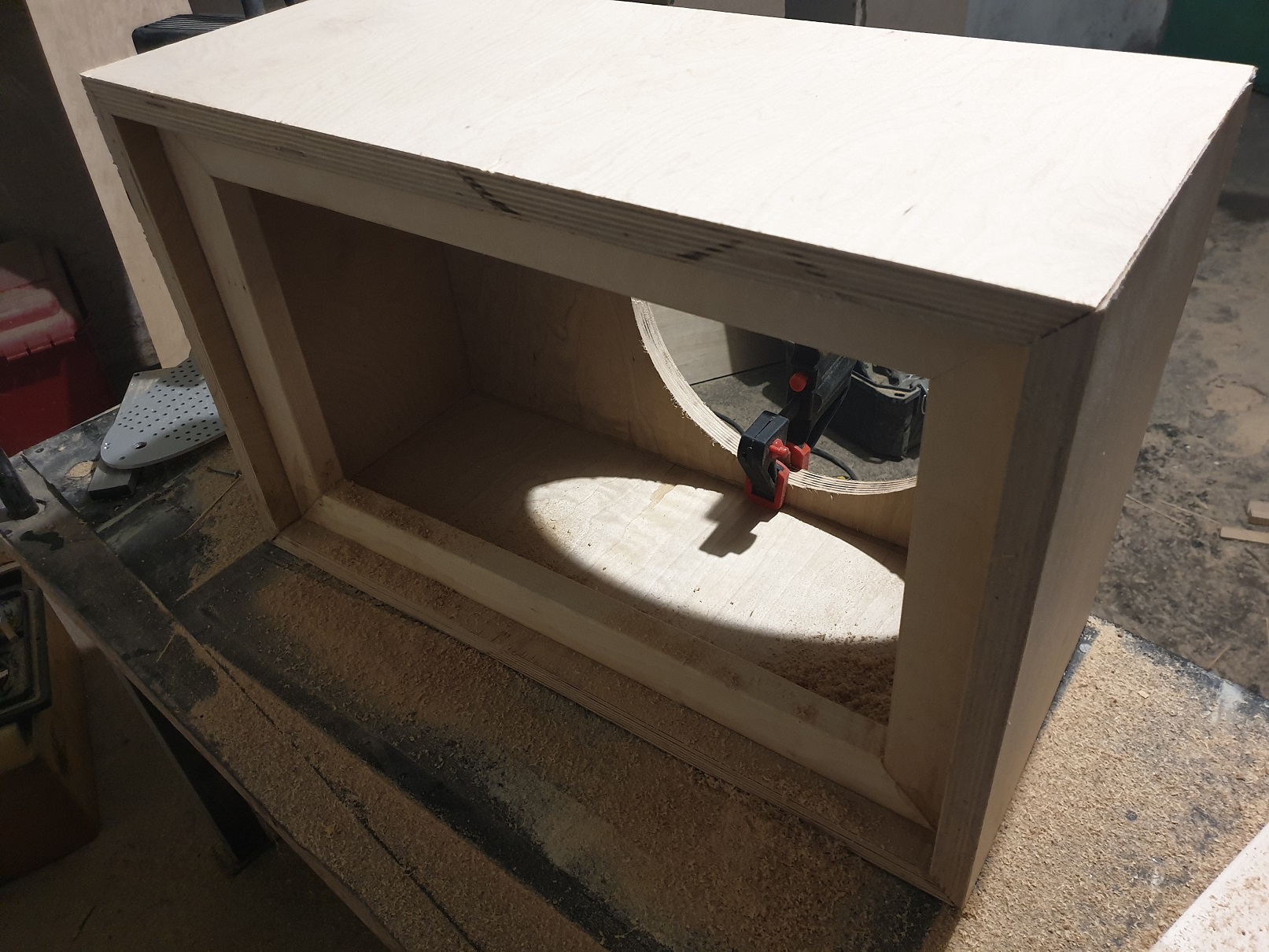

And, its too late to discuss should I do it or not haha 🙂 I used 21mm marine grade birch plywood, the frame at the back is to attach the back so it can be removable. I will seal it with silicone sealing tape (my Marshall cab has no sealing at all so despite being called sealed its more like aperiodic). Driver is offset so only the vertical dimensions are symmetric but there baffle is narrower. I will also run a roundover bit but it will be for cosmetics and to prevent corner chirping. Absorption will be light, foam pyramid sheets and I plan on finishing this with white paint, then sanding it and adding polyurethane clear coating to get a vintage look.
Your fast! Nice to have option to run it closed or open back. 21mm bb... must weight a ton but it'll last a lifetime.
