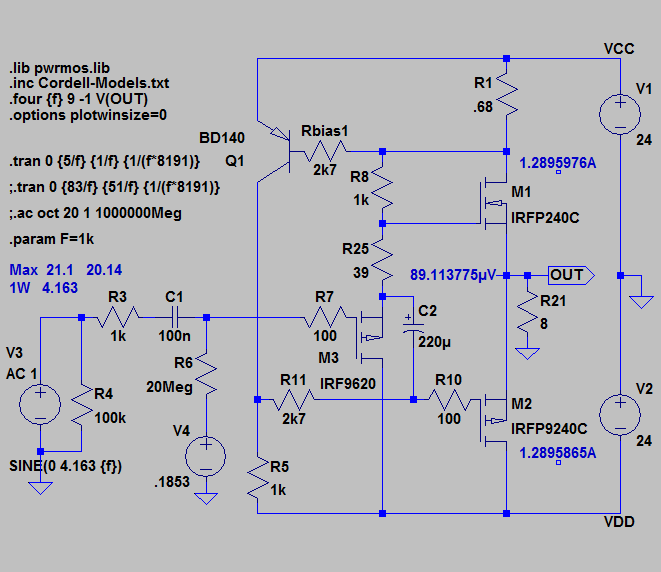

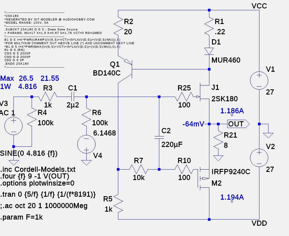

Sorry to disappoint, the big SITs are just beyond my budget, I am working on a hybrid using regular IRFP240 and remember you guys so I drew up the schematic and sim it as a gift. Current in progress project is as attached.... after that , in vivo ....... I'm glad that in vivo , things are even better than sim. prediction, judging by experience with Sissy and Babelfish M25

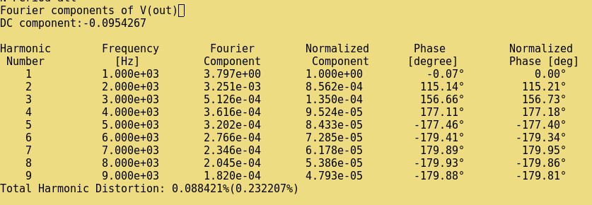

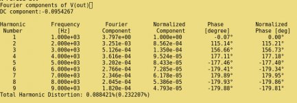

Please note proportion of H2/H3 and phase of H2 has changed.I would make this change to Simpler-Spook.asc:

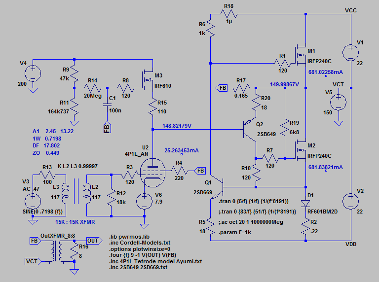

Fourtran SEF
Thanks to you Lynn, here is the Four Transistor SEF.I would make this change to Simpler-Spook.asc:
Simpler Spook R1

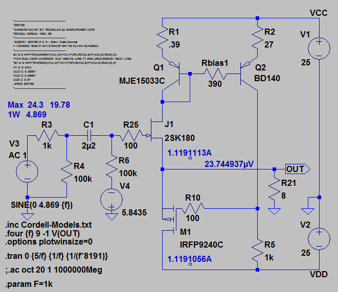

A TO-220 pnp bjt was chosen to replace the axial lead diode to be mounted on the same heatsink with the TO-126 BD140 for better thermal tracking. An Rbias was also added to trim bias to desired value.
The topology allows use of SITs that won't bias correctly with the M2 opto bias, but bias becomes dependent on Vbe of the pnp.

Remember the problem with the beasties? I think Pa just handed out the remedy in the genuine article thread, use beefier 8 legged opto, the 6n type, instead of 3n veggies. 😀...Hall chips - they simply demand additional gain stage , between them and opto(s)...
