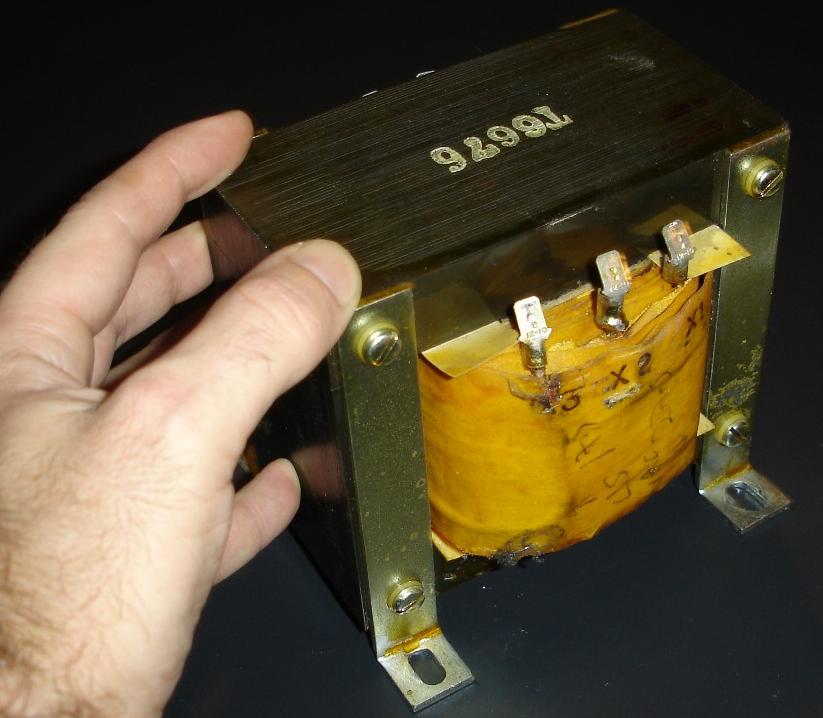

dfdye said:Yikes! I hope it is a little more than that. If not, at least I will have a few more interesting pictures of a flaming transformer to post! 😀
How thick are the secondary wires?
Nevermind, send me the trafo, I'll find out a use for it. 😀
Good idea. The weight is 35+ lbs, so that would line up best (amongh those I have found) with one listed at 40 lbs and 2.5 KVA!!! 😱poobah said:Find out what that transformer weighs... then compare to others with similar output voltages...
Oh my. . .
I am not quite ready to believe this, but the lowest rating I have seen for a transformer a little smaller than this size/weight is 1 KVA. That being said, I think I should have enough juice to power some op-amps.
8 Gauge. They are pretty beefy!carlosfm said:How thick are the secondary wires?
You really want to pay postage on this animal from The States? 😀Nevermind, send me the trafo, I'll find out a use for it. 😀 [/B]
We could work out a trade, but you pay shipping!!!!
I'm at an engineering school with good Comp and Electrical programs, but I haven't done much dumpster diving yet. A couple days ago I got a set of four 6x9 car speakers (20W 4ohm, nothing fancy) and some free carpet scraps. Perhaps I'll look around more in a couple of days.
dfdye said:Another for better scale. Does anybody nave a ballpark for what the amperage rating is? Unfortunately the markings are insanely ambiguous and cryptic. My guess is ~3-5 based on size (making it 500VA) but this is purely a guess. I am sure it will at least be able to power a couple of chips! 😀
What is the secondary voltage?
As for VA, I'd guess somewhere around 2kVA.
I think we are working our way toward that being the consensus figure. 😀AudioFreak said:As for VA, I'd guess somewhere around 2kVA.
As for the secondaries, it is a CT isolation transformer, so ~60V.
At least I know it will be able to power the LM4702's I have on order. The max rails it calls for are +/-85, and by my math 60V RMS should rectify to just under 85V DC, so that would be cutting it pretty close. I may throw in a regulator to give myself a little more head room, but at least I won't have to buy a new transformer for my next project!
For the LM4702, IMHO you absolutely should regulate the chip's supply (even though PSRR looks good at about 80dB) -- just because the power requirements are minimal and you can comfortably drive the chip at say +/- 70V, and have the output transistors running from the full unregulated voltage.
My trafo seems to be 45-27-0; not quite sure how to use that yet...
dfdye said:I think we are working our way toward that being the consensus figure. 😀
IMO, Something like that is just begging for a choke input power supply. Would render about +/-51VDC after rectification and smoothing. You also get to use 100% of the AC current rating of the transformer as DC current instead of about 68% for cap input. Not that you're going to run out of current either way with that transformer.
