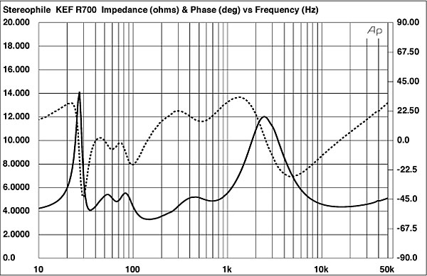

KEF R700, a 3 way manufacturer rated 89db/8 ohm/3.2 ohm min. In reality probably a 87db, 6 ohm speaker. I would like to have a little more volume but it's not a must. I don't know if I need more headroom or amps...I just want "better". Not that it is bad now.
I listen at about 85db in a large room which uses about 9 volts AC at the amp.
9V into 6 ohms in 13 watts. Or 10W into 8 ohms. Let's just say I am using about 1/2 the F5's rated power, not including peaks.
