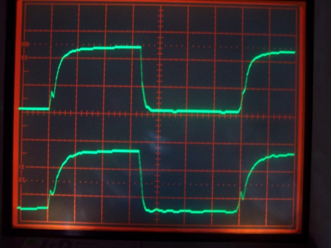

After reviewing a bit more the Cdv/dt issue, some of the app notes talk about watching at the gate waveform to see the spikes that can cause spurious turn-on if they reach Vth.
I have a question here: this problem doesn't seem to have nothing to do with drain currents, so it should manifest even at light loads. I mean, if that's the problem, a spike should be seen when the Vgs voltage is low and the other mosfets is turning on, right?
I checked my gate waveforms with both 6 ohm and 10 ohm gate resistors, with load but no input signal, and they looked this way. I attach the 6 ohms one, the other is almost identical, a bit slower. Can I stop worrying about Cdv/dt then?
The little spike at turn on should be due to the miller charge, but there are no spikes when the mosfet is turn off...
It looks like there's a bit of a step on the lower one. What's that at 5V/div? ~.5V gate step with no substantial output current, why not give it a try with output current and compare them, it just may get worse.
Hey, are those on the same scale? How do they measure pk-pk it almost looks like they aren't the same.
Hi, I think the bigger problem may actually occur when the lower gate is being pulled low, but the Miller effect occurring when the upper MOSFET is pulling its drain high is trying to turn it back on. It may be showing up in the thickened portion of the falling edge of the gate waveform and appears to happen within a very short time interval.
Hi Jaka, we practically crossed in our postings, but I am glad that we said practically the same thing concering the 1N4148 diodes.
Thanks for the soon response to both of you. I love this forum and how helpful people is in it.
The lower one is actually HS mosfet. Yes, the scales are the same. It seems that the HS has a little less amplitude. I will check the other figure (with 10 ohms) to see if it happens the same.
Have in mind that both waveforms are not taken at the same time, so time is not aligned.
I will check with heavier load (I will need to trigger with a digital storage oscilloscope, as the signal moves its duty cycle when a large signal is present).
