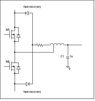

It is to prevent the freewheel diodes from conducting
This can also be done using a technique developed by Brian Attwood. He constructed the output coil as an auto-transformer that feeds two fast-recovery diodes so that the body diodes never get into conduction state.

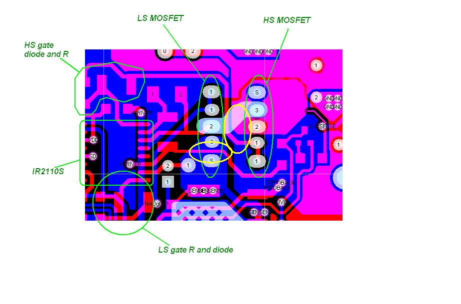

Ah, about miller charge (Qgd), it is about double of Qgs charge, but this happens in FQP46N15, NTP35N15 and even in IRF640N, which ZAP pulse amps used. Is that what you were referring to?
My layout is not bat IMHO. The gate signals are only crossed by heavy current tracks in the yellow marked zones of this scheme:
Hope this drawing is clear enough to follow the gate drive routing. Mosfets are mounted "back to back".
Thanks.
Thanks.

I'm no PCB artist but those current loops don't look all that short? I think you really want all the parts kissing, or as close to that as you possibly can.
Best Regards,
Chris
