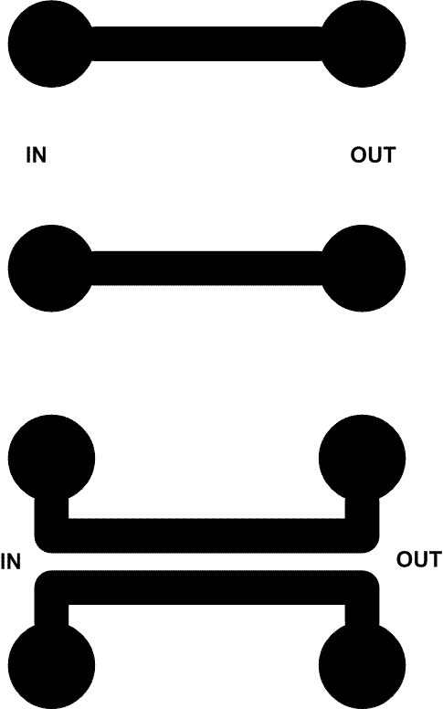

The loop inductance is very important. Have a look at the following drawing. The second loop has less inductance than the first one despite the longer track lengths.

Charles, I would also like you to enlighten us a bit more about reduction of inductance in the tracks!

Simply because the loop is basically an (air cored) inductor with only one turn.
If you now look at the literature you will see that a coil's inductance is proportional to its AREA, the square of its number of turns and the inverse of its length (which is almost zero in our case). The enclosed area of the second loop is clearly smaller than the first one's.
There is a Tripath Appnote that describes these things quite well and you see it also mentioned on some IRF docu. I don't know how reliable Tripath's demo boards are but they seem to get away with quite long tracks between the driver and the output FETs.
We may never forget that it is sometimes only small details that make the difference between a reliable and an unreliable design.
Regards

Thanks, Charles. Simple but convincing. You must be a teacher of have some teaching experience, am I wrong?

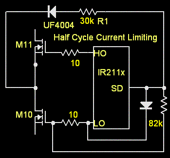

Regarding the IR2110:
The VSS and COM can actually differ by up to +- 5 Volts. This is intentionally so and can be taken advantge of for improving EMC behaviour.
So the precise transmission of the control signals from the input circuitry to the actual driver should still be O.K. with your sense resistor.
But maybe we have to further analyse what happens to the output voltage-swing of the driver. Keep in mind that we "modulate" its negative supply (by the voltage-drop through the sense resistor) while we keep Vcc constant (or dou you keep Vcc to COM constant in your application ? . There could be a reason why IRF senses overcurrent on the upper drain only (within their reference design) !
Regards
Charles
This is also along my line of thought.
In my little simulation the gate signals were indeed modulated, and that is even with values for a sense resistor so low as .001R.
They only seem to say that the driver tolerates the difference.. further investigation on that would be nice, but for a quick n simple way, would it be alright to short the Vss and Vcom pins together? If so that might be telling enough.
Regards
Yes, VSS pin can be tied to COM pin, but all the circuitry (level shifters and dead-time) is referred to what -VCC, so shorting VSS to COM would effectively imply shorting the sensing resistor, so all the current would pass by a inapropiate path and also null current limiting.
To do the test it is easier to short both resistor legs. In fact, I have done some of my tests shorting that resistors. I have to check if there is a relationship between failures and the presence/absence of that resistor.
BTW: as opposed to IR ref. design, Crest LT design for example uses low side current sensing and VSS is connected directly to the negative rail.
Best regards,
Pierre
Best regards,
Pierre
