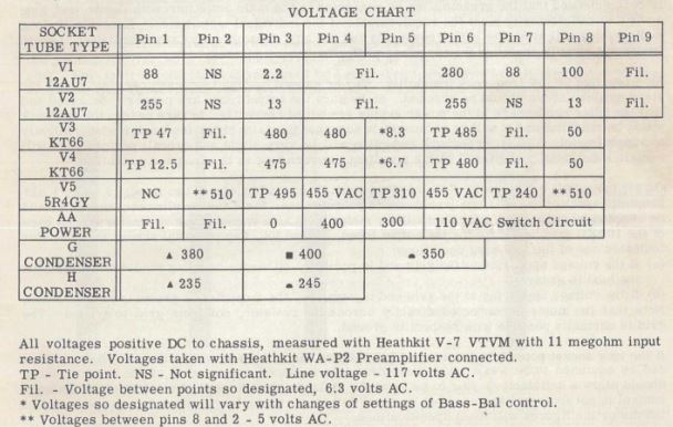

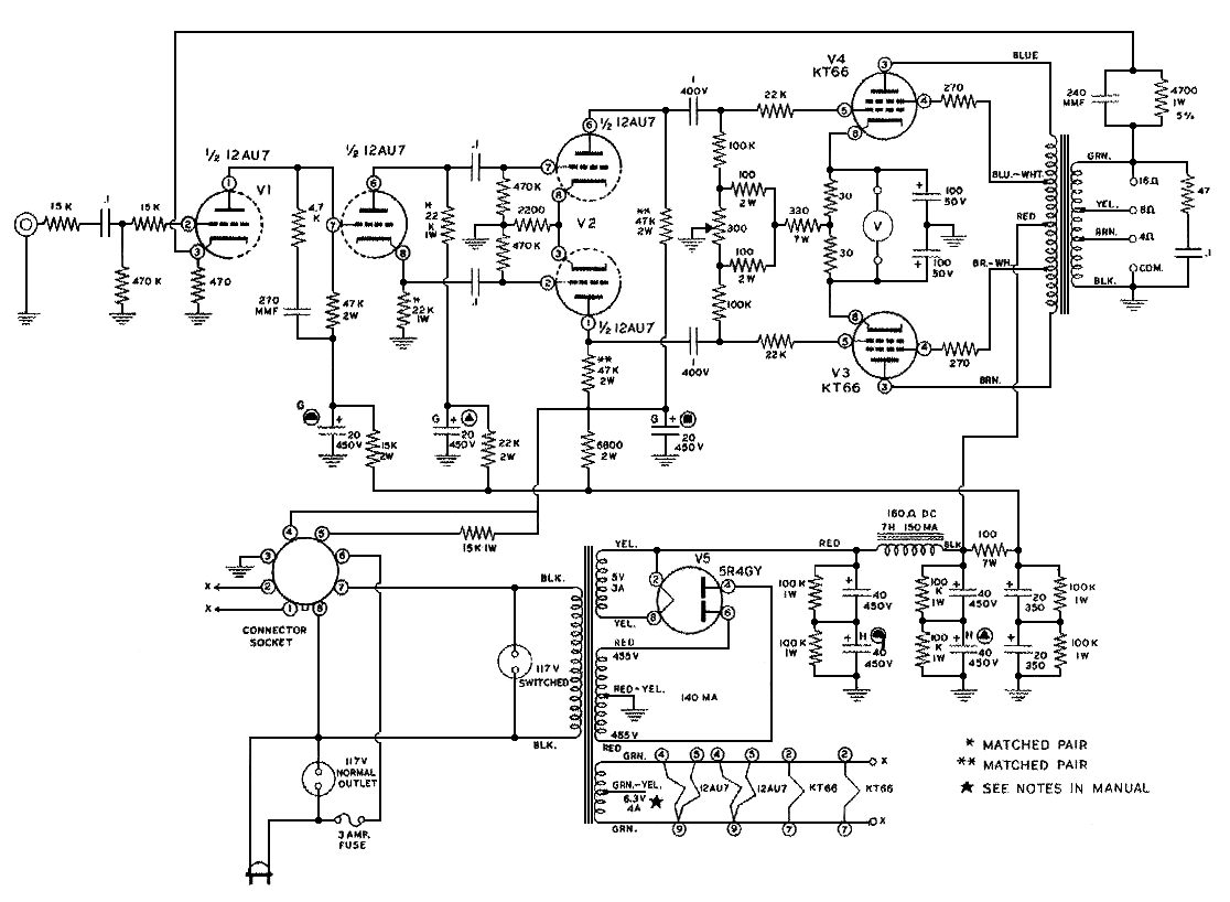

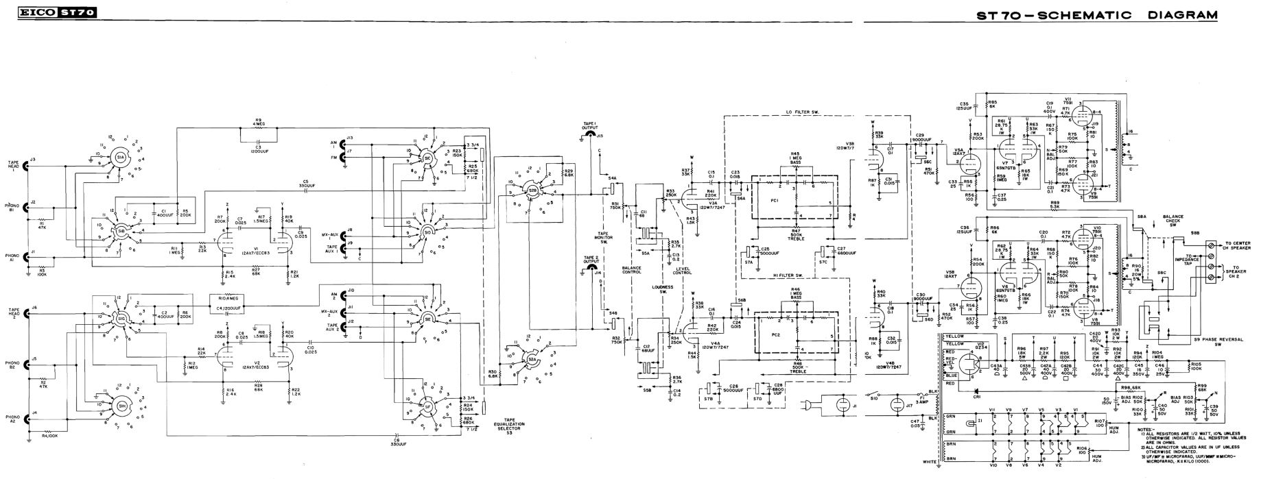

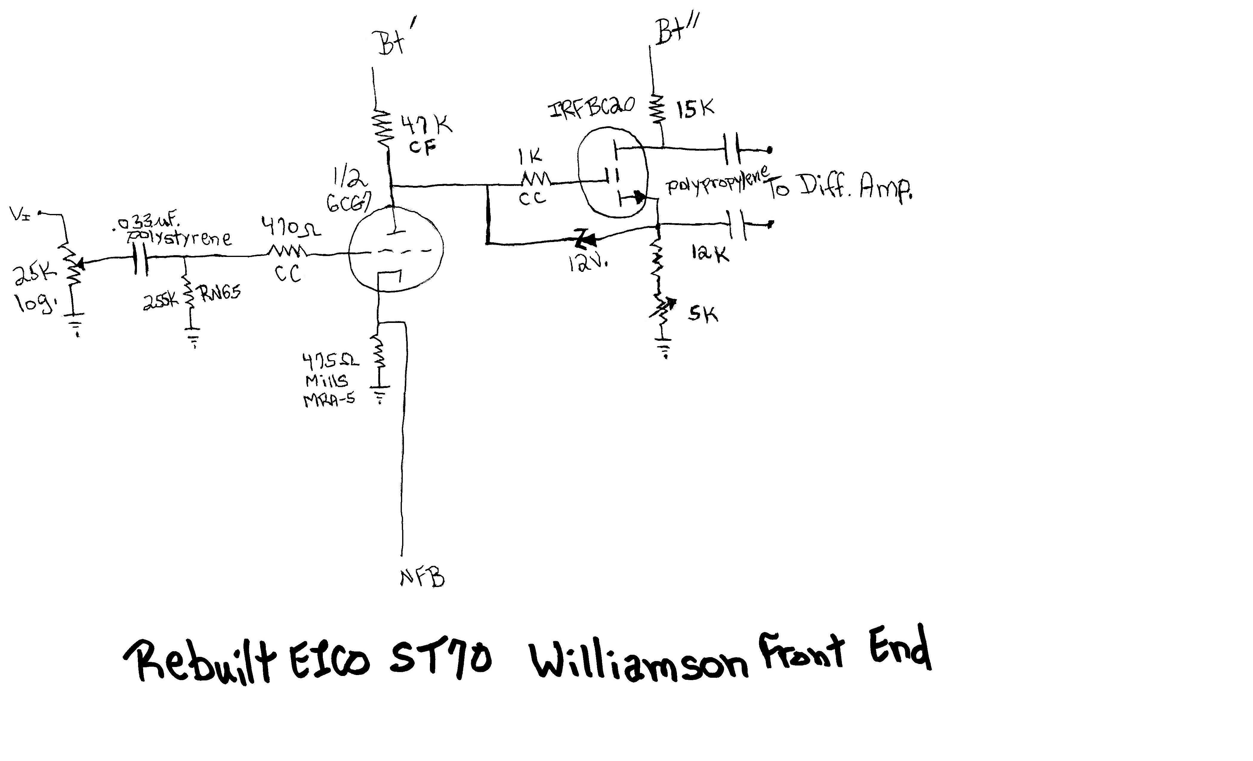

Somebody said Williamson. 😀 I worked with Mike Samra on an EICO ST70 carcass. We replaced the power trafo, kept the O/P "iron", and switched to Williamson topology in the power section, with Russian 6Π3C-E (6p3s-e) "finals". The available socket count forced us to use a MOSFET as the "concertina" phase splitter. Ask Samra what it sounds like.
BTW, we did "borrow" a few bits from the Heath W5-M. 😉

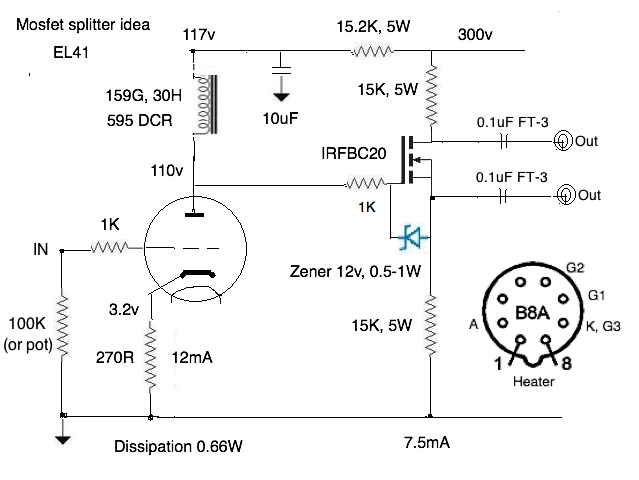

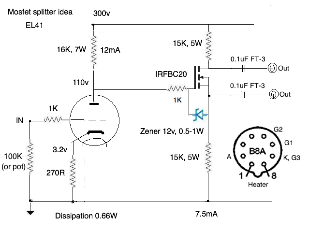

Eli - your hand drawn schematic is perfect for my needs. But could you post it again with all the voltages included? I'm shooting for a B+ of 300v and I need to know what voltage to have on the anode of the first stage if it's direct coupled. All the other voltages would help too.
As I posted earlier, try 100-125V at anode of first stage (V1), roughly about 1/3 of B+. You'll have slightly less than 50Vp (100Vpp) max. swing with 100v at V1 plate to ~< 25Vp (50Vpp) max. swing with 125v at V1 plate.I need to know what voltage to have on the anode of the first stage if it's direct coupled.
The splitter has a gain of two, so needs to swing twice the output voltage of the first stage. If both were ideal, the second stage would idle at half the supply voltage across itself and half across its two load resistors, half (of half) each. This would put the anode of the first stage at 1/4 of supply voltage.
But real valves aren't ideal, although the MOSFETs are close enough for baseball, and the first anode ends up at about 1/3 to 1/4 supply voltage and closer to 1/3, as indra1 has said.

Is there any problem with using a plate choke as load for the input tube?
Not enough headroom for mosfet drain swing.Is there any problem with using a plate choke as load for the input tube?
Could you expand on this please? I have very little working knowledge of solid state devices. What's different between a plate choke and a resistor loading? The mosfet can stay at 300v B+, and a dropper resistor + cap can be used in the B+ feed to the plate choke. The anode of the input tube can stay at 100-125v as you recommend.
Well, think about it this way: how much of the supply DC voltage will drop across that choke? That amount of voltage will be subtracted from the supply voltage to determine the first stage's anode DC voltage. Then, this anode voltage *is* the splitter's grid voltage. At what DC conditions would the splitter operate?
Ohm's Law is always the essential first step in answering questions. Except for questions about women or religion, for which there are no answers.
YOS,
Chris
Should be ok in this particular case. We need roughly 1/3 B+ at mosfet splitter drain resistor, source resistor and Vds (drain to source voltage), the dropper resistor maintain needed headroom. You can try, the choke and cap will give a different presentation but I do not expect any sonic benefit.Could you expand on this please? I have very little working knowledge of solid state devices. What's different between a plate choke and a resistor loading? The mosfet can stay at 300v B+, and a dropper resistor + cap can be used in the B+ feed to the plate choke. The anode of the input tube can stay at 100-125v as you recommend.
Another possibility is a simple ccs. Single bjt, LED, and emitter pot for tweaking. I have built several.
Here's a specimen first stage with resistor and plate choke. So why exactly doesn't the plate choke work? Trying to understand this....
You're still wasting just as much power in resistors, but now you need to spend extra money on a choke and the chassis real estate to fit it... Pourquoi?
Good question....
- I have an existing amp where space is very tight. This will use a resistor load because there's no space for a plate choke or CCS.
- I have another PP amp project where I have much more space available.
I prefer a plate choke because not only does it sound better, but it also allows me to put more current through the tube. This means I can use a smaller cathode resistor and i don't have to use a cathode bypass cap if there's enough inductance in the plate choke. The ones I use have inductances of around 150H.
With a B+ of 300v and an anode voltage of 110v, you have a drop of 190v. If you put say 10mA through the tube you get an anode resistor of 19K. If you use a tube with a Ri of 2 or under and the bias voltage is 1.5v you have a cathode resistor of 150R which may sound OK unbypassed. Bias voltage of 2v and the cap is 200R etc. One of my goals is always to avoid cathode bypass caps where possible. So I do a bit of juggling with tubes and operating points.
