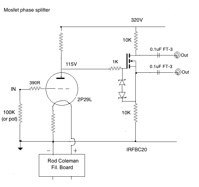

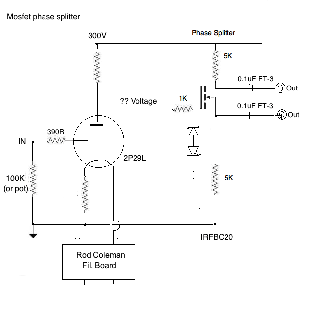

Hi guys. I now have to build a push-pull amp for a friend who's waiting for it, so I have to have a working design for a phase splitter ASAP. Being only used to tubes I don't fully understand how to design this mosfet splitter and need your help so I can get building. I have some IRFBC20 which Eli Duttman recommends. I now have to complete the following design. I need to know the voltage going into the gate for a start. Then the values for the 2 resistors top and bottom of the mosfet. I've put in 5K but suggest something better. And anything else needed in the design? What diodes should I use? Output stage is EL12n in push-pull, easy to drive.
Thanks for your help in finishing off this design!
Yes. Voltage at source will be about 111V, so current through mosfet and resistors ~11 mA, mosfet dissipation ~1.1 watts. Reverse transfer capacitance is at a minimum at Vds>20V, which will be the case for all operating conditions. You probably don't need that much current to drive EL12N grids (pentode connected?), so resistors could be say 22k for 5mA, but up to you.
Here is a question more than a comment: Are the Zener diodes needed if the load is not inductive? I know they won't hurt, but are they necessary?
Yes, it is possible at power up for the gate to be pulled high while the source is pinned low as it charges the coupling cap through the grid current of the output valve, busting the gate open. (You really only need one Zener, though back to back Zeners don't hurt of course)"Here is a question more than a comment: Are the Zener diodes needed if the load is not inductive? I know they won't hurt, but are they necessary?"
EL12n are triode connected. Thanks - I might go with 15K resistors, have some nice wirewounds.Yes. Voltage at source will be about 111V, so current through mosfet and resistors ~11 mA, mosfet dissipation ~1.1 watts. Reverse transfer capacitance is at a minimum at Vds>20V, which will be the case for all operating conditions. You probably don't need that much current to drive EL12N grids (pentode connected?), so resistors could be say 22k for 5mA, but up to you.
If I'm using IRFBC20 do I need heat sinks for them? It would be around 110V at 7.3 mA.
IRFBC20 junction to ambient is 62 degrees per watt. So it will get hot (too hot to touch) but would likely be fine unless ambient is really high, maximum junction temperature is 150 degrees C. A small clip-on heatsink wouldn't hurt.
Enhancement mode MOSFET, if I'm not mistaken need a bias network on the gate (voltage divider). Look at Tubelab's 100 buck challenge guitar amp schematic for ideas how it can be done.
With that much voltage on the cathode resistor, it doesn’t really make a difference if the FET is E-mode or D-mode. Just has to handle the voltage and have its capacitances remain linear. Just keeping VDS up near 50V or more will do this with just about any HV FET. Some do better at lower VDS so depening on type it could go lower transparently.
Ok, what would happen if you grafted the mosfet right across an existing tube; would it simply "override" the tubes operation by brute force? Like the triode sayin; "My friend here says we will drive 10k plate and cathode loads".
Well, in order for an E-mode to start conducting, vgs would be >0. That would be driving that triode into grid conduction so it’s not the most linear operation. With D-mode you’d probably have either the FET dominating, or the tube, depending on Vth and the resulting Ik.
It's directly coupled, so no additional bias network neededEnhancement mode MOSFET, if I'm not mistaken need a bias network on the gate (voltage divider).
