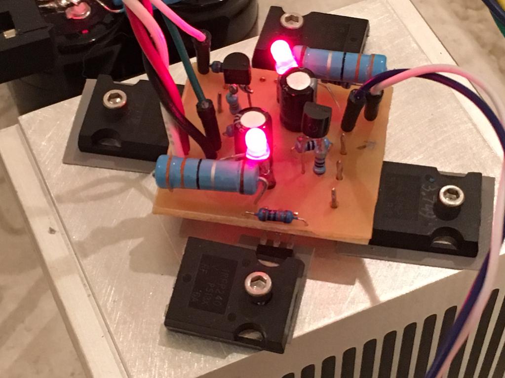

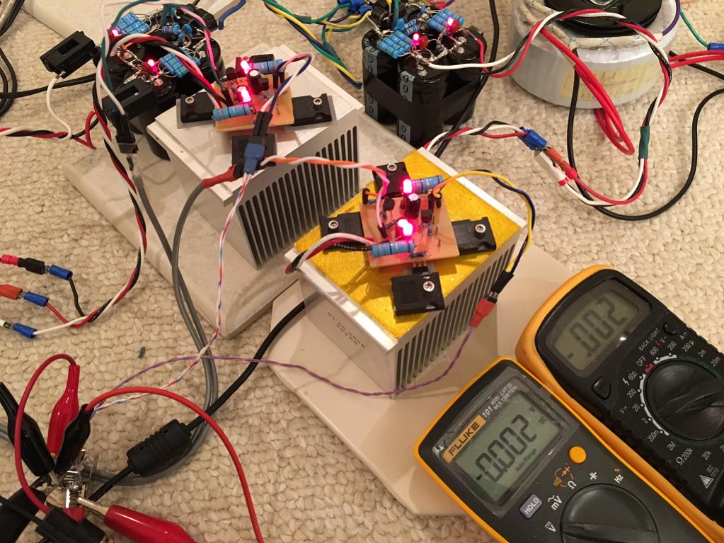

In stereo at last. I added a small 47R 1/4w resistor in parallel on the positive Source resistor for one amp and 470R 1/4w resistor on the other amp and the DC offset is now stable at 2mV or less. Bias on one amp is 367mA and 424mA on the other. Not sure why they are different other than average Vgs on amps is not the same. Sounds terrific - the quietest amp I have ever heard. Very transparent - no coloration and very low distortion to my ears. Incredible bass authority. I like it a lot. Now I just need to build a good protection circuit.
Here are the stereo amps showing 2mV offset:
Here is a closeup of the second channel with proper etched PCB (both channels now using PDF iron on transfer PCB's):
I would not trust the last digit for a measurement.
Often the spec sheet shows ±tolerance + digits
A reading of 0.002Vdc with a ±0.5%+3digits tolerance could be anywhere from -1.01mVdc to +5.01mVdc
You should switch to the scale that has 0.1mVdc resolution to be more sure of what the offset (or any low voltage) is likely to be.
That gives much more confidence. Adding or subtracting 3 least significant digits to those readings leaves one between 1.0mVdc to 1.6mVdc and the other becomes 1.2mVdc to 1.8mVdcIn actual mV mode it shows between 1.3mV to 1.5mV.
All the range of possible voltages are in the same millivolt !
compared to

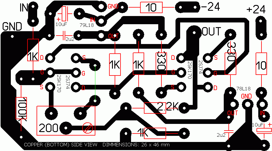

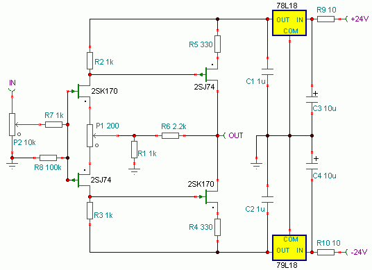

I was listening to it for 2 hours yesterday running with small fan on heatsink and with DVM hooked up the whole time and DC offset has further stabilized to 0.1mV to 0.3mV the whole time. Amazing stability actually. I am really liking this amp but now wondering if I need something like a simple Juma +6dB preamp using 2sk170 and 2sj74 to provide the gain needed to drive high impedance
phones.
Juma uses this for driving his F5 (says make R6=R1=1k for 6dB gain):
PCB:

I'd use this (post #346) :
http://www.diyaudio.com/forums/pass-labs/146310-bf862-preamp-7.html#post4426944
