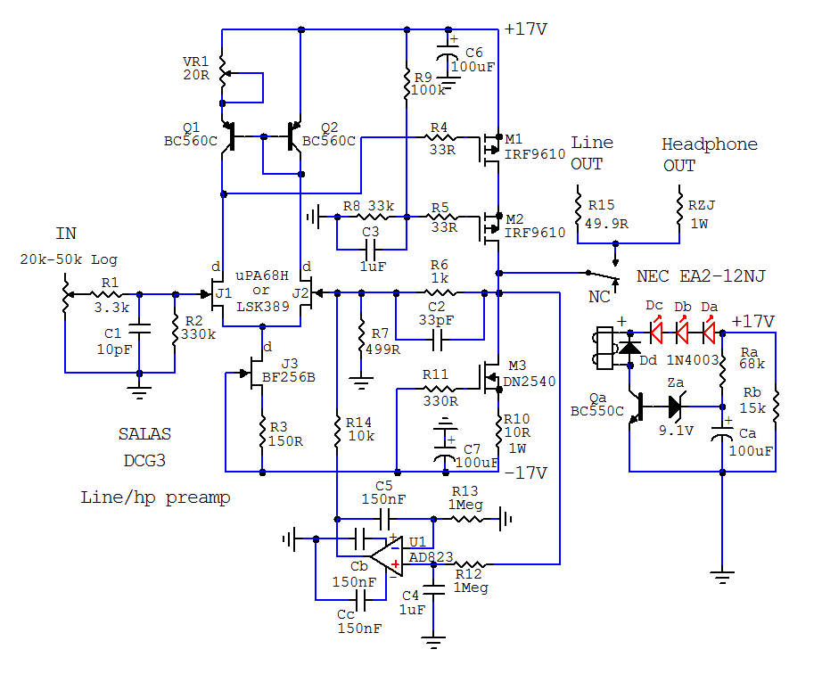

Since you seem to love to build headamps have you seen this?
http://www.diyaudio.com/forums/analog-line-level/296406-salas-dcg3-preamp-line-headphone.html
I haven't built it, but I have a PCB ordered during the group buy.

Thanks for the tip Hikari. I have not seen this one yet but does look very promising. It's a bit more complicated and uses an LTP input stage so sound signature will be different. Lately I find myself oreferig then harmonic profile of a singleton input. I will keep in mind though.
