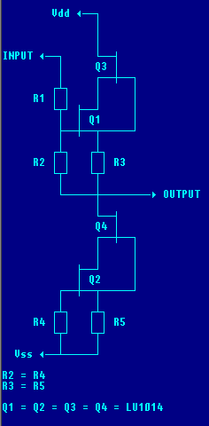

Here's a variation on a theme I've tried with high-impedance cans, adapted to LU1014s instead of 2SK170V. I think this is similar to what steenoe tried.
Vdd-Vss < 24V, of course.
The R1-R2 arrangement is based on some paper from Vishay, and should improve DC offset IIRC. I think R1=10K and R2=R4=1K should work, but I haven't got any LU's to play with (obtw, steen, I'm still waiting for a reply re those LU's
R3/R5 can be 120 ohm for cans that are DIN compliant, lower otherwise. Cascoding limits the influence of the lower Ygs on this.
R4=R2 is just a rough approximation to match the influence of Igsx on gate voltage.
The LU's should be saturable down to 0.1Vds, and have -1Vgs on average IIRC, so strapping the cascode to the source should work fine. Not so good for my 2SK170's.

> The R1-R2 arrangement is based on some paper from Vishay, and should improve DC offset IIRC. I think R1=10K and R2=R4=1K should work. R3/R5 can be 120 ohm for cans that are DIN compliant, lower otherwise.
It would be interesting to see measurements of Id vs Vgs on both JFETs in your circuit when you load the output with say 200 ohm and drive the input with, say, a sine wave of 2.5Vrms, 1kHz.

I would suggest much lower rails. Assuming that the circuit might be driven to clipping, you're going to be perilously close to the voltage limit for the parts. They might take it...they might not...

Yes, I'd suggest lower rails too, for a different but related reason.
Even with a Vds of 0.1V, these devices can push a serious amount of current. Headphones rarely need a whole lot of voltage swing and current at the same time, and I got the idea that they were looking to drive low impedance cans, like the Grado ones.
Quite simply, hight voltage rails dissipate more for little real gain.
As for voltage limits, bear in mind that there should be at least 2V or so being burned in the resistors, and the cascodes suck up 4V or so (-2*Vgs each). Hence, at +/- 12V (what I intended as the upper limit), you're looking at 18Vds at clipping. Hardly anything to write home about with less than an amp of current and proper heatsinking, although not much point either.
But, yeah, being conservative is good, too.
Particularly if you go for cans that don't like the DIN-recommended output impedance, in which case I'd suggest switching the values. The Grado cans, at least, seem pretty flat, though, impedance-wise.

The circuit I suggested uses a current source that is identical to the follower, in order to get minimal offset when the components are matched, as well as similar operating characteristics, etc.
As for two-terminal JFET current sources, they're usually long-channel JFETs, whereas many audio JFETs are short-channel, with long-channel being preferable due to lower Ygs/Yfs ratio etc.. Also, I think the intrinsic resistance of the channel, not a diffused resistor, is what is offering the fixed saturation point.
That said, getting dual monolithic current sources is rare, so I prefer building them discretely and adjusting the currents with a pot to get minimum mismatch. Got some LS844 samples from LIS. Those had pretty nice matching. Can't wait to check out the LS843 (1mVgs diff, minimal temp drift, etc) in this regard. I'll have to beg nicely when I place the order for the LSK170's (waiting for the LSJ74's to become available first).
The purpose of using LU1014 in the original DAO Follower circuit with the fixed voltage cascode and the 3R source resistor is, despite the lower bias current, essentially the same as in ZV9, i.e. to make use of the triode characterisitics of this JFET to find a load line which is linear.
Therefore I am interested to see a load line based on Rsource 120R and a 1.xxV Vds cascode from another LU1014. You might find that the loadline is quite a bit different, and that you would lose quite a bit of transconductance of the amplifying JFET.
