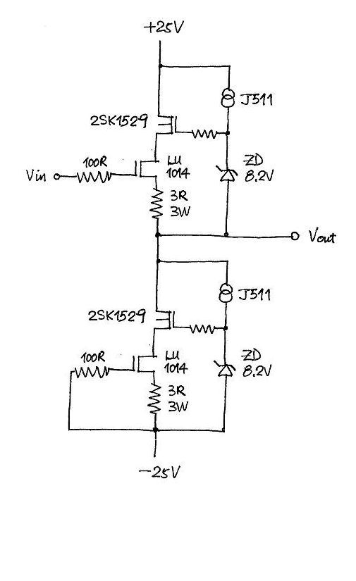

Grey,
Thanks for the suggestions.
a) Input resistor
Was too lazy to draw input pot, etc. But point taken.

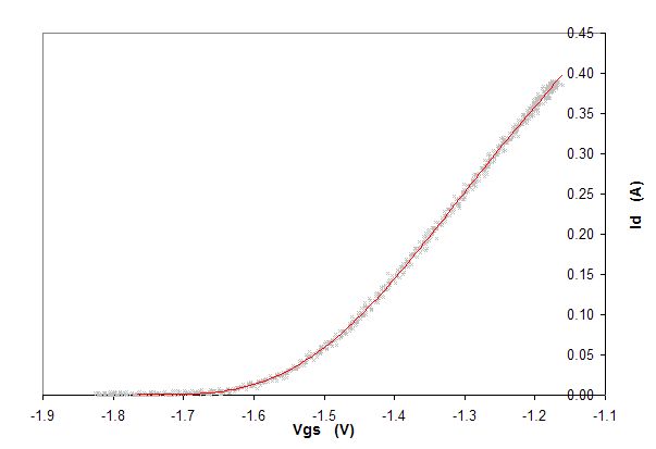

b) DN2540 as cascode
Good idea, but 3 issues with that :
1. DN2540 runs out of stream at 0.5A, so one would have to reduce bias to 200mA, and increase source resistor to about 10R. 🙁
2. It has a factor of 4 less transcoductance, so load line on LU1014 would change.
3. At 200mA, Vgs is about -1.8V. A bit too low ?
c) Thermal stability
Good point, so let's do version 2 (borrowed from Mr. Curl).
A bit of a waste, but if well match should be self stabilising.
I have no headphone, so no motivation to build.
But Steen must still have enough Loveltechs. Fancy a quick mockup ?
Patrick
PS You may of course use IRFP240 instead of 2SK1529. You should also play around with Zener voltage to find the sweet spot for the JFET.

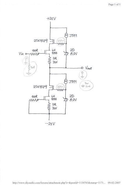

As a matter of fact, I do.
How is this for the last details? Check the values, please.
What is the output impedance of this circuit? A standard headphone expects to see around 120r.
Looks OK.
Input resistor is probably not critical. Try 10k and 22k and see whether you hear any difference.
The gate resistor you need to try. Start with 220R if you use IRFP240. You may then try 100R and see whether you get oscillation (I doubt).
I normally use 432R with 2SK1529, which has much lower capacitance.
You might need to adjust one of the source resistor a bit (e.g. by parallel a high value 1W) to get zero offset at the ouput if the JFETs are not 100% fully matched.
Patrick
> I asked this:
Was not in your original post. 🙂
Well, I would say the output impedance would be the source resistor plus 1/Yfs for the JFET at the working point, which is about 1 ohm. So in total 4 ohms. If you what lower impedance, you could lower the source resistor to say 0.68R (a la ZV9) with corresponding increase in bias current (and heat).
