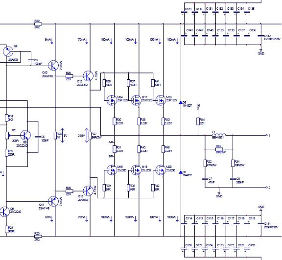

This is the configuration I use with V mosfets, anything else just doesnt sound good to me. Without proper drive these V mosfets seem to have a lack of low down bass compaired to BJTS.

I just ran a couple of Spice simulations using Tina 7 Texas Instruments. The result came as a surprise to me. It is possible to get a fast amp and still delivering low THD using a cascoded J-FET input stage biased at 1.25 mA in each FET, feeding a cascoded VAS biased at 25 mA without a complementary Darlington arrangement (thus, no more a Sziklai pair) and without emitter followers.
So, using a simple circuit, we get a 700 KHz -3dB corner frequency and a slew-rate (dV/dt) of about 150 V/µs.
So yes, like krachkiste wrote, it definitely proves that the effective C_gs seen by the VAS is heavily divided by the Gm (combined to R_load) provided by the MOSFET. C_gs gets divided by something like between 20 to 100, depending on the load.
Moreover, putting MOSFETs in parallel doesn't impact dV/dt. On one side, you multiply the C_gs capacitance, but on the other side, you also multiply the Gm factor.
Attached you will find a schematic for such fast & low THD amp, edited under Tina 7 Texas Instruments, ready for simulation.
Please note the VAS emitter decoupling network.
You can download Tina 7 Texas Instruments free of charge here SPICE-Based Analog Simulation Program - TINA-TI - TI Tool Folder
Just one thin doubt : the MOSFET simulation model doesn't take into account possible dependencies of C_gs in function of I_d. It means that the simulation is maybe valid regarding dV/dt, but less valid regarding THD.
And actually this whole discussion is one of the reasons (maybe there are more, I don't know yet) I will use an emitter follower driver stage before my FETs 😉
According to this simulation, the last thing to do would be to add an emitter follower stage between the VAS and the MOSFETs. Can you explain again why you want to add an emitter follower stage ?
