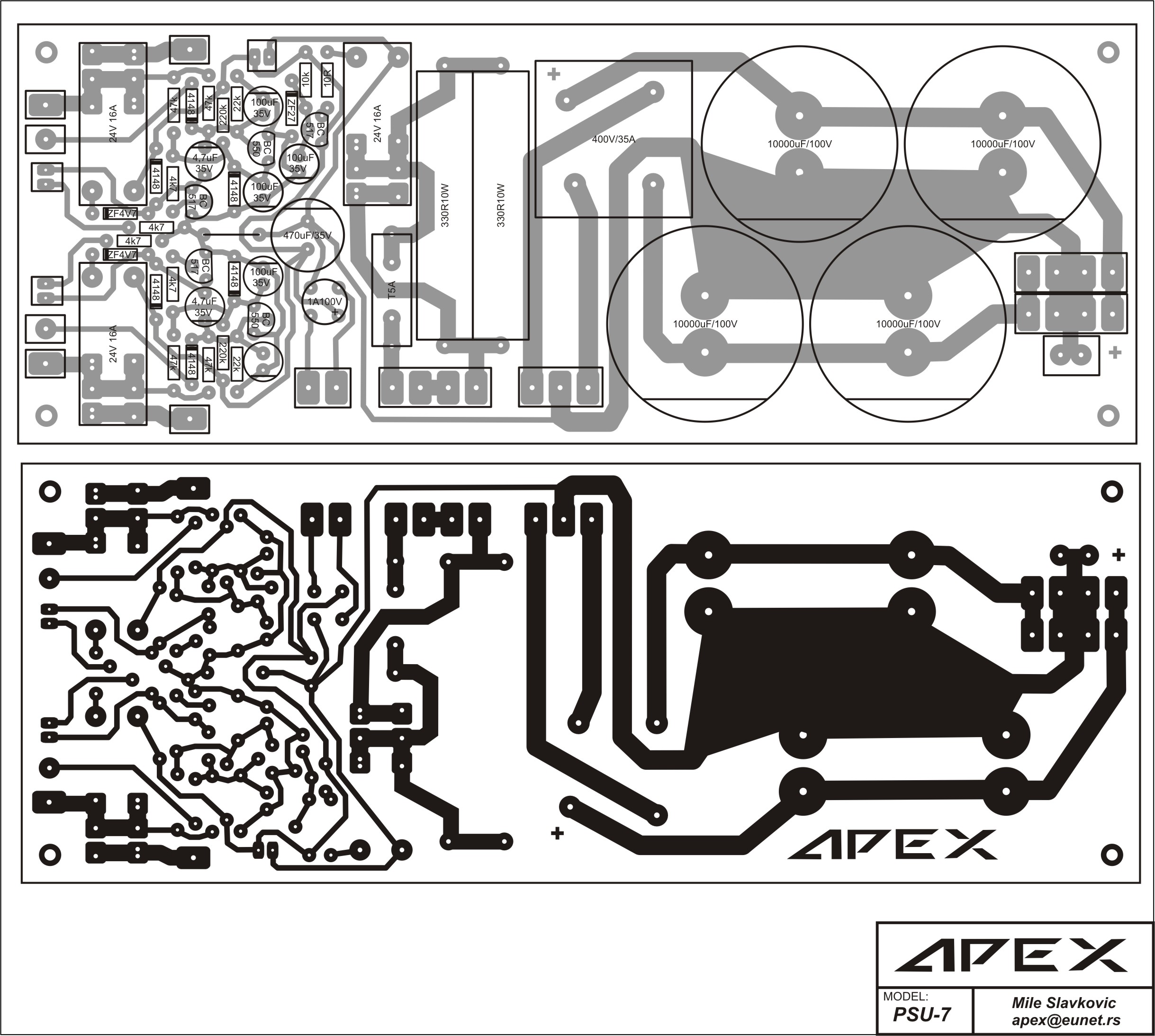

PSU for DIY with soft-start and DC protect. Transformer 1kVA sec: 2x55V 8A + 24V 1A.hi apex i want protection pcb layout and circuit for mosfet amp plz send me khalsaaudiocenter@yahoo.com
PCB size: 200x75mm

hi apex thanks for send the power suplly pcb layout but i want the layout of your 20 no fourm kindly send me

This PCB is still in comercial use, posted Power and Protect PCB with Soft-Start is compatibile with MOSFET AMP. This PSU PCB is for stereo amplifier.hi apex thanks for send the power suplly pcb layout but i want the layout of your 20 no fourm kindly send me
hi apex i am used this circuit for comercial audio kindly send me the circuit and pcb layout thanks khalsaaudiocenter@yahoo.com

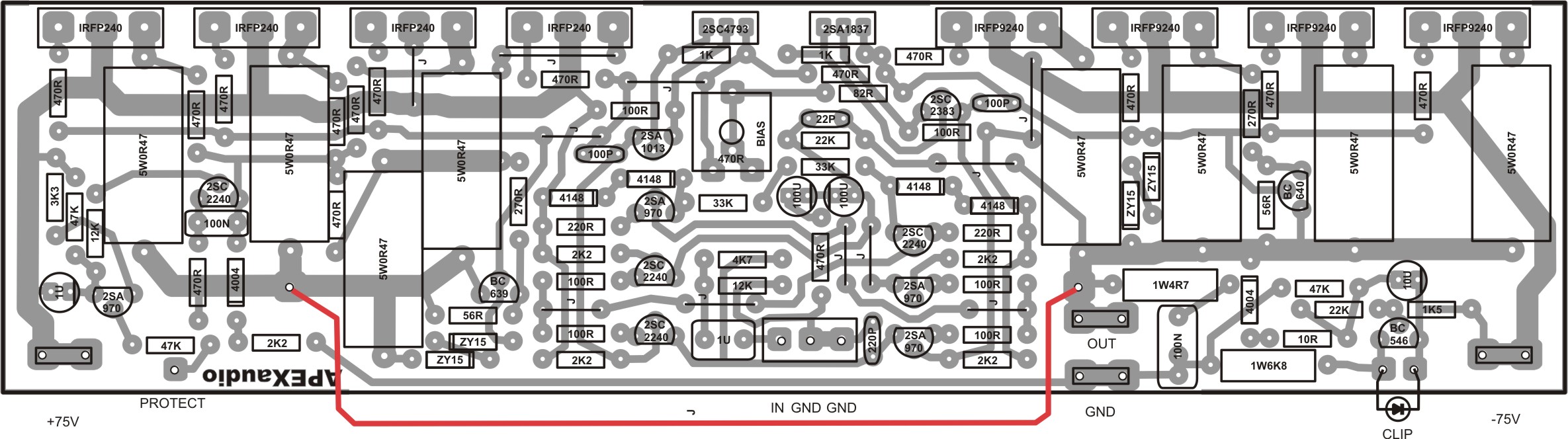

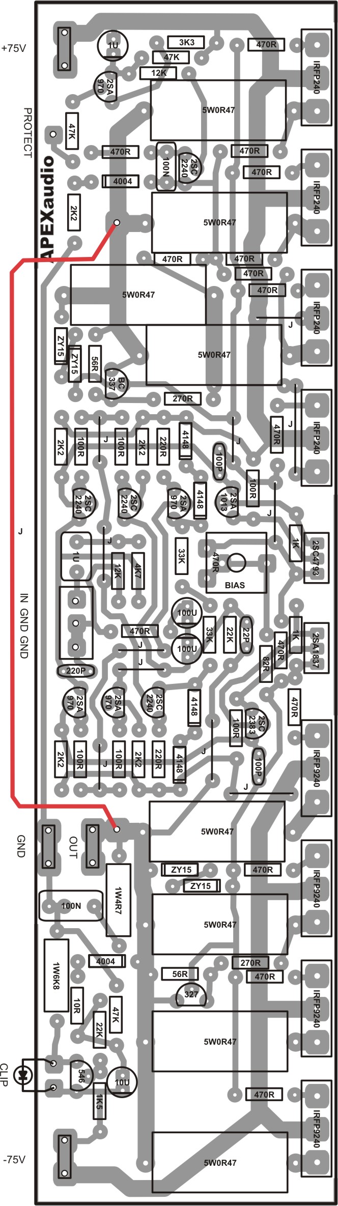

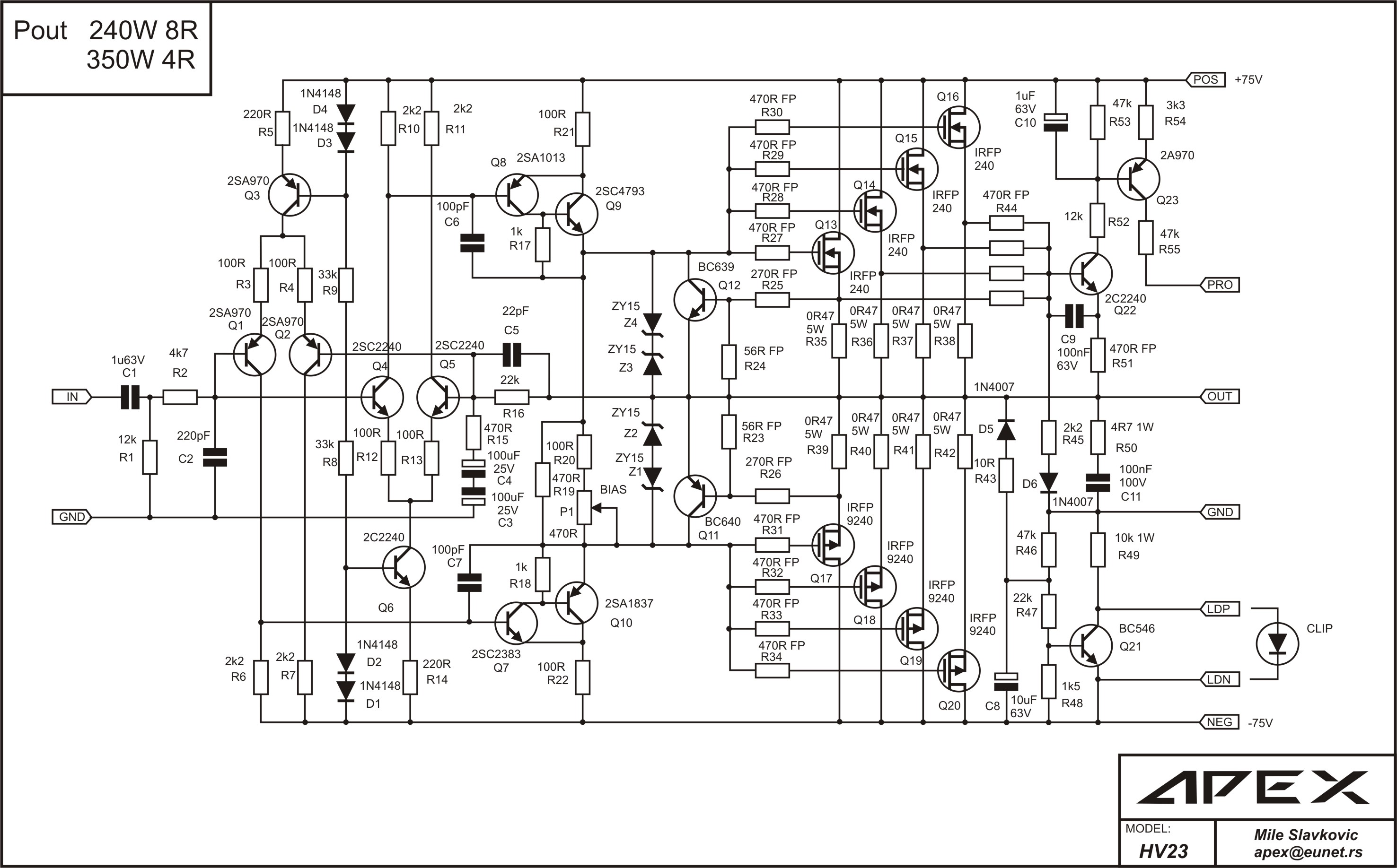

Simple Full Complementary Simetry +/-80V. Voltage amplifier/driver biased with 30mA. This driver circuit stabilized BIAS in output stage. Exelent stability without oscilation, hum and noise, sound great.
RMS Power: 240W 8ohm, 350W 4ohm
Nice work. I have something similar. http://www.diyaudio.com/forums/solid-state/154104-topology-federmann-hqqf-55-a.html
I will soon publish a detailed plan and the results of all measurements and tests. I have very many interesting results.
Thank you, but I see much diferent design.Nice work. I have something similar. http://www.diyaudio.com/forums/solid-state/154104-topology-federmann-hqqf-55-a.html
- MOSFET Amplifier IRFP240/IRFP9240
