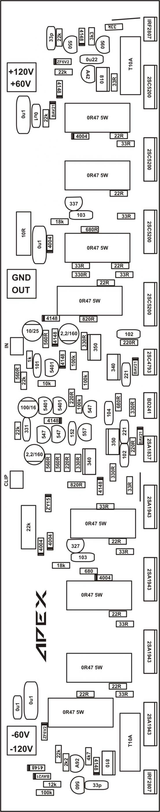

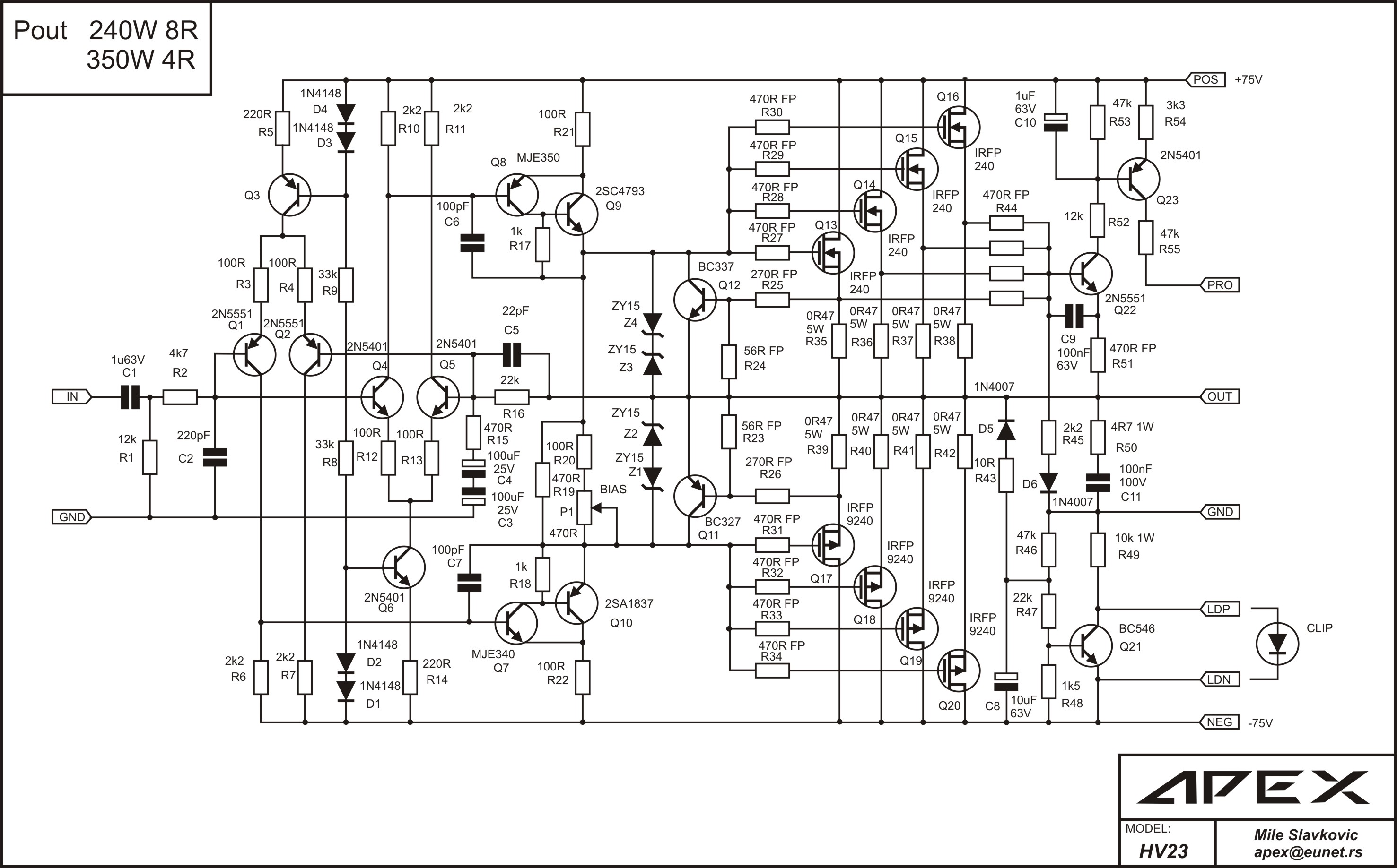

an amplifier that its designed to work with V limmiters in a PA housing with controled ventilation might escape the smoke even if bias is unstable
it might looks thermally unstable as a circuit but it might be stable enough as a complete product ....
Let us not forget that even that even pro amps like QSC dont use a transistor to monitor temperature .... just a simple noisy inexpensive thermistor ...still the get away with it ....
And by the way i also agree on the bias issues and also to my understanding there is no chance that an amplifier like that will keep stable without a zobel, with inductor,and clamp diodes that is missing from your schmtics and pcb ....unless all the above is located else where
Bottom line is if you invest money in a PA or any other big amplifier construction ( since amplifiers like that tent to cost some money ) it would be wise to have all mistakes corrected and use state of the art circuit and semis any way....
Why anyone have no any coment on unusuall circuit Q8,Q9,R17,R21 and Q7,Q10,R18,R22 in voltage amp... Mosfets IRFP240 and IRFP9240 had integrited clamp diode, R50, C11 are zobel, and inductor is on speakers terminal. On the fotos you can see an amp without fan, make for home listening many years ago. Amp is simple to build and test, work with two output mosfets on +/-50V DC.

In last tree years in my PA amplifiers I use new design with 2SA1943/2SC5200 bipolar output tranzistors and IRF2807 mosfets for step. Amplifier work in H class 0,+/-60V,+/-120V.
