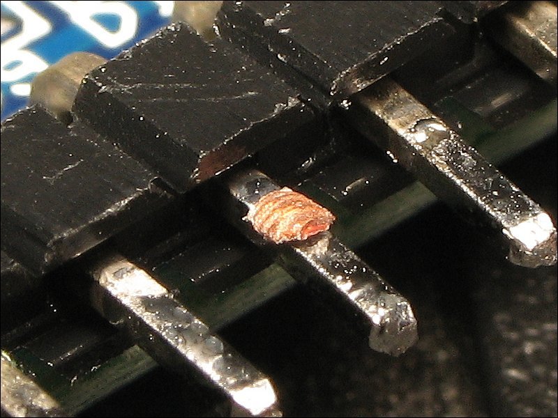

Can you tell that I don't want you to damage the main board... as too many others have done. It's easy to do, difficult to repair properly and easy to avoid.
There have been so many images that have been sent to me via email and posted here that showed bits of the plated vias being ripped out of the main boards. This is permanent damage. It can be repaired to a point where the amp will function but the main board will always have damage. Would you want to buy an amp with that sort of damage?
