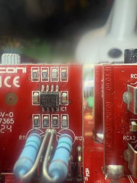

Check the output terminals of the op-amp on the RCA board. Are the voltages the same on pins 1 and 7?
ok the only component on the rca board that looks like an op amp is IC1, but it is listed in the manual as a 1.5A Positive Voltage Regulator.
Unsure of pin numbers, from top left to right, pin 4 has 1v, from bottom left to right pin 3 has 0.5v. All others have millivolts.
There is no information on anything but the main board. IC1 on the main board is a regulator.
Look at the NE5532 datasheet.

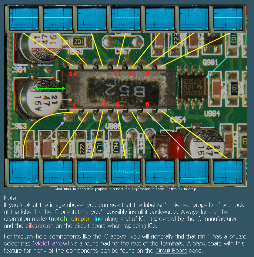

The line marks the pin 1/8 end. The cutout in the silkscreen is another indicator for this board. Also see the marks in the other image.
