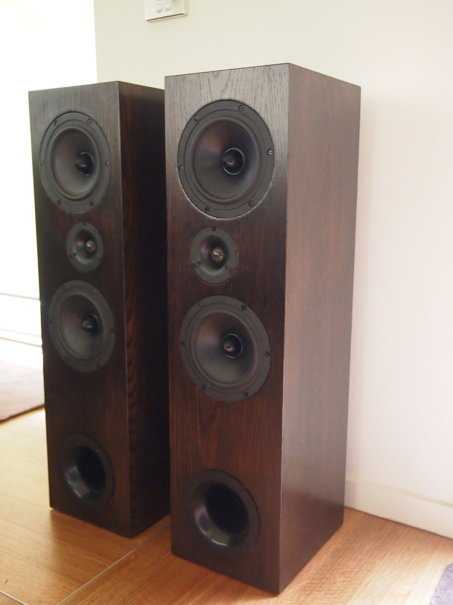

I've used it in some PA speakers I built and also in a two sealed design called Ergo IX bya guy named James from down under. https://pinkfishmedia.net/forum/thr...-e-ix-mini-monitor-loudspeaker-system.112821/ , It also uses a Scanspeak 15W8530-K01.
It sounded great in both applications. I really like these speakers a lot. As a rule, I have always liked Morel domes, have used a number of them over the years, and the CAT378 is no excepetion. One of the benefits that is easy to miss is that that the horn loading does not just act as a wave guide of sorts but sets the center of pressure back a bit from the baffle. That can help with good phase alignment between drivers if properly exploited by the crossover.

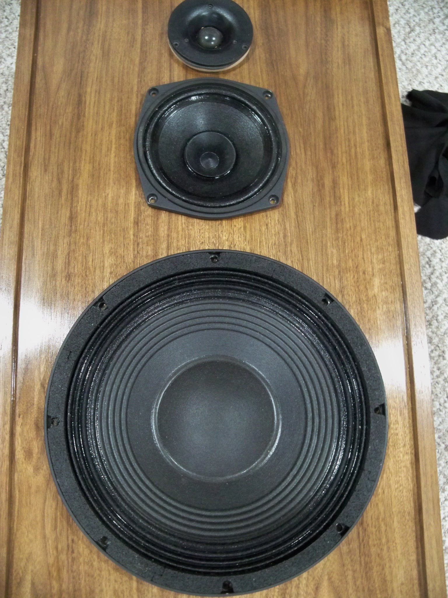

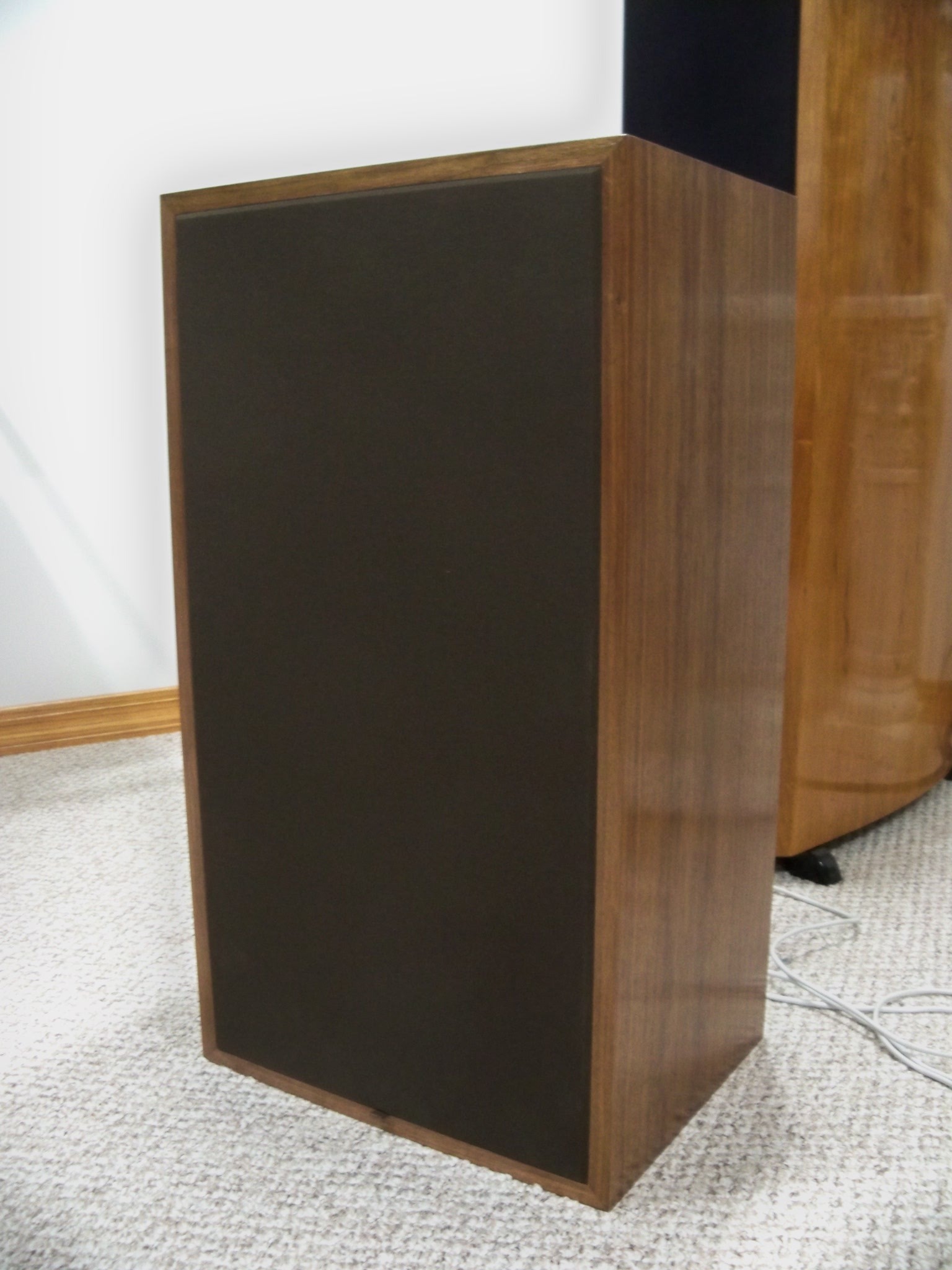

I used them in these, the tweeters are flush with the face of the grill, so they are meant to be listened to with the grills on and they are pretty well behaved, but I crossed them about 3K.

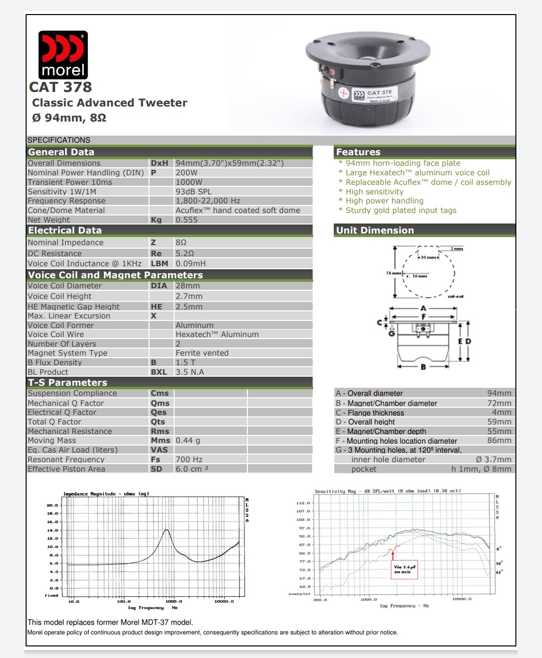

Has anyone used this tweeter? Seems a good budget waveguide offering.
Says can be used first order but at what crossover point?
It is an ancient design descended from Dynaudio D28. Solid piece of a product by the datasheet. I know member wintermute has one for a long time in an mtm ( midwoofers are also Morel's) design + sub so he might give you more information.
