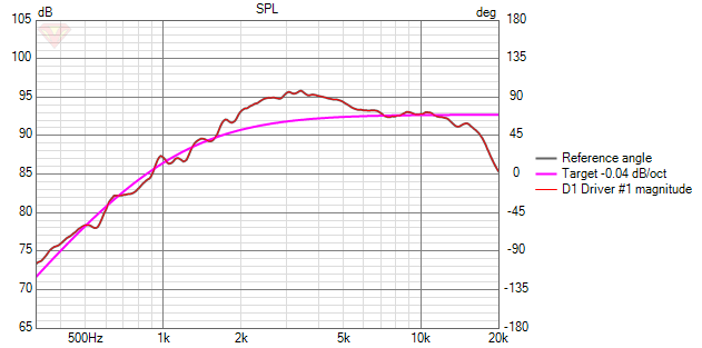

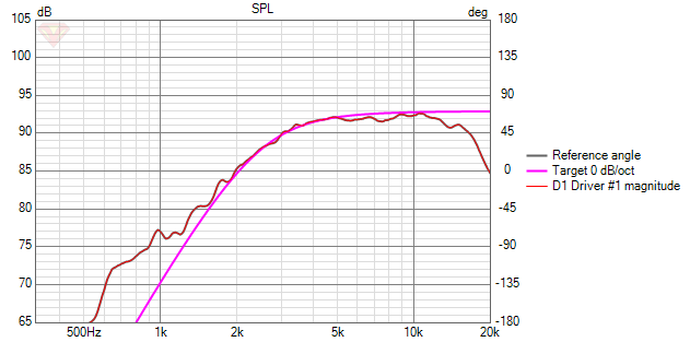

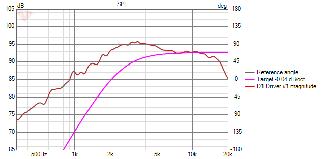

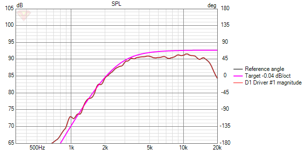

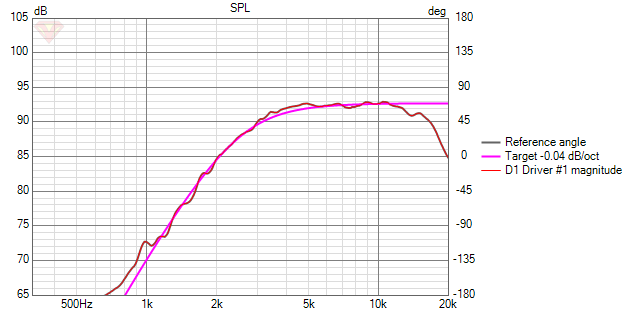

Based on simulation with traced graphs (not an actual measurement) the following is:
1. CAT378 raw response
2. with 5.6 uF cap
3. with 5.6 uF cap and LCR impedance peak EQ (1.1mH+39uF+10R)
4. as (3) plus CR Zobel linearization (1.8uF + 11R)
The target is a HP LR3 @2300 Hz, as it matches (3), and is the same on all graphs.
2. with 5.6 uF cap
No, LR3. As it turned out, that is what (3) comes closest to as a named slope. Not that it matters (that it must be a named slope) - but put there just for a reference.

I calculated the LCR conjugate at 1mH + 47uF + 10R. My methods are rough and ready, back of a beermat stuff sometimes.
But top marks to Draki for his sims. I would question if such a thing as LR3 really exists. But will let it go here. Never crossed my mind to use a Zobel.

Cat378 + 5.6uf, I would call it initially a 6db crossover.
Bob brines thought -6db at crossover, -12db an octave away would be enough for 6db time/phase aligned.
I know i don't shut up about it, but i see -6db at 2khz then -15db (almost -12db) at 1khz.
I'd call it close enough for a 6db time/phase aligned.

The final designed slope of a driver is a sum of its' inherent HP (or LP, or BP) slope plus whatever electrically added = acoustic slope.
This makes a realistic 6 dB acoustical slope very rare. For more elaborate information, see this white paper from KEF (pages 31 thru 36).
https://us.kef.com/pub/media/wysiwyg/documents/thereference/REF_White_Paper_preview_path_200514.pdf
The CAT378 discussed here has a raw response which resembles apx 1100 Hz LR2 HP slope (disregard the 2 to 6 KHz bump due to the waveguide loading).

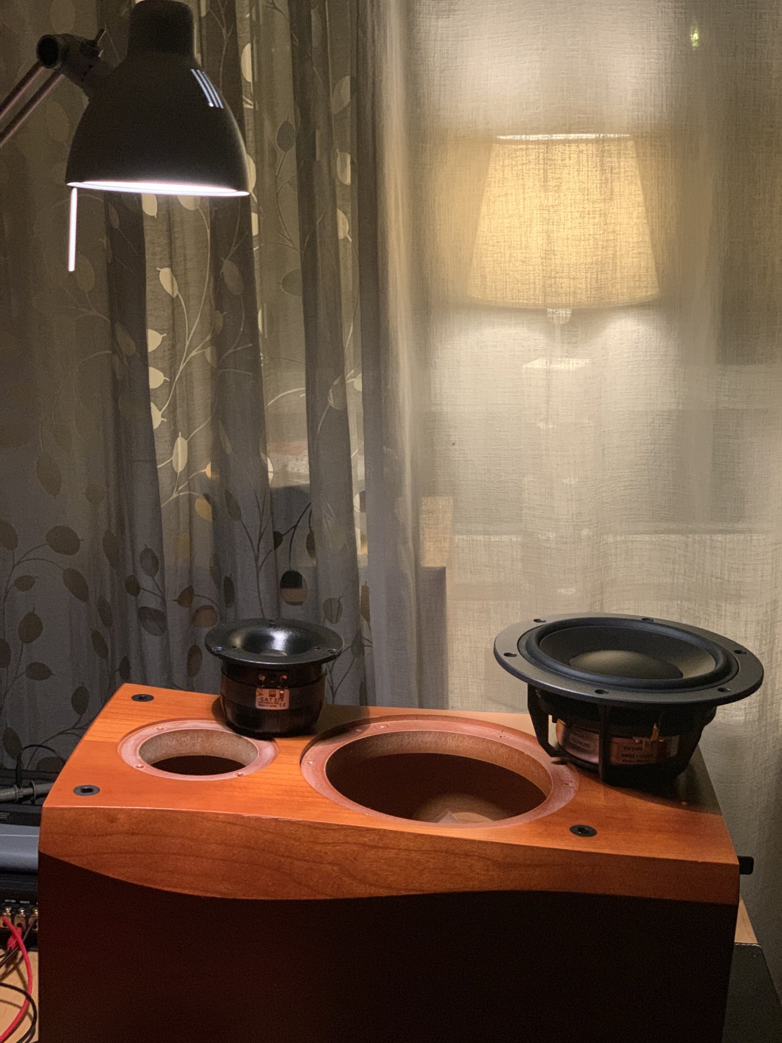

My paused Morel CAT 378 + Dynaudio Esotec MW 162 project. The crossover is not yet built, going to REW them to perfection and finish the build when my current Pass amp builds are ready to jazz, soul, rock, funk and blues🙂

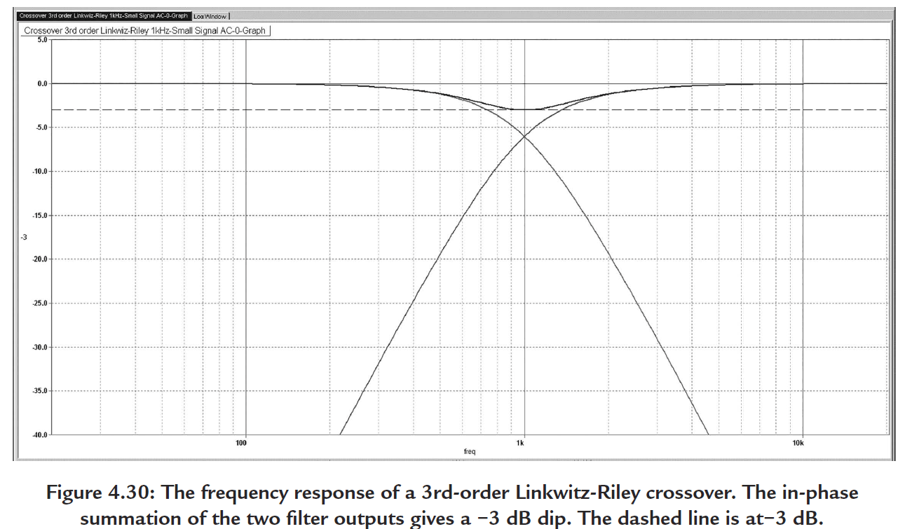

I thought the same thing, but found out it does exist. Unfortunately a LR3 will have a -3 dB dip at the crossover point. This graphic is from the book : "The Design of Active Crossovers" by Douglas Self.
Jon Marsh uses what he calls a quasi-LR3 quite a bit. It just has some characteristics of LR with 3rd order slopes.
