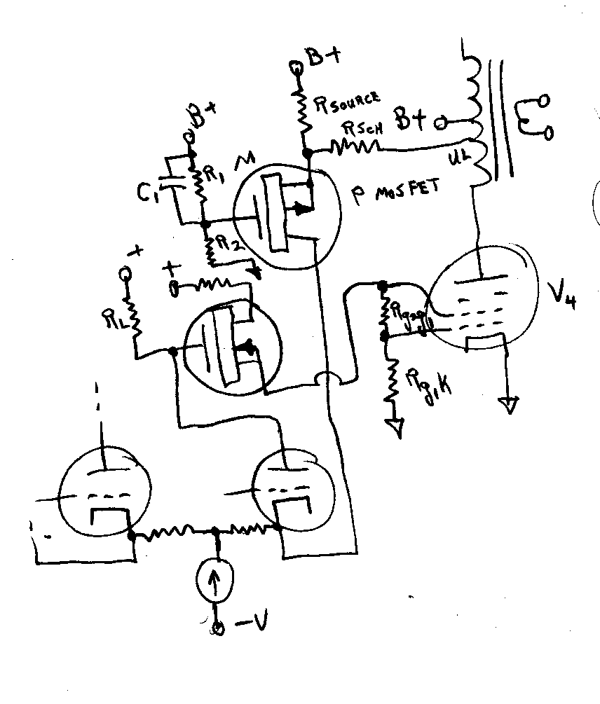

I assume you are meaning to use such a scheme for plate (or UL tap) to driver N Fdbk of some form.
Anything coming from the plate does have the issue of being referenced to B+, as far as actual output signal goes (so very poor PSRR). So if one gate is driven by a resistive divider from the plate, and the second gate is AC referenced to B+ (N and P channel Sources connected), that could remove the PSRR issue. But it does put two naked Mosfet gate V to I transfer functions into the critical N Fdbk loop. This is not going to set well with purists.
I think one would want to keep the mode of Mosfet(s) operation as a current in, to current out, transfer (unity transfer function). For that, only one P type Mosfet would be needed. A (Schade like) resistor from the plate to the P Mosfet Source terminal (possibly a divider R setup to B+, as seen below), and the gate AC referenced to B+. (the Gate, DC only, referenced to some convenient +V) That removes the B+ noise influence then, and allows Drain current coupling to the driver stage. (so still B+ voltage insensitive) The Mosfet Drain would then couple to the driver plate. (similar to the Wavebourne diagram below, except driver tube plate connected to the Mosfet Drain instead. With two current sources connected together at the output tube grid, some impedance lowering R is needed, or use a triode driver, or a servo for DC bias control.)
One could flip this around to use an N Mosfet, with gate AC referenced to B+, the Schade R to a Source divider R.

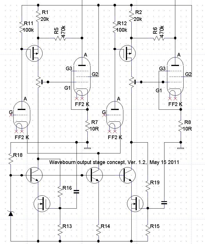

Then, Wavebourne has a Schade /Mosfet scheme using a P channel Mosfet, see below. It does put one Mosfet gate V to I function in the N Fdbk and forward signal path. (essentially, the P Mosfet becomes the driver stage here)

Thank you smoking-amp; that has certainly given me a lot to think about. I have followed your "crazy-drive" posts with utter fascination. In the UK, we don't have the kind of sweep tubes which seem to work best with this scheme-the only common one is EL36/6CM5 (which I think probably would be suitable for lowish power); the Russian ones are easy to get but the one you tested, 6P41S, didn't seem to my eyes to be particularly suitable. Is this simply a matter of the grid exponents?

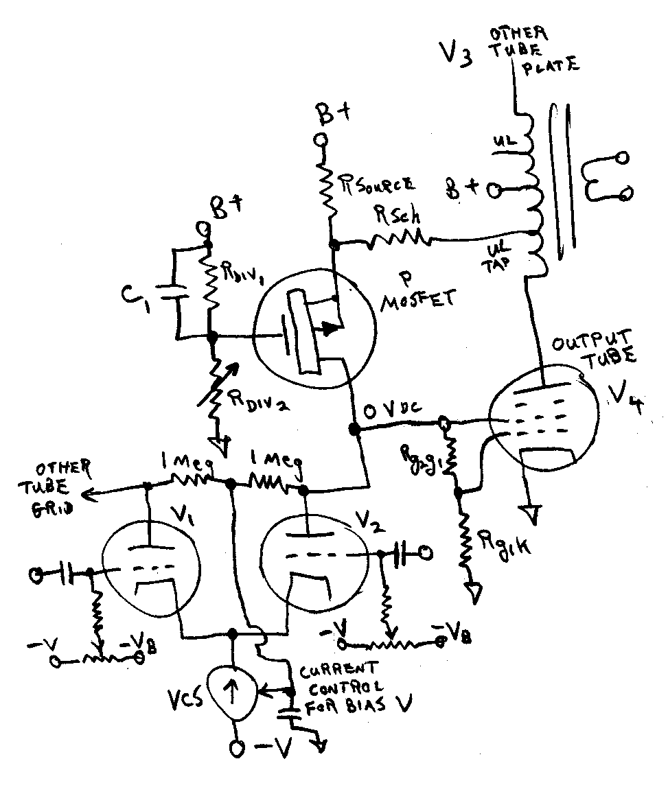

Here is a better description of what I had in mind. No doubt some improvements could be found for DC biasing. This would preserve unity current gain through the Mosfet(s), so should be more acceptable to purists. And the loop gain could be programmable via a loading resistor on the drain/driver_plate. (mainly for pentode drivers) Also showing Twin/Crazy drive of the output tubes too (just Rg2g1 and Rg1k).

smoking-amp, now that I think I understand the circuit details a couple more questions:
are triodes really capable of driving the grids with low distortion?
the cathode and Rg1k connect to a relatively low voltage negative supply? does this supply need to be variable?

"are triodes really capable of driving the grids with low distortion?"
One might want to put a follower in there for triode drivers. Rg2g1 and Rg1k in series, plus the g2 impedance in parallel would be the load. The g2 impedance certainly is not constant. With only a (Mosfet) follower gate to drive, the gain could be enormous for a pentode driver (maybe add a load R there).
"the cathode and Rg1k connect to a relatively low voltage negative supply? does this supply need to be variable?"
Cathode and Rg1k connect to 0V or ground. And the g2 idle voltage would be 0V also. (but going positive for signals) The driver stage (or CCS/VCS tail) needs to operate from -V on its cathodes to achieve that at its plate.

The present unity current gain Mosfet in the N Fdbk path (to eliminate PSRR issues) could be configured to send it's current down to the cathodes of the differential driver stage. Then use followers for the driver plates. This would put a lot more gain in the "local" N Fdbk loop. (lowering amplifier output Z considerably) That would linearize the driver stage too. (VCS Bias servo not shown, could be similar to the earlier version. Output g2 idles at 0V.)
Note: One little issue with these circuits so far: pull a driver tube out and the output tube fries! May want to make the 0V (g2) idle servo as a separate SS circuit, instead of using the driver.

Ah yes, I see; because every single amp I've ever built has been class A, I wasn't thinking of the g2-k idle voltage being zero.
I'd wondered before how best to send feedback to the cathodes of a differential pair; your mosfet configuration is really neat for this!

That earlier Wavebourne Schade schematic could avoid the output tube frying issue (when a driver tube is pulled; shown below again, some mod needed). But the P Mosfet is essentially the driver stage, so it's really a Hybrid design. If one is OK with that, it should work well (although, I'm not convinced how stable that output bias is if the Mosfet heats up, some additional mods in order I think). Only one Mosfet, and it does all 3 things elegantly (Fdbk, buffer, driver), hard to ignore. Hats off to Anatoly!
