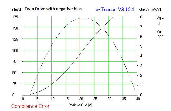

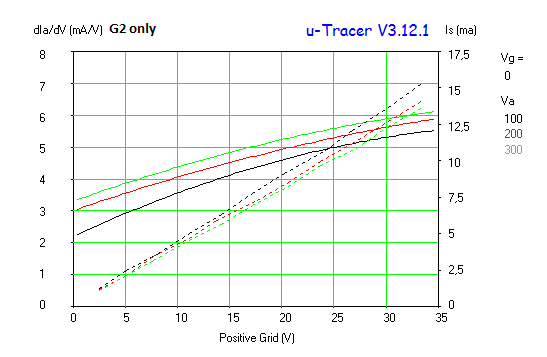

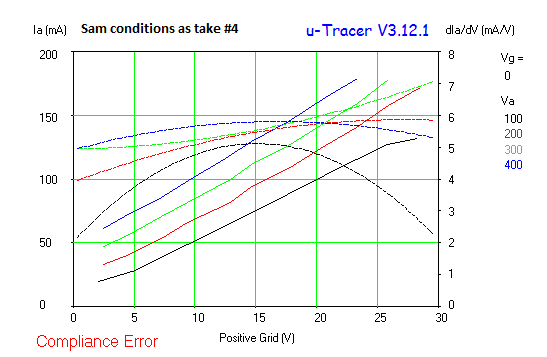

Here are some similar pics for the 26LX6 but:
a) 17V heater, Twin drive (like before except low htr V)
b) 26V heater, g1 drive, 90V on g2
c) 26V heater, g2 only drive, 7 V steps
As you can see, reduced heater V causes the transfer to roll over some (a lot at even lower heater V)
g1 drive has a strong curvature upwards from strong gm variation
and the g2 curve has slight upward curvature from weak gm variation
(maybe just lower the heater V on the PL509 to straighten it out, only working if enough max current achievable though.)
Wow, very linear, in fact, this post #832 graph!

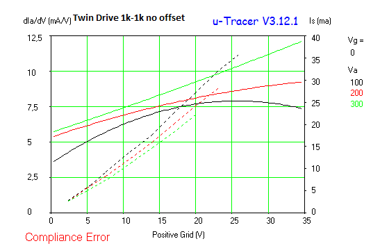

Here is the 26LX6 in Twin drive again, but with only g1 driven through the usual R divider, g2 is set at a fixed 27V. So showing the compensation effects from the g1 portion of Twin drive.

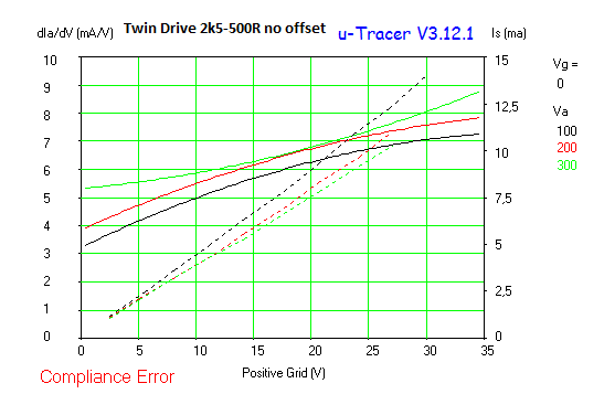

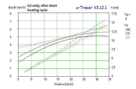

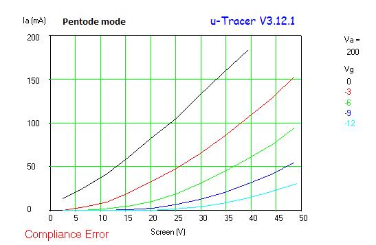

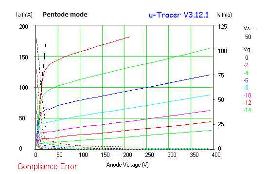

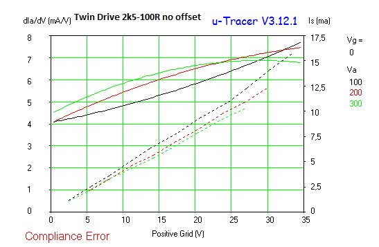

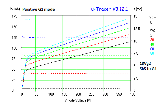

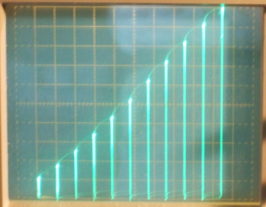

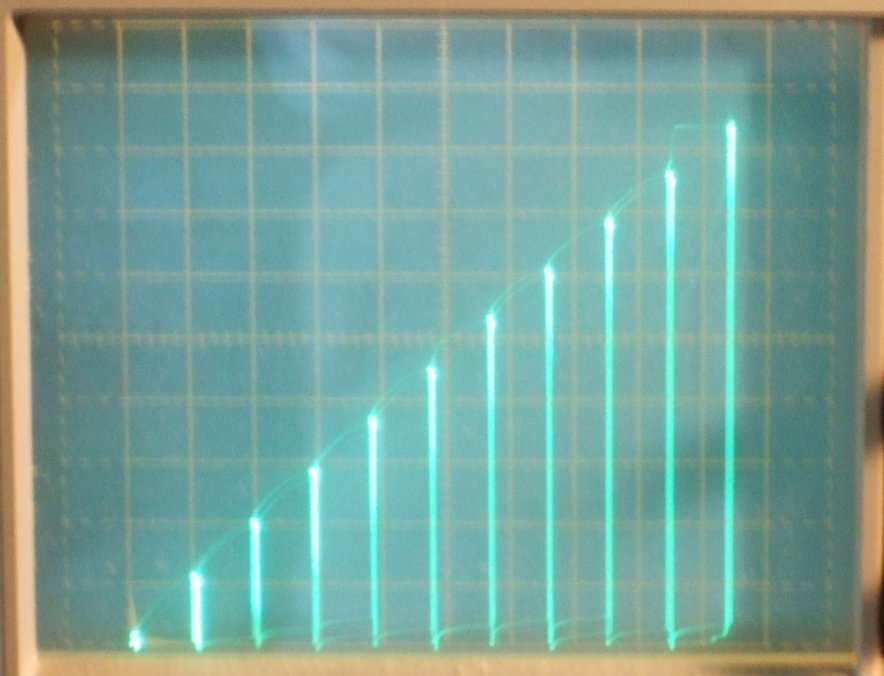

Optimization time...
Some steps, comparing G2 only, positive G1 and pentode mode

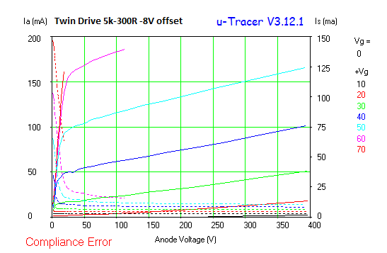

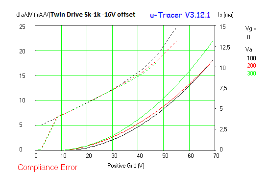

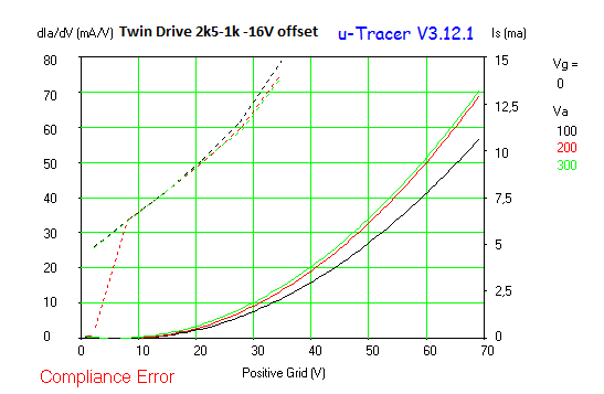

Last plots...

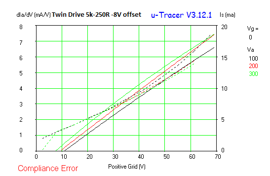

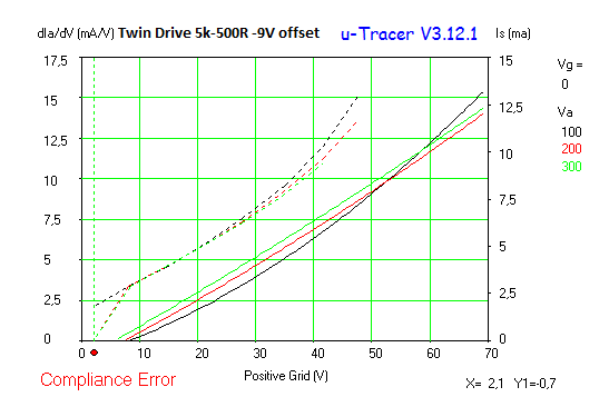

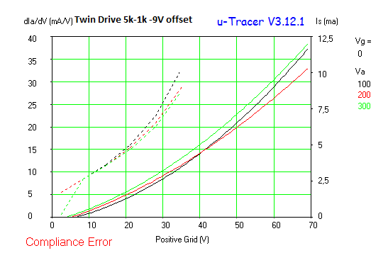

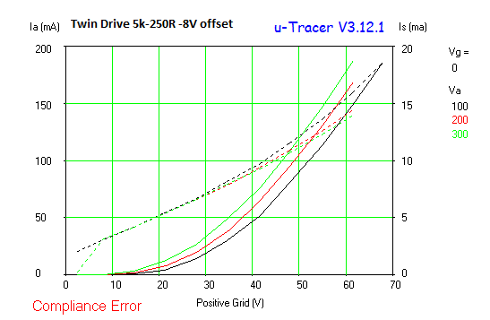

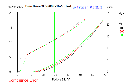

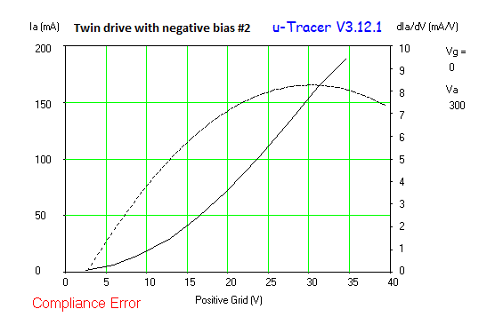

Now showing the steps including a offset in the end of G1 resistor.
If the µTracer is not playing tricks (instability), the -8V offset with 5k:250R is scary linear for a "semi-remote cut-off" tube like PL509 😛😀 and the resulting Ia/Va with varying drive is far more impressive than the original pentode curves
re: Lingwendil
Any negative rail would need to be adjustable, including down to zero V. The grid 1 compensation effects depend on grid 1 current draw. So nominally the R divider would just go to the cathode. The reason for some V offset is to correct for any internal tube thermo-electric potentials, from dissimilar metal joints in the lead wiring at high temp. (or to get additional non-linear compensation effects)
12AV5GA, OK. There were some Crazy/Twin drive curves and R values for the similar 6/12BQ6GA somewhere here. Starting back around post 464.
re: DIYBras
I was thinking about the plate current versus drive voltage curves (bars actually) shown on the curve tracer here, and realized that we are not looking at the same thing. Your tracer is plotting the results for a given plate V, or multiple V's. The tracer here is actually plotting the results (the peaks of the visible bars) along a load line of 650 Ohms. That's the current limiting resistor in this tracer for that Wattage/Voltage scale. So, reverting to a conventional plate curve graphic (plate I and V versus drive), those peaks are the ENDS of the plate curves when they hit the current limiting line.
The peak plate I versus drive V graphic here is still use-able, but it's just showing results for that specific load line. I need to install some banana plugs on the tracer so I can alter the limiting resistor to emulate other specific load lines. The present 650 Ohms would be equivalent to a 2600 Ohm P to P OT, so at least is in the practical range. But I would like to be able to do other OTs. (like 3300, 4000, 5000 etc.)
It IS interesting however that I am able to tweak the divider R values to get a linear response along that specific load line. The conventional plate I and V graphic versus drive V curves are not impacted, but they are just eye-balled as to linearity when adjusting the R divider values.

Umm, hmmm.
I just noticed that you got the --gm-- to conform to a linear ramp (using 5K:250 -8V offset), not the plate I.
So you have configured the tube to be a square law device! (HV Mosfet)
Gm should end up constant. (so plate current linear ramping versus drive V) That may not be possible with a constant plate V however, I don't know yet. But it does look quite possible along a practical load R line. (at least for 650 Ohms)
Some way to measure results along a fixed R load line there?
Square law

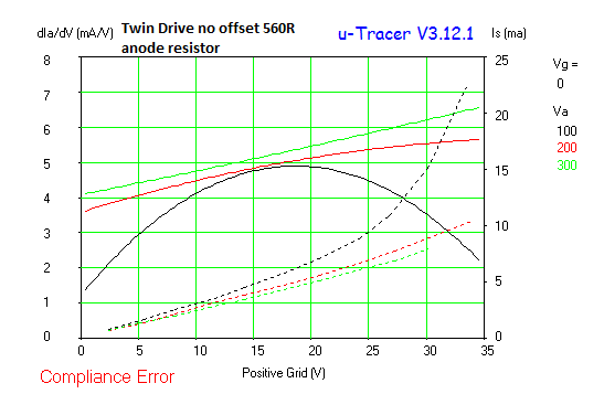

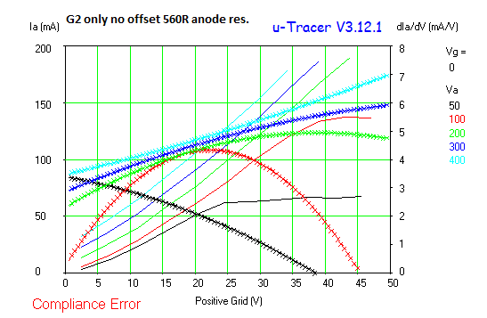

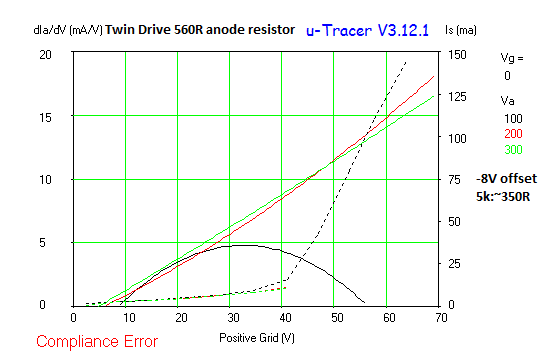

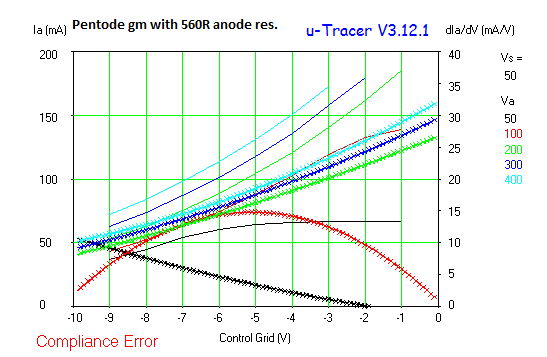

A try with anode series resistor...
I put a 560R anode series resistor for emulating a load and see if this change the gm readings
Here is the results
Of course, tracer measurings not include the direct anode readings, since the resistor are "external" to it, ie. now is a part of anode. So with low anode voltages and high current, the tracer saturates, due to high drop in 560R resistor. And results in a curved gm trace.
One more time, I'm unable to achieve a constant-gm, but is easy to tune "perfect" square-law.
I thinkering about the linear gm: if a device has a constant eg. 5mA/V, ie., 5mA/V with 10mA and 100mA anode, this will lead to a conclusion: with very low anode currents, is impossible to sustain the 5mA/V, since we cannot have a transconductance with zero current (or power with zero ohms exists 😛😀😉🙂). So at some low current, gm will change, and leaves the constant (maybe the ideal point to put the idle current). In contrast, the "square-law" will be continuously changing gm with anode current, more or less like I expect from a real device (since almost all varies gm to some extent), but with a advantage to obeying a definite/constant law.
Probably a lack of sufficient offset will mask the very low current region, appearing to have gm here, in a real constant-gm.
Second though, I can imagine (but I can be wrong here, and missing something) that the tuning process only can "travel" between the G2 law and pentode law, so I have no idea how the constant-gm can be achieved (so I confess that I need to read all again to understand the constant-gm process). I assume the G2 law being the low exponent one and the pentode the high exponent one, and the square law being between that. All of this at "gm-graph-optics", of course...😉
Here is the results

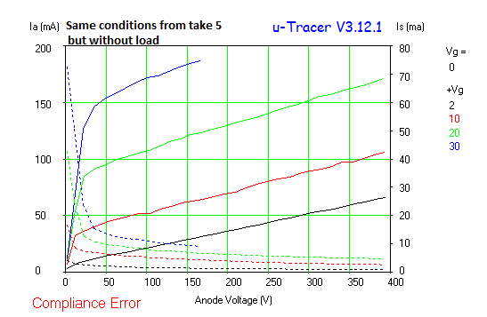

Hmmm, maybe I also check these plate current vs V input drive graph before attempting to straighen the gm graph 😱😀Umm, hmmm.
Because... in the one of firsts graphs, the "Crazy Drive 3k9:1k" shows a almost ruler-flat 300V anode current vs input step voltage, but gm is a curve. maybe this procedure straighen or maybe accentuates the gm curve, who knows...
"that the tuning process only can "travel" between the G2 law and pentode law, so I have no idea how the constant-gm can be achieved"
If both grid drives were by voltage mode, that would be true, but grid 1 is driven by an impedance, more like a current drive. (the Rg2g1) Being driven positive, it collects some current, and increasingly so. So that the g1 current drive becomes LESS effective at higher cathode current (unlike 3/2 or square law). This results in something more like a SQRT transfer function, for use as compensation of the g2 3/2 power law. (See below: The g1 function only, using the Twin drive setup.)
I switched the current limit on the tracer here to the 220 Watt scale (but reduced max V), which then uses a 140 Ohm load resistor. The previously straight plate current ramp versus drive V (at 650 Ohm load) then became slightly curved up, like for g2 only drive. I am unable to straighten it out by adjusting the pots, so looks like gm can NOT be made constant with constant plate V. That would be a vertical load line on conventional plate curves, so not a realistic application fortunately. I think the (internal) Mu of the tube limits the correction range of a current driven g1 (at the low current end), since it can only increase the total gm up till it hits the native (Mu x gm2) value.
A Square Law device requires class A operation to linearize in P-P, as you mentioned. So is of limited application. The constant gm device (at least for a load line) can run P-P in class B. Achieving a smooth class aB crossover would be problematic if the constant gm held all the way down to zero plate current. (the gm doubling issue for any conduction overlap) But, fortunately, the g2 gm drops out toward zero plate current in Twin drive (per 3/2 law derived), and the g1 is only able to maintain Mu (internal) times as much gm (as g2) at best, so it drops off eventually too. So compensation falling apart when g1 cannot fix g2 further, and so the total gm trailing off at low current. Making the smooth overlap possible that Mickeystan found around 16-20 mA idle for the 6DQ5.
In other words: Can look at the crossover region as where the low g2 gm has become in-effective from low current, but the g1 is still being driven by the (int.) Mu higher drive voltage of the HV driver stage. So it becomes a conventional g1 type crossover once the input signal drops 1/Mu below the usual V range. (for crossover of a g1 driven amp) It just becomes a conventional g1 driven amp then, but with a driver stage that has (int.) Mu higher V gain.
Makes perfect sense now! 🙂) Yes, I missed something 🙄😀 ) Thanks for the explanations

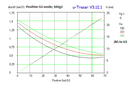

The reducing gm also occurs in my "Positive G1 mode; 16Vg2 - 2k5 to G1" graph; the gm is reducing towards higher anode currents.
So basically more playing with the negative "extra" bias, and maybe a retouch to resistive divider, will led to the desired exponent combination, if tube permits (regarding cut-off), with anode resistor.

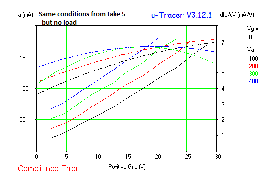

I just tried a lower Wattage scale on the tracer, 10 Watt with a 3K Ohm limiting R in the tracer, and I was able to linearize the transfer again. Looking good. However, a different Rg2g1 etc for a different load R.
Hmmm, Mickeystan's amp is using a 6.6K Ohm P-P OT I think. While the Twin compensation derived here for the 6DQ5 was for a 2.6K Ohm P to P OT effectively (4 x 650). So his R divider setup may be further improve-able yet.

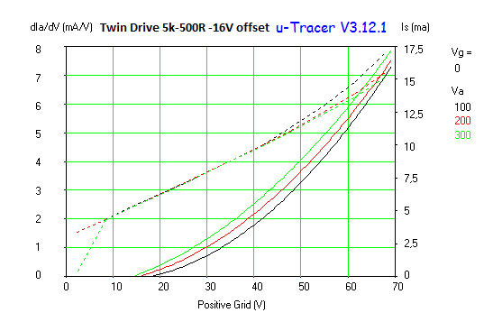

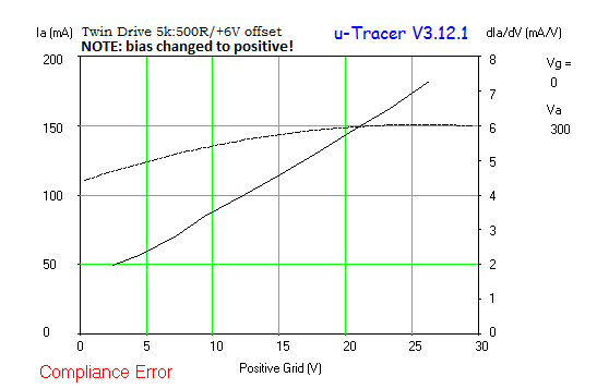

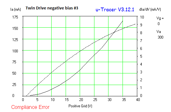

More testings...
With negative extra biasing for G1, I'm unable to achieve linear Ia vs Twin Drive input voltage. when I changed to positive, ie. with G1 permanently sinking current, the tracer shows a very linear Ia/Vi ramp (4th graph)(excepting the measurement averaging errors from µTracer), albeit with not sooo linear gm, but far closer to a constant.
In this positive bias case, one needs a drive with capabilities to pull down all Twin Drive network, or better, to put a floating positive G1 bias, like a battery.
Since we have a node with permanent current, this manifests like a gm with zero bias, but in fact, the µTracer only source currents, so I cannot achieve negative driving at same positive graph.
And a additional problem to tune this is that since the µTracer takes time to measure points, one cannot tune on the fly; is one change at a time.
Well, very fun! But for now, I need to focus in some "unexpected" projects and work (unfortunately far more in work place...), so I take a "vacation" from tracer 😀🙂.

I think you will find that just conventional grid 1 drive is fairly close to square law for TV Sweep tubes (and most higher gm tube types). Easier to drive too.
Might want to curve trace the PL509 for ramping gm using just grid 1.
That Square Law effect comes from grid1 wires to cathode local proximity effects, modifying the textbook 3/2 law. Grid 2 on the other hand is usually close to 3/2 power law. Low gm tubes with greater grid1 to cathode spacing, like some DHTs, can get closer to 3/2 power law on grid 1 (and plate), so can have quite constant Mu factors. UL and triode modded (higher gm) pentodes have considerable "roll-over" in their triode plate curves due to the power law mis-match.
I would love to find a means to fix the power law tracking for trioded pentodes and UL mode, but I haven't seen anything yet, except the equally non-linear load scheme used in the Aikido gain stage.
One can try to swamp out the square law of grid 1 by putting a 3/2 law thermionic diode under the cathode, but that lowers the Mu and raises Rp.
Another clever trick is using a negative Z load for a gain stage, which makes for a load line that tilts the other way, fixing the plate curve roll-over effectively. Typically using a positive feedback load bootstrap. No good for output stages though. But probably a good hint as to how to do it for a trioded pentode. Neg R or non-linear R needed somewhere, maybe the screen grid to plate connection.
Yes, I made it, in post#838: Ia/Vg tilts upwards and gm too. In this post, all graphs are in pentode mode. This resulting graphs shows a mixed law? (I ask since I have low experience to determine power laws)
My actual PL509 amp is operating at pentode mode albeit with some ~4% CFB.
Only in post#838, figure 7, the gm is a linear ramp (due to the #838 post you mentioned the square law), and it also caught my attention (if I don't confused things)
