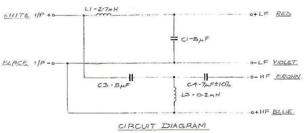

I've opened them up and taken a couple of photos and made a sketch of the crossover circuit, which has lead me on to two/three questions:
  1. I'm thinking I might just add some more resistance in series with the HF as a start to see if that helps re-balance the HF with the LF. Do you think it would be worthwhile replacing the electrolytics?
  2. What is the value of the second cap across the HF, one is marked 1.8k, the other 1.15j (see photos).
  3. Clearly MS are trying to tame this tweeter esp with the caps in parallel, but two caps??? Am I missing something here??? I triple checked it and that's definitely the layout???

I believe 1.15J means 1.15μF +/- 5% and 1.8K means 1.8μF +/- 10%.
Don't know why they have different values, must have been what MS had in stock at the time!
I can only suggest that the blue caps were parallelled up with the 0.47μF ones because a single cap of the required value was not available.
One combination adds to 1.62μF and the other 2.27μF. If replacing the parallel combinations, I'd probably go for single 2.2μF caps.
I think you could lose those shunt capacitors. Can't do any harm, though I'd have to model it to see how they work. Software | Visaton
I'd think the woofer sounds a bit peaky with a 10uF shunt, especially if the bass coil is small. Nothing stopping you turning the tweeter down with a bigger resistor. Every ohm you add takes it down a dB.
It's probably crying out for a better tweeter and bass circuit. Not much wrong with the treble filter apart from those awkward shunt capacitors.

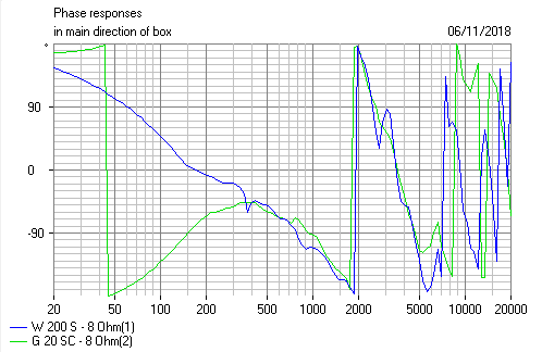

I have taken a REW measurement from 120Hz to 20KHz:
Looks to me like the midrange is running about 3db up?
Please do butt in with opinions, I'm not that experienced with these REW measurements either so I may be interpreting it wrong?

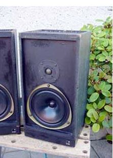

The 8" bass seems to be an old Dalesford DSB 208 paper unit:
stereonomono - Hi Fi Compendium: Mordaunt-Short DSB 208
Dalesford were more famous for some polypropylene basses back in the BBC heyday.
The tweeter looks like a mylar unit with a phase plate. Doesn't help much really. The crossover and tweeter is dubious IMO. 😀
We could be looking at voice-coil rubbing in a speaker this old. Turn the bass 90 degrees is the best quick fix, IMO.

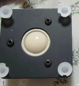

Think I've figured out what the tweeter is. An Isophon KK10/ca:
681186d1526561181-70th-anniversary-loudspeakers-briggs-mordaunt-short-pageant-jpg
This is the later Pageant 2, but looks familiar, eh?

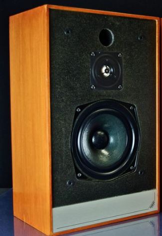

The Isophon KK8 was very popular in the 70's too, with an aluminium mounting plate:
296023d1344922933-ls3-5a-mini-monitor-clones-isophon_kk10-8_mylar-jpg

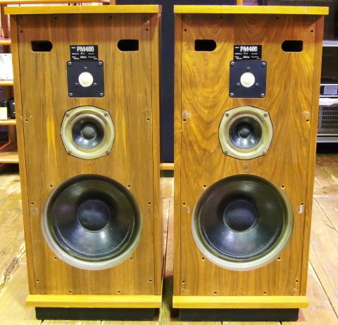

I had some in the Chartwell PM400, and they were very crisp sounding with a 0.5A fuse to protect them:
653422d1514487081-vifa-p13wh-00-08-original-specs-chartwell-pm400-monitor-jpg
Mylar or polycarbonate tends to brightness above 5kHz, so that is probably what the shunt capacitors are trying to fix in the tweeter filter.
DT 94 - 8 Ohm | Visaton

I was just looking at this Mordaunt Short MS40 circuit in Boxsim, and it is a bit of a disaster.... 😱
Third order tweeter, 2.2R, 3.3uF, Coil probably near 0.2mH, 5uF and this weird parallel shunt around 2-4uF.
Second order bass, coil and 10uF, probably peaky without some series resistance.
A much better way to tame the (bright?) tweeter is a Zobel next to it. 7.5R plus about 2.2uF in series. Impedance doesn't drop to 2.2R at high frequency. Which must be better for the amp, and still gives near 3dB attenuation at the top. I've done this sort of thing with the plastic Visaton DT94 and it works.

Are you planning on adding additional inductance at 0.4mH at a time?
It does work but you are wasting some energy in the added resistance. Some would say go for a low Resistance 1mm/1.2mm wire and 2.0mH as a bass inductor.
With your new LCR meter you can unwind the 2mH a few turns at a time after each test to get the optimum value of inductance. You will need to scrape of the lacquer to make a good connection and a good soldering iron and flux solder to re tin the ends each time. Take note of how much wire you remove so you can do the same thing to the other Inductor, once you are happy with the sound. You can build precision matched Inductors with the help of your meter.
Looking at Steve simulations which are not 100% guaranteed to match you driver he shows that 1.8mH or so should work with the 80s technology driver.
I have often found with older 8ohm drivers, once you get to trying a 2.2mH they will loose the plot sound wise, and often I end up around 1.6m- 2.0mH.

Also here are the results from this mornings playing about.
The placement tight to the wall is making a big difference to the bass, and helping out with the warmth alot. Still left sounding a taj hollow, and the tweeter is still a little too bright up top (for me, for this application). I'm supprised to see such a lift in the readings (+6db I recon), I can definatley hear a big jump, but thought that baffle step correction usually maxed out at about 6db and thats in an anochonic chamber?
Swapping the connections to the tweeter makes them sound odd, cant quite explain it, but I can clearly see on the REW plot.
New basline about 30cm or 1ft from side and rear walls
Tight to the side wall and 15cm, or 6" from rear wall
Original position, tweer connections reversed
These are good measurements, Adam. Sort of thing I get a bit lazy about... 😱
I have seen a lot to encourage some minor modifications. The woofer looks remarkably similar to my old predictable MA Elac unit. Magnet size, cone material, 26mm voicecoil diameter...
