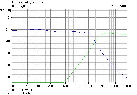

Now input your crossover and see how it works. I found that capacitor shunt on the tweeter wrecked high frequency impedance. The peaky bass at 3kHz is what happens with a small bass coil and a big shunt (10uF) capacitor. It interacts with the bass speaker which has a substantial inductance.
This is why online calculators are a bit rough and ready: 2-Way Crossover Calculator / Designer
You really need to use the DC resistance of the divers, usually 6 ohms, and impedance correction on the bass, which is 7.5R and 39uF for the high inductance W200S-8. to use these things. And bafflestep is not included.
Your basses will be lower inductance, I reckon. Online tweeter circuit calculations are often quite good and work very flat on impedance. You need Butterworth third order, 3kHz and 6 ohm here at a guess.

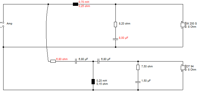

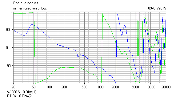

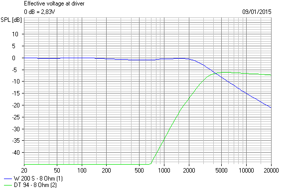

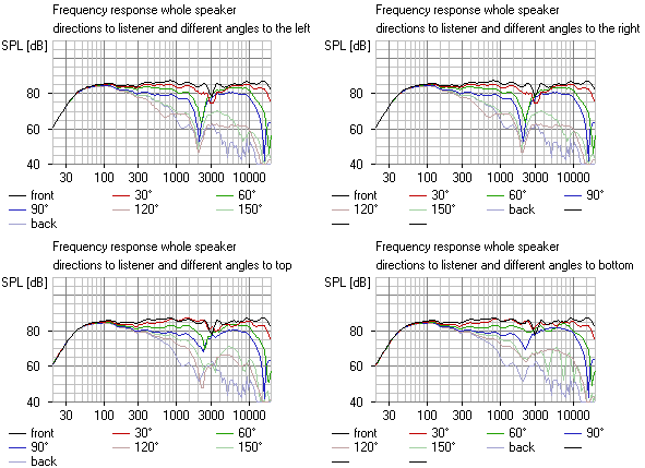

I just dug up an old BW3 build here along those lines:
458156d1420767119-fun-build-8-visaton-speaker-visaton-build-jpg
458158d1420767119-fun-build-8-visaton-speaker-visaton-bw3-crossover-png
458157d1420767119-fun-build-8-visaton-speaker-visaton-bw3-circuit-jpg
458159d1420767119-fun-build-8-visaton-speaker-visaton-bw3-dispersion-png
458161d1420767144-fun-build-8-visaton-speaker-visaton-bw3-electrical-response-png
458160d1420767144-fun-build-8-visaton-speaker-visaton-bw3-phase-png
It worked. I was experimenting with 90 degree phase alignment which can improve power response. 😀

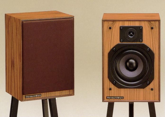

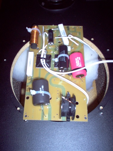

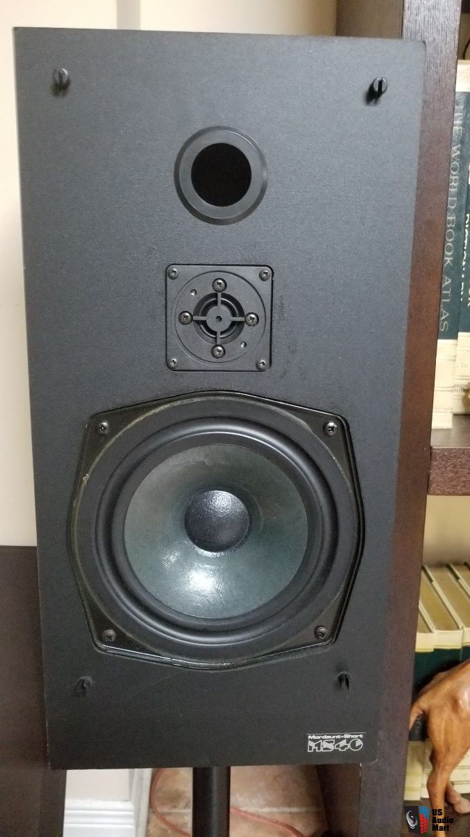

Martin Colloms once came up with a low-level step filter to correct the response of the MS100.
That filter applied to the small MS100 closed box speaker of the late 80s which belonged to the generation that followed the older and larger MS40 reflex loaded speaker which is the subject of this thread. The MS100 was certainly designed for close to wall mounting, and no doubt the earlier MS40 will also benefit from being so located.
I think this is the correct answer. MS speakers at that time were designed with no baffle step and were intended to be placed against the wall.

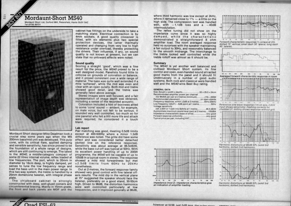

Adam, I've found a review of the MS40 in my 1985 edition of the Hi-Fi Choice Best Buy magazine.
Thank you Galu. Really interesting, especially as I'm getting some very similar measurements.
And amusingly as they seem to claim that the fuse and tweeter lever resistor are "two special protection devices, .... thermally operated and changing from very low to high resistance under overload"
Hahaha, some things don't change!

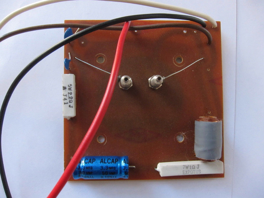

Your crossover board must pre-date MS's fitting of the 'Positec' protection devices.
The attachment shows two of them (top left) on the MS100 board.
They are best removed as they can become unreliable in operation.

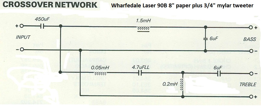

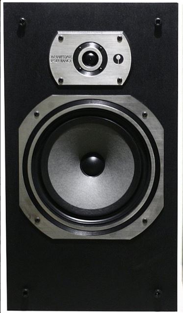

This is the Wharfedale Laser 90B:
680151d1526122842-wharfedale-shelton-xp2-minor-classic-imo-wharfedale-laser-90b-cabinet-jpg
680152d1526122842-wharfedale-shelton-xp2-minor-classic-imo-wharfedale-laser-90b-2-jpg
Another speaker full of interest and ideas. The 450uF electrolytic gets a bit more bass out of a 17L closed cabinet than you might expect. The 0.05mH coil just rolls off the mylar tweeter a bit. Otherwise reverse polarity 3rd order BBC style.
