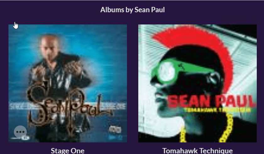

Hello all. I have Moode running on RPi with a NAS mounted directly in Moode (not UPNP) and all albums appearing and playing fine.
All albums show up in Moode with one album art icon and all the album tracks visible within. However a few albums have "featured artists" on some tracks. Those albums show up as multiple album art icons based on how many different featured artists there are on the album. I've tried everything I can see in the Library and Preferences section to fix that, but can't figure it out.
So how can I fix those albums with "featured artists" to just show up as one album in the album view like every other album appears.

Did you make any progress on this? I'm not sure if I had the same issue, but I did deal with my library being kind of a mess. What worked for me was running each album through MusicBrainz Picard and letting it tag everything. That cleaned up my library significantly.Hello all. I have Moode running on RPi with a NAS mounted directly in Moode (not UPNP) and all albums appearing and playing fine.

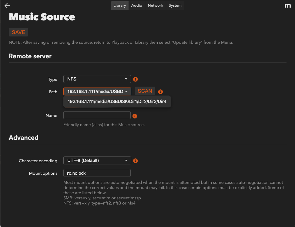

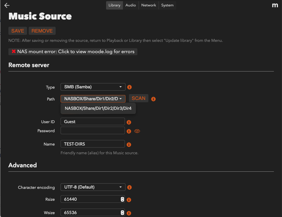

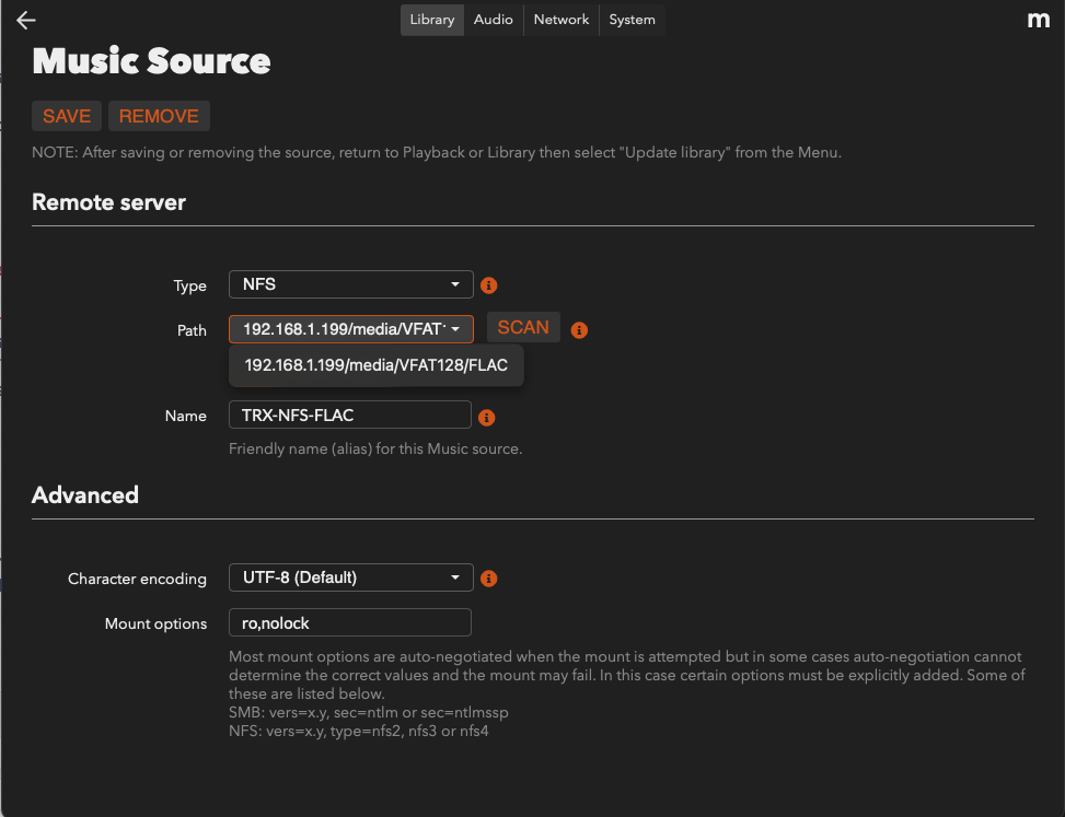

Hi all,
First off, Tim and other contributors, many thanks for making this excellent audio player available for public. Most appreciated.
I'm trying to map my NAS-based audio files in Moodeaudio but the NAS path (nfs/smb) is restricted to one level of folder hierarchy and max 64 chars.
Not sure whether this is a technical necessity or an arbitrary limitation. This is the first time I'm coming across with this type of restriction.
My NAS path is something like /Volume1/Multimedia/FlacAlbums, /Volume1/Multimedia/mp3Albums, /Volume1/Multimedia/DSDAlbums, etc
If I map just Volume1/Multimedia it will be a mess of different type of audio files. I wish to specify each type as a separate entry if possible.
Any clues? Thanks
Any clues? Thanks
Hi Tim, unless you are referring to something different (i.e., creating a config text file external to GUI) I cannot specify a nfs/smb music sources more than one folder level deep. To be more specific, I can create <NAS IP>/Multimedia but I cannot create <NAS IP>/Multimedia/FlacAlbums/Try creating three separate Music Source configs, one for each path.
