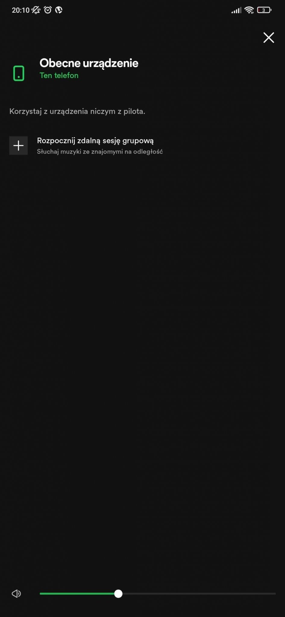

What exactly does this mean "I have a problem with connecting Spotify to moode"?
Also what audio device are you using?

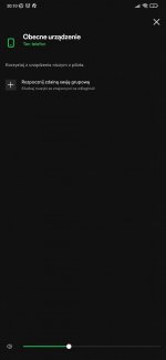

What I meant was I don't see moode in the list of devices on spotify connect (attached screen). Previously it was there.What exactly does this mean "I have a problem with connecting Spotify to moode"?
I am using Xiaomi mi9 12.5.2, Android 11RKQ1.200826.002.
Attached the startup log.
The log entries below indicate no audio device was found.

It could be some sort of network issue due to Router change or maybe something with your Spotify subscription. The account sub must be Spotify Premium level or it won't work with the Open Source Spotify renderer used in moOde.Thanks for looking into this, above log was when I run moode with DAC turned off, attached the same log with DAC turned on. Moode in general works on my setup, plays files from hard drive, in the past with exactly same DAC spotify worked. I changed the router some time ago, I can't pinpoint if this might have been the moment is stopped working (since usually I dont plan from spotify), but since my phone can connects to it (url) via this network, then I guess spotify also should.
20221119 065623 worker: ALSA cards: (0:b1 | 1:Headphones | 2:D50s | 3:empty 20221119 065623 worker: MPD config: (2:D50s | mixer:(Invalid card number.) | card:2) 20221119 065623 worker: ALSA mixer actual (D50s )
You could also try running the librespot launch string from the command line with debug (-v) and see if there are any useful error messages printed.
- Turn Spotify renderer OFF in the UI
- Run the command below
Code:
librespot -v --name "Moode Spotify" --bitrate 320 --format S16 --ap-port 13561 --mixer softvol --initial-volume 100 --volume-ctrl log --volume-range 60 --cache /var/local/www/spotify_cache --disable-audio-cache --backend alsa --device "_audioout" --onevent /var/local/www/commandw/spotevent.sh

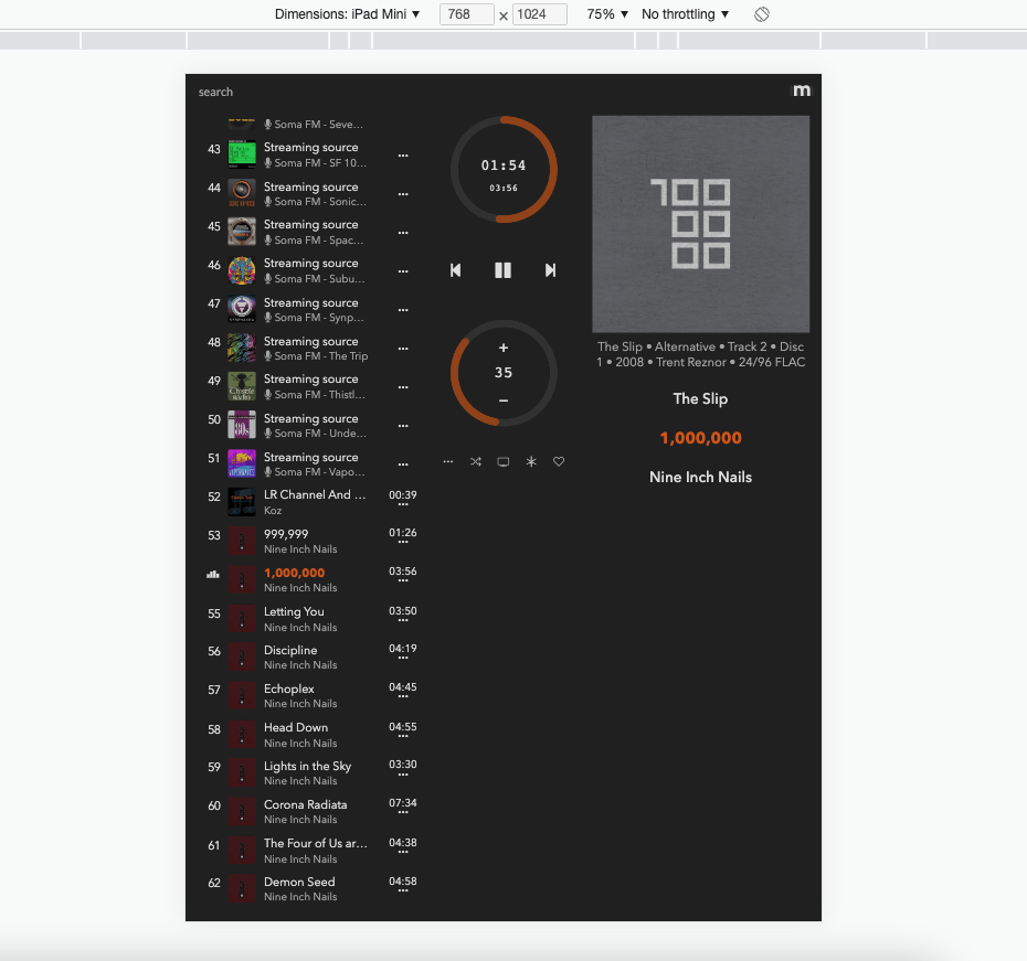

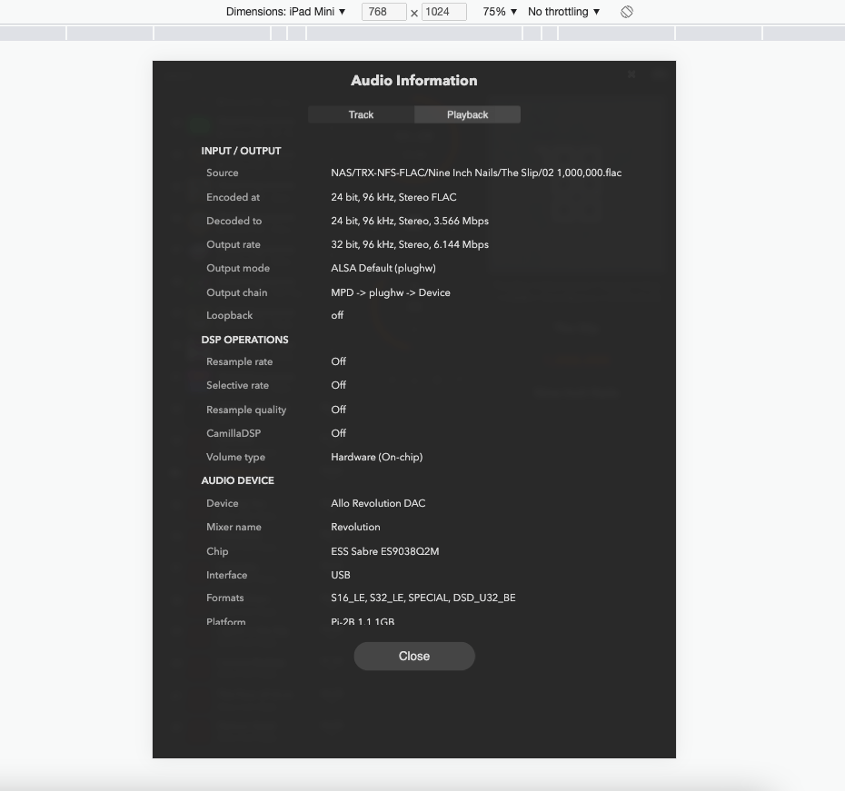

I installed Moode 8.2.2 (Legacy) on my Pi-2B a few days ago. Unfortunately I hear a pop or crack every 10 seconds or so when I play 24/96 material over a Musical Fidelity V90 dac.
From what I read the problem could be that 8.2.2 is not a good version for the Pi-2B.
Are there (recent) versions that are known to work well with the Pi-2B?
Can you provide link(s) for "From what I read" because I'm not experiencing any issues whatsoever with 24/96 format using a Pi-2B and USB DAC. Playback is glitch free.
Here's some screen shots and the startup log from my end. Maybe the glitches you are experiencing are due to your unique configuration or possibly an incompatibility with the USB chipset on that particular DAC.
If you would like to troubleshoot further then join or post on our Support Forum. Auto-registrations are closed so just email tim at moodeaudio dot org and I'll create an account for you.
Startup log
Startup log

Hi Tim, thanks for the reply!
Sorry, I don't find the source anymore. It was also not very specific to Moode or the Pi-2B, just multiple people who complained that they had to change the OS version on their Pi a few times to resolve pops/cracks.
Now I also tried a Pi-1, a different USB-stick, different wifi adapter and removed the powered USB-hub from the Pi-2B. To no effect.
Every time I heard the pops/cracks. They appear every 8.3 seconds when playing 24/96 through the Musical Fidelity V90 dac.
I will register on Moode support forum!
