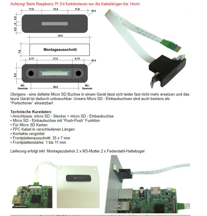

I have a question about the version jump from version 6 to 7.
This time I couldn't update via the webfront. I had to remove the SD card from the Raspberry [which is very cumbersome].
Is there a possibility that the SD card gets stuck and I copy the new image [* .iso] onto it in another way?
I fitted an adapter to my Pi so that I could easily access the card.
Cheap and effective
Micro SD Card Extender - 68cm long flex cable– The Pi Hut

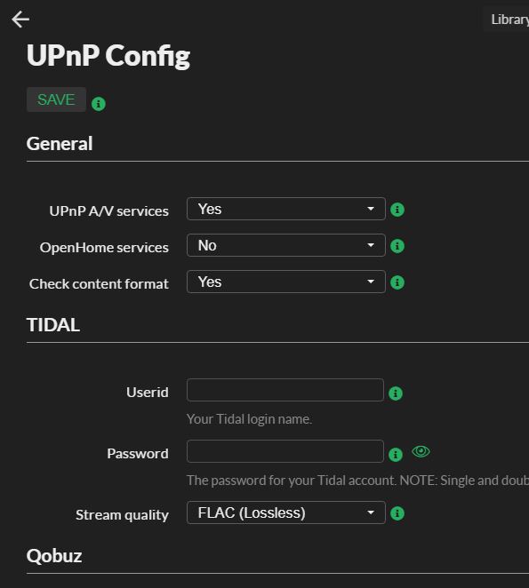

Thanks.I've tried it once and discarded it without success or didn't try to get it to work:
You have the Tidal app on a computer and then stream it to the moodeaudio player. That bothered me
Did I miss something or is there an easy way to Tidal access.
Use Moode's UPnP Renderer, and a 3rd party app such as mconnect HD, or BubbleUPnP.
The Tidal credentials are entered into the app, and it then directs the stream to the Renderer, however the stream does not (contrary to some popular flawed opinion) actually flow through the phone or tablet, it merely acts as a control point.
