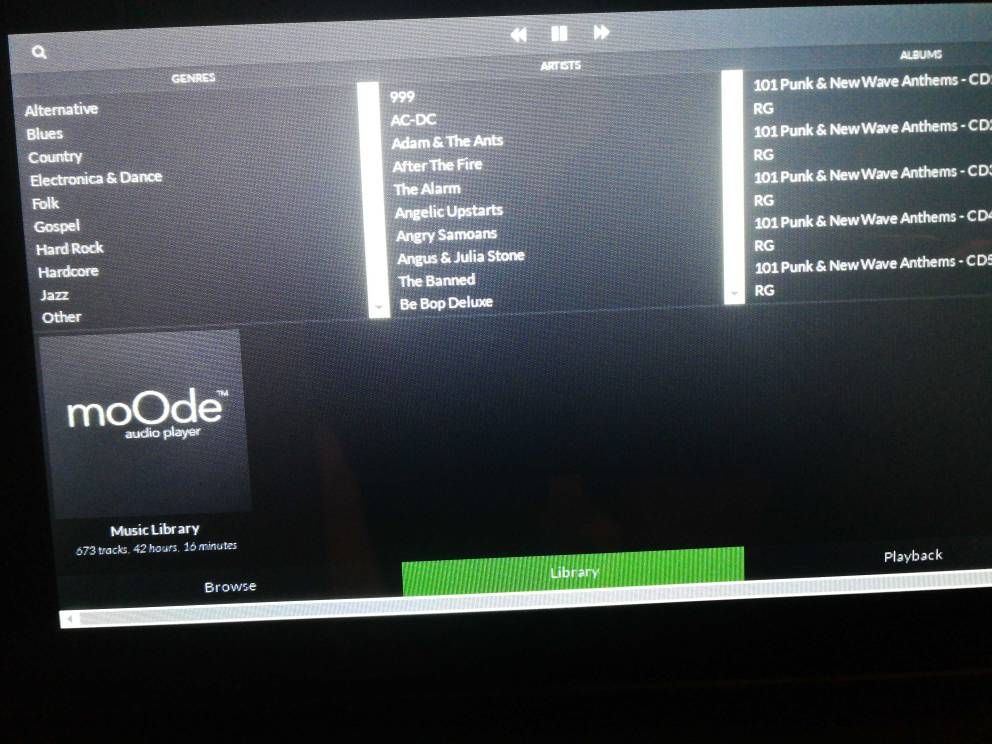

I now need to learn to use the UI [emoji41]. Is it the only library view possible? Or can I see album/artist photos? 1520014001004.jpg

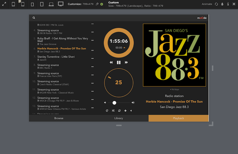

While waiting for some guidance on this issue:
http://www.diyaudio.com/forums/pc-based/271811-moode-audio-player-raspberry-pi-1413.html#post5356867
I've made some nice improvements to the volume controls by adding the up and down step buttons and the numeric volume setting for mobile :)
-Tim
Nice design choice Tim. Would you think the desktop version would benefit from a linear track progress bar rather than circular one. If you can move that under the album art similar to the mobile version, you can technically utilize that screen estate for something else. Just a thought.
