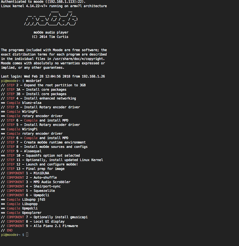

A minor nit: the Image Builder knows what release of moOde is being built (it's embedded in the rel-stretch-rxx.zip file name in the mosbuild.properties file which is downloaded by mosbuild.sh).
Could the builder echo the release tag to the mosbuild.log (and possibly to the mosbrief output as well) so we know up front what it's working on for the next hour or 3?
Kent
