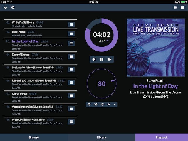

Moode Audio Player release 1.9 is available for download at tcmods.org :)
This release includes new Playback history log, UPnP album art display, on-demand help/info system, great new Radio stations and a variety of code updates, improvements and bug fixes inluding a major fix to miniDLNA server config. Refer to the release notes below and attached screen shots.
Highlights:
(1) The Playback history log provides type down search and each log item contains a Google search link for song/album/artist. The log is server-based so no need for the Player UI to be running.
(2) The UPnP album art feature provides display of album art from UPnP/DLNA servers thanks to some nice coding from Jean-Francois Dockes, author of the excellent upmpdcli UPnP renderer included in Moode.
(3) System and Playback history logs can be cleared via settings on System config page thus no need for ssh commands :)
(4) miniDLNA config fix prevents its folder tree from also being indexed by MPD causing N times the number of actual songs to be indexed.
Enjoy!

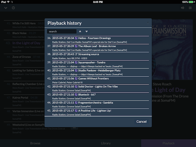

Hi Tim, I have been using the 1.9 release for 5 hours now listening to Folk UK. Wonderful as always.
Tried the Play History and get a drop-down box with 'search' in it. I have tried time, date, keywords, but get "0 items' for all...
Any hints as to how this works...:D
