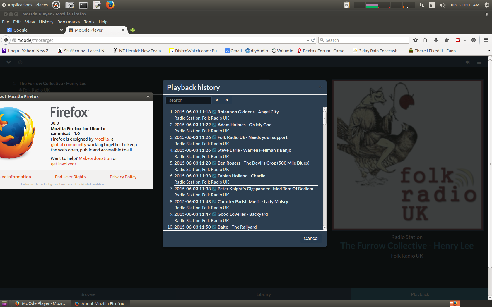

John, I am using Firefox 38.0 on Ubuntu and Playback History works fine...Hi Tim,
I am experiencing an issue with the Playback History Feature using Firefox 38.0 on Linux (Ubuntu).
The History window doesn't pop-up. In fact nothing happens at all.
Perhaps also related - In the Customize window I can't select Yes or No for History Logging.
Actually to be correct, I can Select these options but the option dialog stays blank after the Selection is made.
However, if I use Chrome from my Android Tablet, then the History Feature works perfectly - as does the Customize > Logging option.
This is not really an issue for me, but let me know if you need any log files, or output from the Firefox WebConsole if you wish to troubleshoot this issue.
John.
Maybe try with Firefox add-ons disabled to see if they are the problem..?

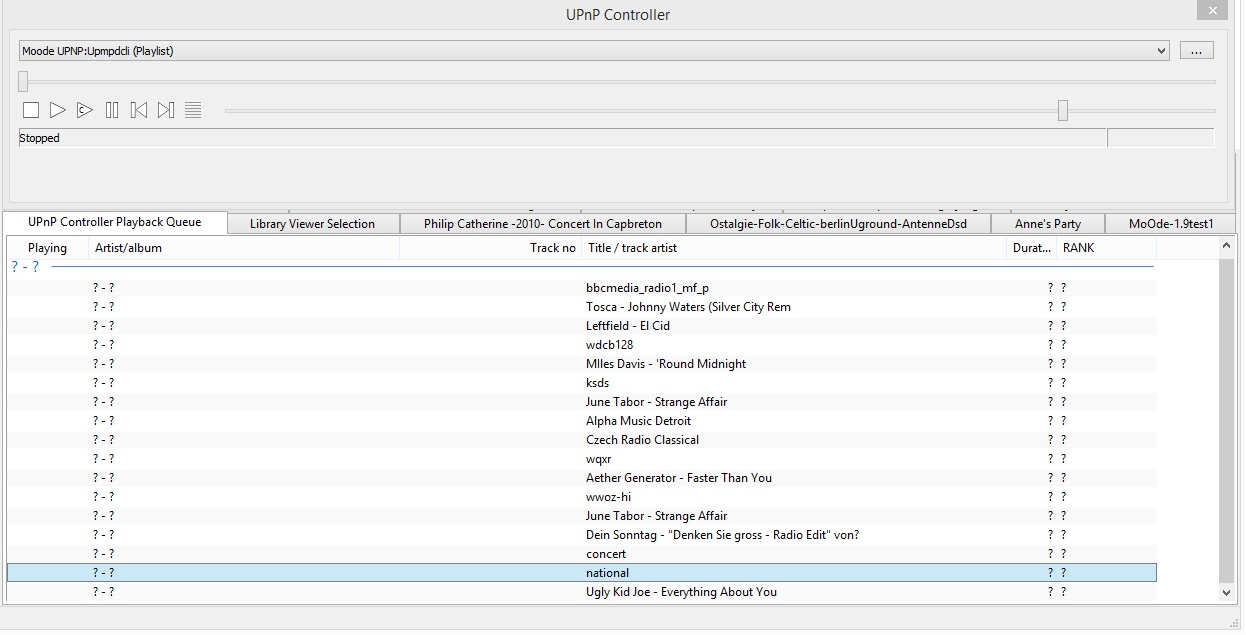

Hi! I`m very satisfied with the sound quality of moode-player. I´m using foobar (windows-laptop) as a server, bubbleUpnP on my tablet as controlpoint (but Idon´t need it, as I control everything through foobar) and moodeplayer as renderer. Is there a way to simplify this? It´s a little bothersome to use bubbleUpnP, it´s like an extra step. But without, I cant hear the stream. I wish to prepare moodeplayer in a way, that music starts just after foobar starts - without bubble Upnp. Is this possible?
Luki
Luki
Luki
Well, I have an almost identical setup, in addition I use UPnPlay occasionally as a controlpoint.
I don't have a problem in fully controlling MoOde solely from foobar2k (using the upnp-plugin)
View -> UPnP Controller (takes some time to populate): submitting a playlist (to Moode UPNP:Upmpdcli (Playlist),
changing volume, stopping, pauzing, resuming, muting, detaching as a controlpoint etc..
What function is it that you can't control directly from foobar2k?
(see attached)
Hi Silicium, thank you for your response. I´m at work now, when I´m back home, I`ll see.
Tot ziens
Luki
Tot ziens
Luki

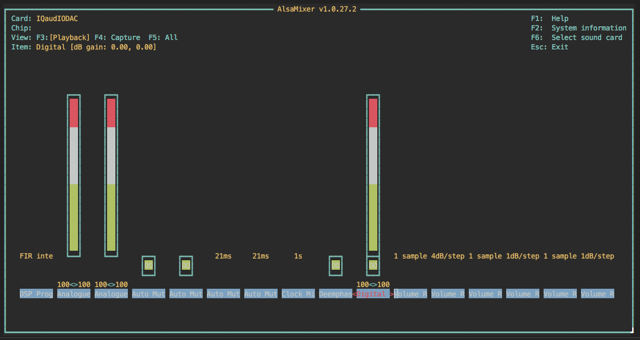

Here are a couple of troubleshooting steps that you can try from ssh session.
(1) Confirm that ALSA volume is not 0
alsamixer
(2) Try the module drivers instead of the device tree overlay driver. The overlay driver is configured by Moode when selecting Hifiberry Amp/Amp+
(a) In /boot/config.txt, remove this line
dtoverlay=hifiberry-amp
(b) In /etc/modules, add these lines. They should be the only lines in the file.
snd_soc_bcm2708
bcm2708_dmaengine
snd_soc_hifiberry_amp
(c) Reboot
TC
Hi Silicium,
now. at home, I tried this and tried that with foobar`s Upnp controller. All i got was something that sounds like played backward. My tablet was not active. I already knew this from using BubbleUpnp on my android tablet. There I can avoid this issue by opening the properties of the playback stream captures, tap on "Show metadata", tap on the link http://192.168.0.102:56923/content/...av?profile_id=0&convert=wav&samplerate=192000 - and everything is ok. I have no idea what´s going on there.
Luki
Luki
