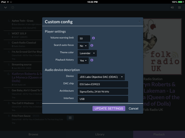

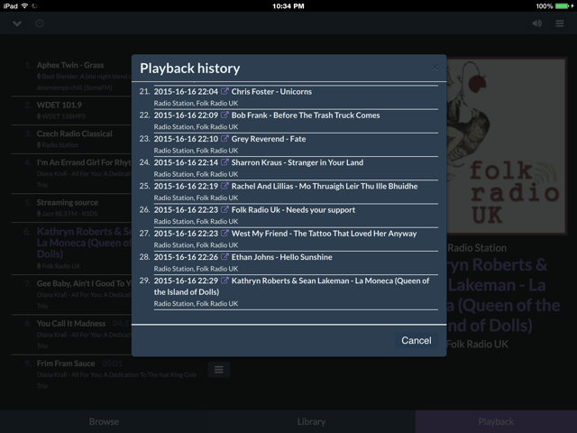

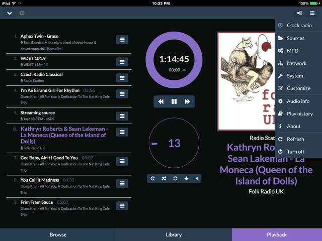

Some screen shots of Playback History feature coming in release 1.9 🙂

Thanks for the compliment!
The feature was almost as complex as Clock Radio to implement lol. The history engine is entirely server-based so the Player UI does not even need to be running 🙂 A type-down search on the History Viewer is the last part that needs to be coded.
