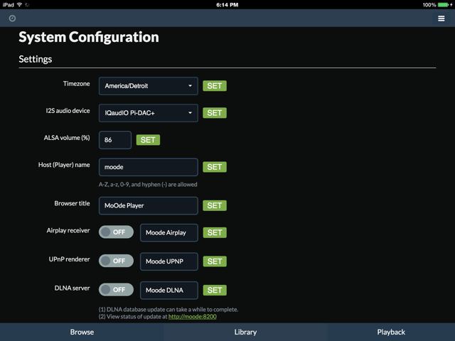

- NEW: Playback panel with integrated playlist
- NEW: Set Player and network media service names
- NEW: Set ALSA PCM volume level
- NEW: Select local timezone
- NEW: Choose Theme color from Customize popup
- NEW: Theme colors (Bluejeans, Fallenleaf, Grass, Herb, Lavender and Rose)

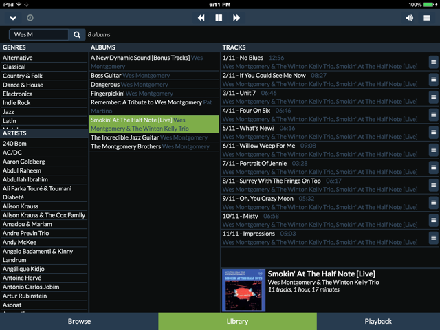

- UPD: Improve performance of Library for large collections
- UPD: Streamline layout of Sources, Network and System config pages
- UPD: Individual toolbars for each panel (Browse, Library and Playback)
- UPD: Userid and password fields on mount screen hidden when NFS selected
- UPD: Additional audio device descriptions (23 devices, 12 new)
- UPD: RaspyPlay4 added to I2S audio device selector
- UPD: Durio Sound PRO added to I2S audio device selector
- UPD: Add friendly names for DAC, ALSA and CODEC audio output on MPD config page
- UPD: Update old btn-cmd code in scripts-configuration.js
- UPD: Cover art default size increased to 600 x 600px
- UPD: Auto hide browser scrollbars on IE
- UPD: Add alias logo for NTS Live London radio station
- UPD: Mods to MiniDLNA conf file to enable functionality
- UPD: Add link in System config to MiniDLNA status page
- UPD: Add logic to handle metadata for UPnP song files

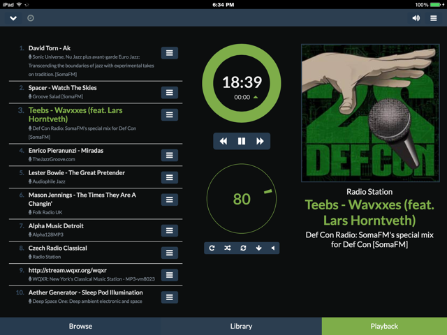

Excellent ! Love the new Playback tab, a lot easier to switch between streams.
Everything seems a tad snappier too. :)
Took me (quite !) a while to find the 'save playlist' option (Top left arrow on the Playback tab..toggle Hide/show toolbar and the option is at the bottom of the page)
May I suggest that the default be "show" rather than "hide" :)
Once you know it is there it is easy to hide for a clean interface but if you don't know where it is to start then it can be hard to discover.

and a quick 'save track info' from radio streams ? ;-)
for when you are working flat-out like a lizard drinking water and you hear something on a radio stream that you want to follow up...so hitting a button on the attached keyboard saves the track info to a file...;-)
Can do something now by grabbing phone activating wifi, connecting with chrome and taking a screenshot.....pant-puff-pant... but some one button keyboard hit would be fantastic..!
In fact what about a keyboard-control file using xbindkeys as an option for control ???
No pressure..:D
Cheers Bob
I have never actually connected a keyboard to a Raspberry Pi.
But I do have a "Playback history" feature on the to-do-at-some-point list. It would log the metadata for each song that has been played plus a google search link for the song.
When the history list is displayed, clicking on the song would bring up a Google search results page, same as what appears currently when clicking on the cover art. There would also need to be an Enable/disable switch, Clear history and History viewer
This would allow you to browse through the playback history at your leisure :)
How about something like that?
