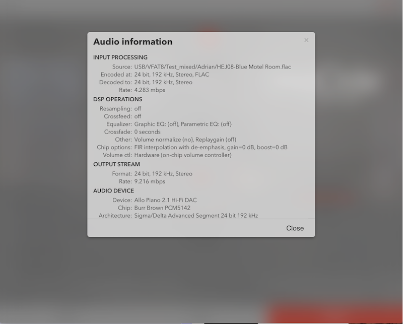

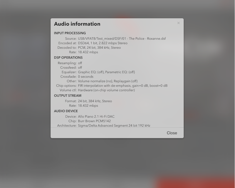

TIM, I have attached the screenshots of the various audio files with specified how it is reproduced.
For "rate" I wanted to say "output stream rate"
I hope everything is clear.
Thanks in advantage.
Garluk
Hi Garluk,
No issues on my end w/high bitrate files.
Maybe its a problem with the DAC board.
What I2S driver does the manufacturer recommend?
-Tim
