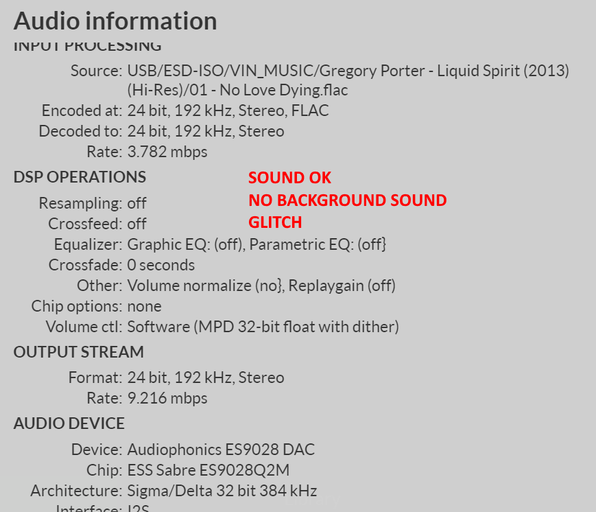

Garluk said:Originally Posted by Garluk View Post

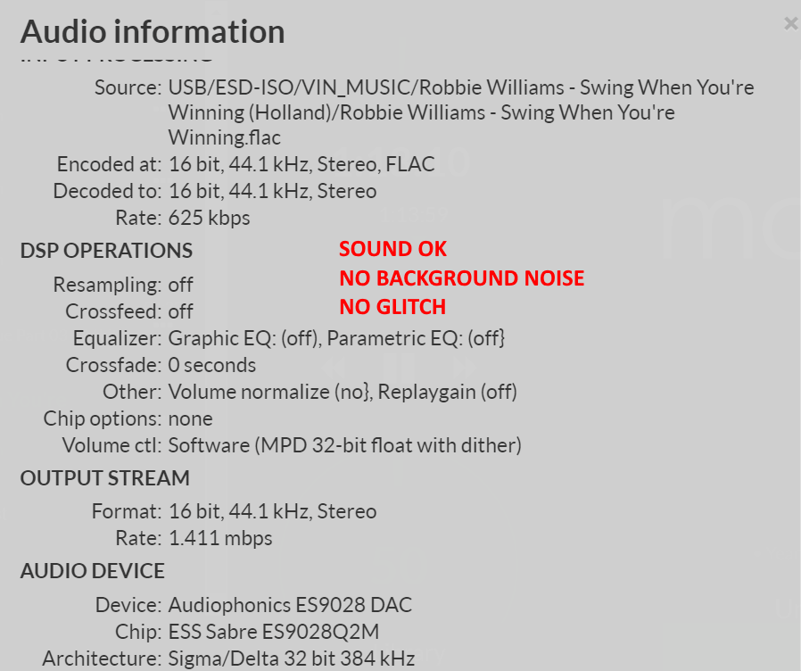

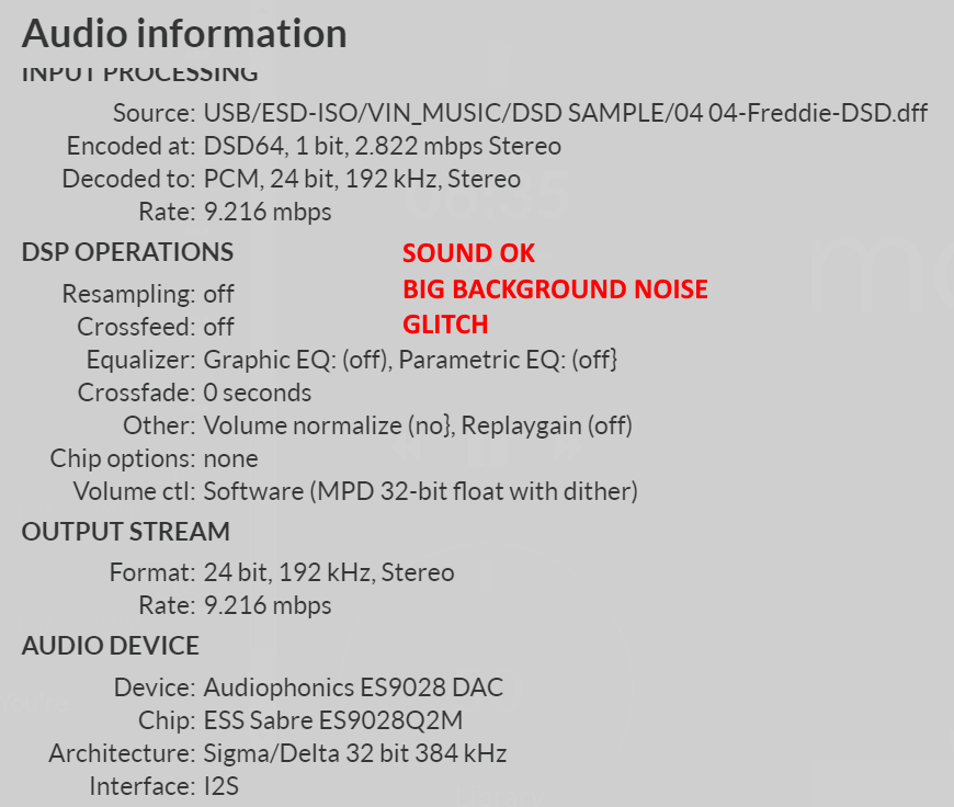

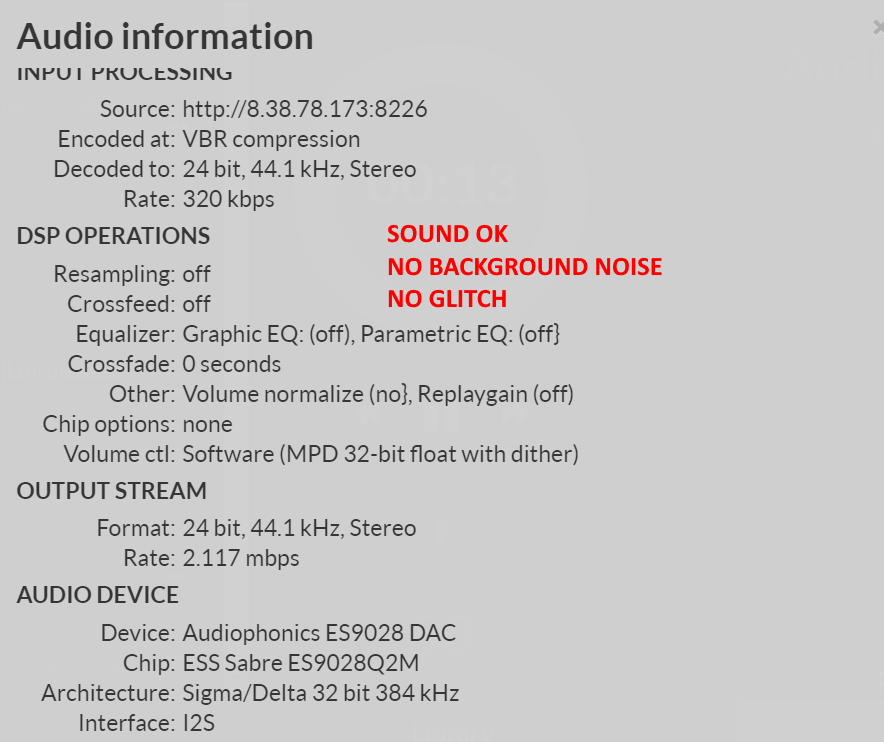

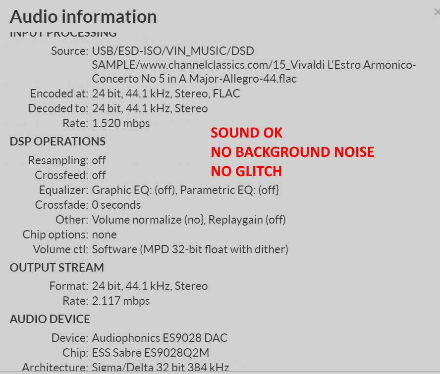

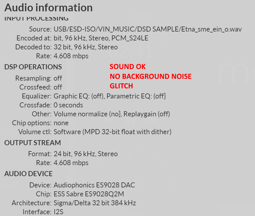

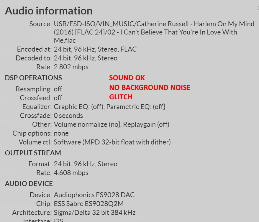

Hi TIM,
thank you for you work.
I have purchased a dac board based on Sabre ES9038.
The dac board is connected to the raspberry PI 3 GPIO (i2S).
I tried various settings (Audiophonics ES9018, Audiophonics ES9028, Generic-1 I2S, Generic-2 I2S, Buffalo, HiFiBerry DAC+) but I always have the same behavior.
If I play files with output rate less than 4,000mbps, playback is perfect.
If I play files with speeds greather than 4,000mbps, playback is affected of glitch or backgroud noise.
can you help me?
What format are the audio files?
I don't understand 4,000mbps rate
-Tim
TIM, I have attached the screenshots of the various audio files with specified how it is reproduced.
For "rate" I wanted to say "output stream rate"
I hope everything is clear.
Thanks in advantage.
Garluk
