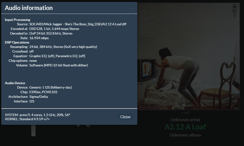

many thx again->here Beta9->for info:
with Generic 2 I2S-Hifiberry-DAC and chinese ES9028Q2M-board-> Dop-possible ! 🙂 but u have to check "Dop=yes" and Sox resampling "enabled"; no native DSD here on a RPI3+these board+ these dtoverlay and settings..
This is a question for "chinese ES9028Q2M-board" manufacturer.
Do they make a device driver for their device that supports DoP over I2S?
-Tim

I got the impression that he meant it is possible. Could someone enlighten me please? What is DoP?
In South Africa dop is a collective Afrikaans slang word for alcoholic beverages and is also a slang verb for drinking those so I can relate to that but somehow suspect we are not talking about the same thing. Although one need not only drink coffee whilst waiting for the make command to complete. Running the make command on multiple cores seriously cuts into that time though so you need to drink quickly or run it on an older RPI. :drink: 😉 😉
Yes..I only meant that is possible/got it here to work..it was not a "request" or something..and i do not know if they made a device driver, these "es-sabre-libs" are not "open" as far as what i´ve heard/read..
but anyway, absolute nice, so many thx again !! 🙂

DSD over PCM: a way of smuggling DSD data in a PCM stream to a compatible DAC if the output chain doesn't support native DSD. What is DoP (DSD over PCM)? | dCS
