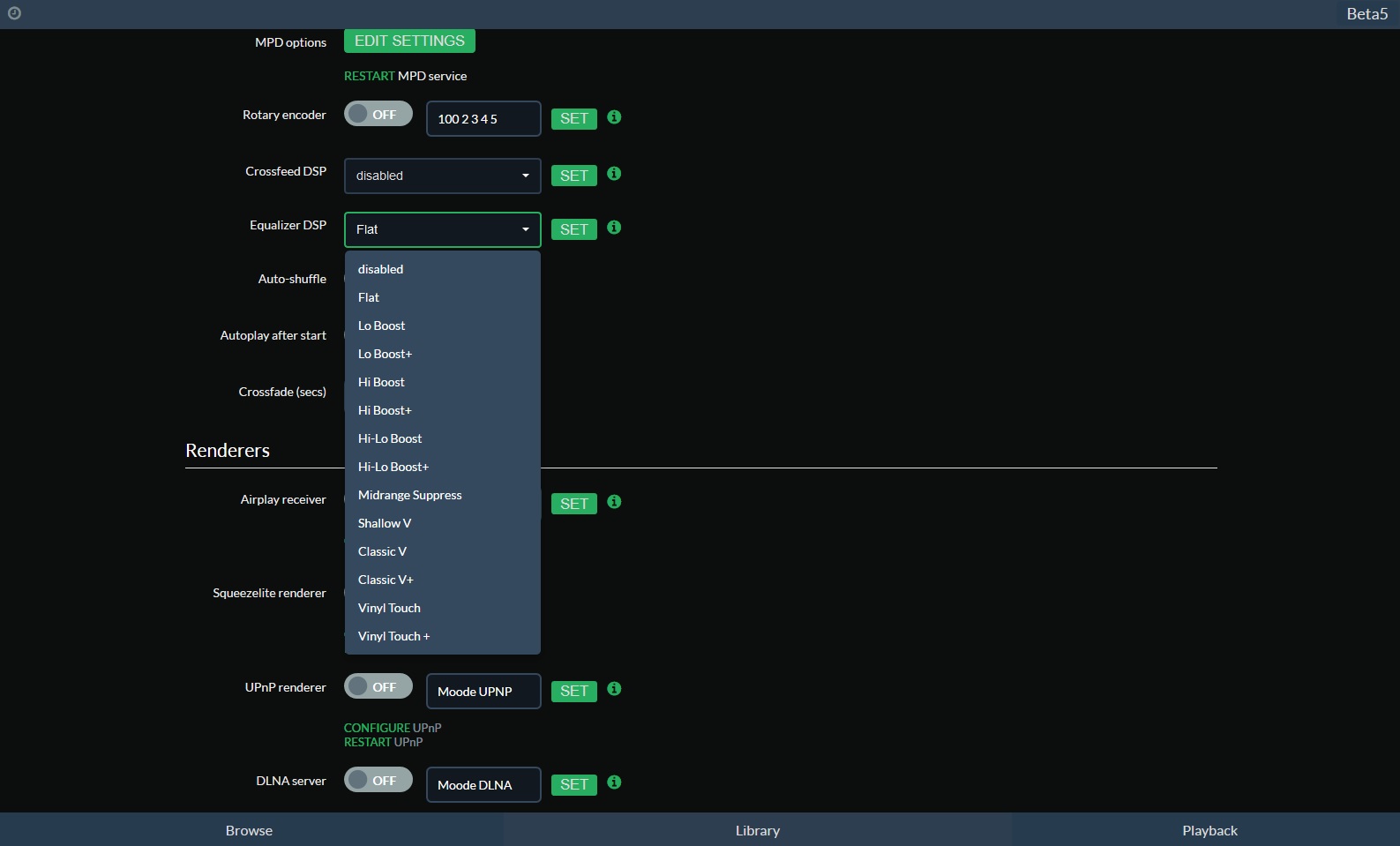

Hi @sinski,
Update row
sqlite3 /var/local/www/db/moode-sqlite3.db "update cfg_eq set curve='54,67,68,67,66,66,66,60,54,72' where id='12'"
Add row
sqlite3 /var/local/www/db/moode-sqlite3.db "insert into cfg_eq values ('13','Vinyl Touch+','44,68,72,68,66,66,66,53,44,72')"
Delete row
sqlite3 /var/local/www/db/moode-sqlite3.db "delete from cfg_eq where id='13'"
Print rows
sqlite3 /var/local/www/db/moode-sqlite3.db "select id,name,curve from cfg_eq"
When you paste the cmds just watch for the quotes being changed to back-quotes (the slanted quotes). This will cause the cmds to fail.
-Tim
