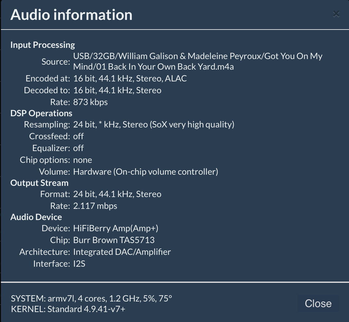

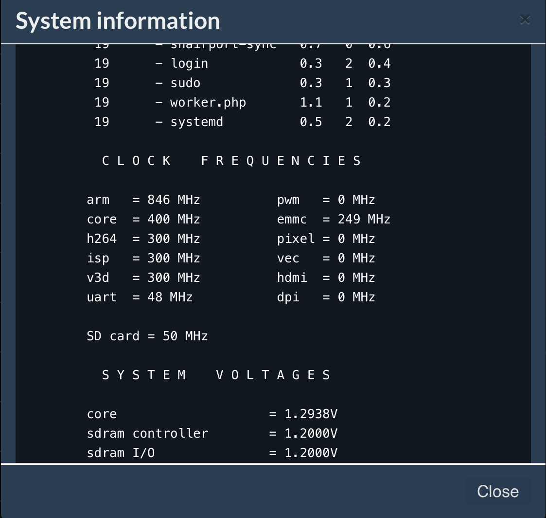

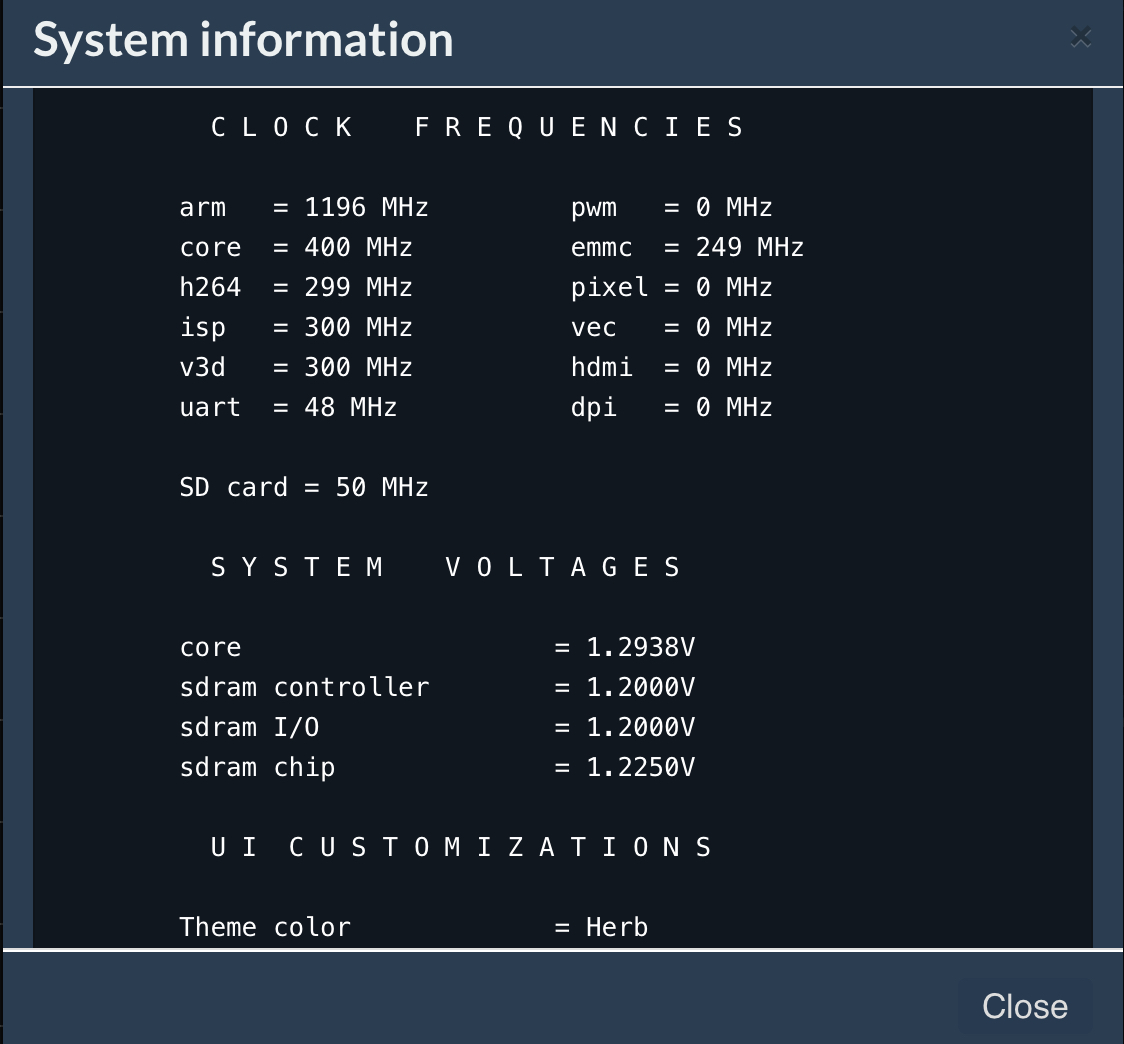

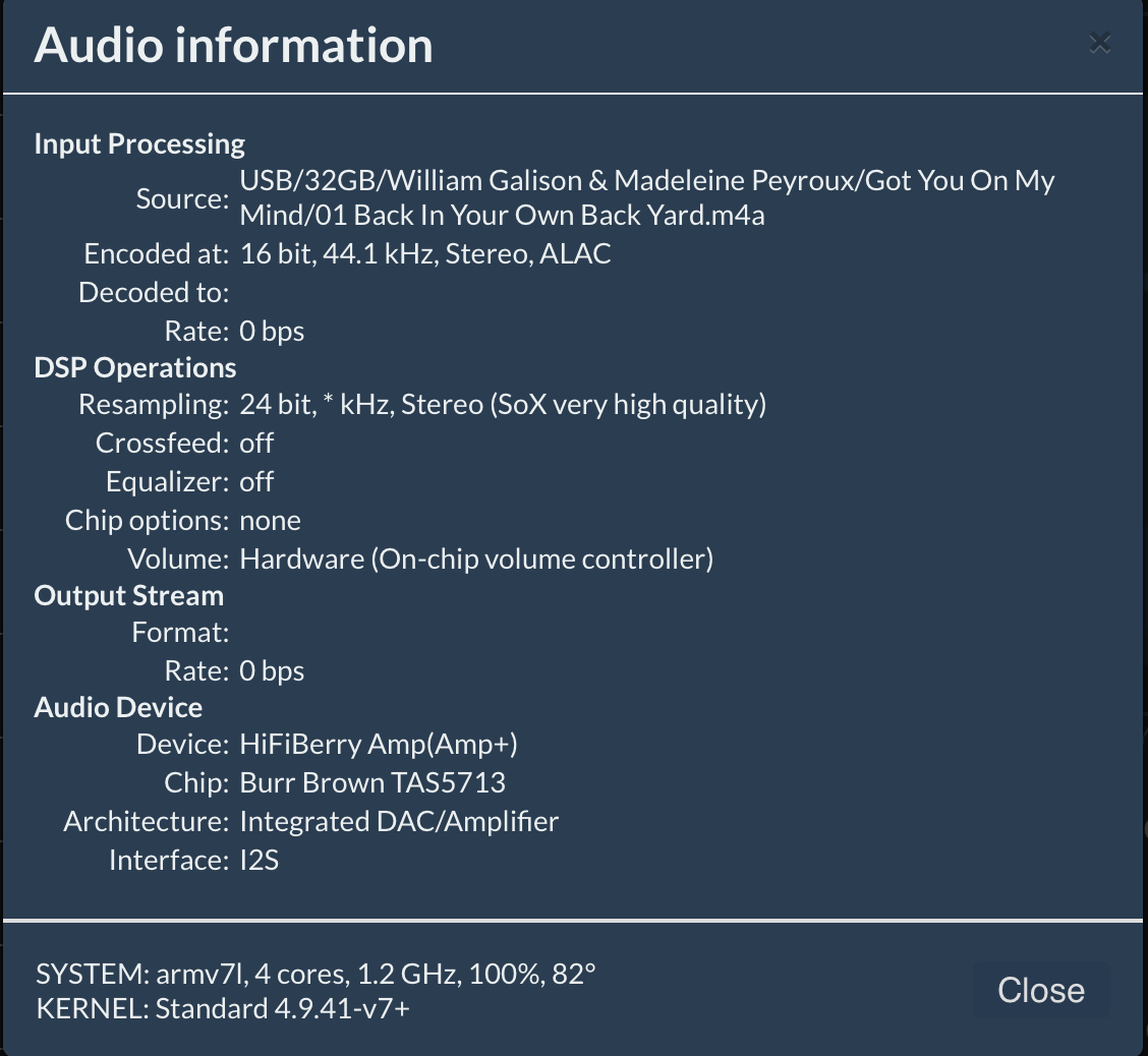

Further...
After installing sysbench and running all four cores at 100% for ten minutes, in a case, my temp never got over 84C
sudo apt-get install -y sysbench
sysbench --num-threads=4 --max-requests=99999999 --test=cpu run
Nothing moode does will drive the Pi this hard.
Here are before and during stress-test frequencies and temps: as you can see the Pi manages the frequency to keep temps manageable. As a reference, the foundation stress-tests the Pi3 at 120C (in an oven - you can’t get that temp by running it, except in a sealed box)
