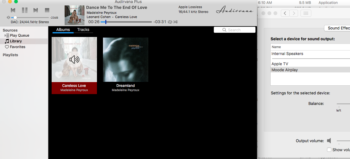

Is somebody using Audirvana in combination with High Sierra (both Mac related) and streaming to Moodeaudio using Airplay?
Audirvana keeps quitting all the time when connecting to Airplay by Moodeaudio.
With Sierra this wasn't the case...
The destination of your airplay stream causing an OS X app to crash is indicative of it being the app at fault.
That you said 'this wasn't the case' with Sierra - can we assume you recently upgraded?
Delete and reinstall Audirvana - I downloaded the trial version on my mid-2013 MacBook running the most up to date version of High Sierra and it worked fine.
I do have to wonder why you would buy such an expensive music player only to have it play at 44/16, though. iTunes can do that for free.
I also think it's Audirvana. Reinstalling doesn't solve the problem. Audirvana works but not connecting to Airplay (then it crashes)...
About iTunes: it still can't play Flac files (and no I don't want to convert the Flac files into Alac...)
It works for me.
And playing FLAC in iTunes is a thing: Fluke For Mac

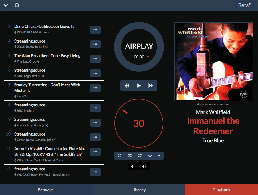

Listening to Madeline Peyroux streaming via Airplay while concurrently pushing 5GB of new music to my USB flash drive on my Wifi connected Pi3 at about 80MB/s on Moode 4B5
I really like this new version, Tim.
Don't let anyone tell you the wifi adapter in the Pi3 isn't up to the task.
If wireless streaming or pulling from NAS doesn't work for you, it's more than likely your network, not the Pi or Moode,
For those waiting for ver4.0, it's worth it. For you windows folks, it's worth it just for the built-in SSH browser!
Very slick on a Pi3, fast, flawless (so far), and sounds great to my machinery-and-motorcycle-inflected ears, even on my yucky Hifiberry Amp+
